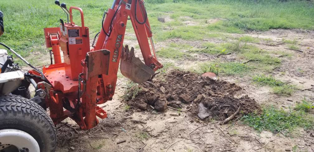

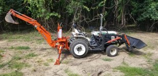

I picked up a backhoe on CL and added it to my H1502. I'll be adding a separate flip seat later today. Next week, I prime and paint the 4 point subframe and mount. 20180814_154514.jpeg20180814_174808.jpeg20180814_155141.jpeg

Looking good James.
Where did you find it? Did you have to do much modifying?
   / Kubota BT600 on Bolens H1502
I found it on craigslist. It had only been up 3 hours when I jumped on it. No mods to the the backhoe but I had to add to my loader subframe. I used only steel that I picked up free in my travels. I will post pictures of the subframe in few weeks after when get time.
