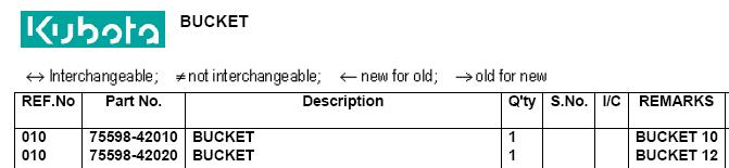

I have a BX24 with the BT600 hoe attached.
I am trying to find (a) which bucket I have and (b) if I have the 12" bucket where I can find a used 10" bucket (or smaller).
The part numbers show:
Bucket model 75598-42010 is a 10" bucket and the 75598-42010 is a 12" bucket.
Unfortunately, I can't find a number on the bucket and it measures 11" across the mouth so I am not sure which one I actually own.

Bruce, the BX25 uses two backhoe buckets, the BT2930 is an 8" bucket and the BT2931 is the 12" bucket.

If you have a BX24, it should have the BT601 BH. The BT600 was used on the BX22 and BX23.
   / Kubota BT600 Backhoe bucket size
Ah, I double checked and your are correct. I have the 601 hoe and the (BT2930) 8" bucket would work. GREAT!!!

If you're looking to see if parts from another generation of BX will interchange onto yours - check out the Kubota corporate site and go to the parts diagrams. They will typically list the Kubota part numbers for everything.
So you could find the Kubota "B" part number for the buckets listed for your tractor - and cross reference those to buckets listed for BX23 and BX25 - etc.
What you might find is that there's say a 10" bucket listed for the BX23 - but none listed for the BX24. But if you then look at the 12" bucket part number - they are the same for both.
What that likely means is that bucket attachment point dimensions are the same for both - but for some reason a 10" bucket is just not marketed for the BX24.
