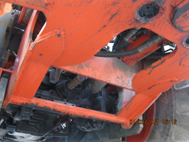

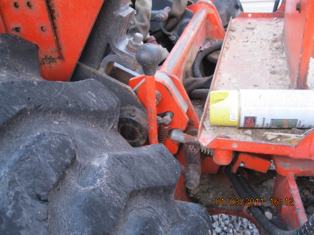

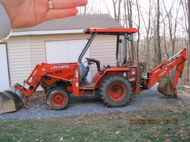

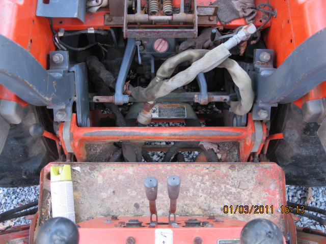

I have an opportunity to obtain the BH in these pictures (not able to get the tractor). How difficult will it be to adapt it to a 2008 JD 4320?

You have the weight, horsepower and flow necessary to run the hoe. Precisely manufacturing the mount brackets and attaching them to the frame of your JD is the part that would worry me. Also the L35s seat spins around to use the hoe, you would want to make your JD seat spin.
If your custom mount brackets failed while the hoe was under stress the results could be disasterous.
Personally I would look for a JD hoe.
   / Kubota BH on JD 4320 #3
How much is it? Anything is possible, not everything is feasible...
Thanks Bruce. I totally missed the point about the seat. I'll probably pass on this and keep looking. Seat and mount mods could end of costing more than the hoe.
