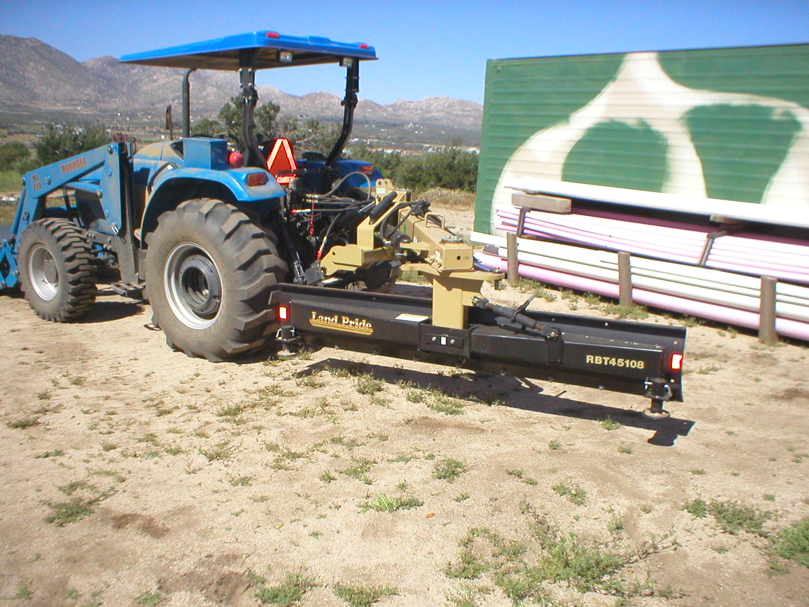

I personally went with hydraulic offset and angle. The tilt of the T&T pretty much takes care of the tilt on the blade. Only reason to go steeper than what the 3pt can do is if you are water ditching for irrigation and then you would just manually set the blade tilt and fine tune with the 3pt.
One other thing, spend the few hundred $$$ and get the Draft Control for the hitch. If you learn how and where to use it, it will be some of the best $$$ you ever spent. ;)
