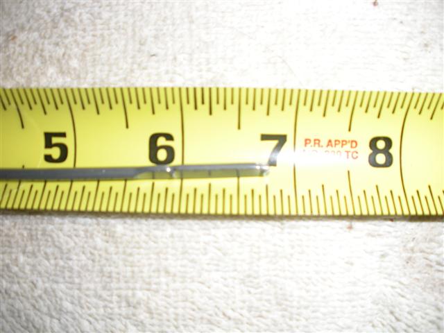

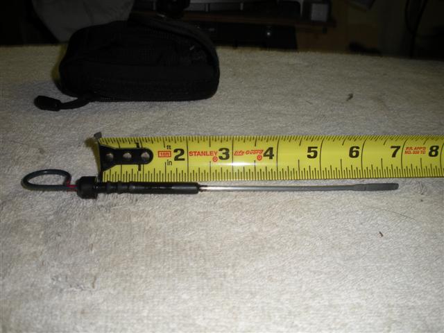

I am hoping someone can tell me the length of the trans dipstick on a B8200 non Hydro trans. I just drained my UTF and the dip stick under the seat is apparently broken. Its got no fluid level markings as the service manual states. Looks like it was snapped off at some time. Thanks.

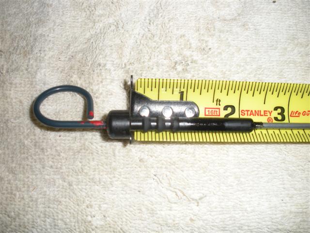

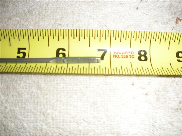

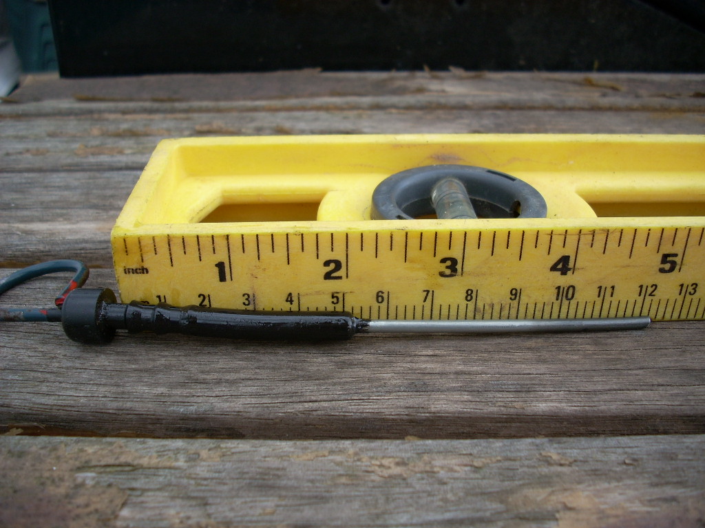

Thanks for the reply. Do you remember how long it is. I know that the system may be different but maybe its not short and only missing the markings. Thanks

   / Kubota B8200 Trans help #4
Looks like it broke off right where the dipstick is flattened and has the two marks.
Hey Robert! I cant thank you enough. Ive got everything ready for the refill in the morning and ill be getting back to chores thanks to your help. I was going to remove my york rake and put it on my old Cub loboy. I wasnt paying that rediculous shipping.Ill get one in the future with a bigger order. Now i wonder where the rest of that dip stick is.LOL. Thanks
   / Kubota B8200 Trans help #6
I have a B8200 with a gear tranny, and Robert's fotos look right... I am travelling, but when I get home, I can double check my dipstick and post another reply. If I remember correctly, there are hi/low marks about 3/4" apart?
