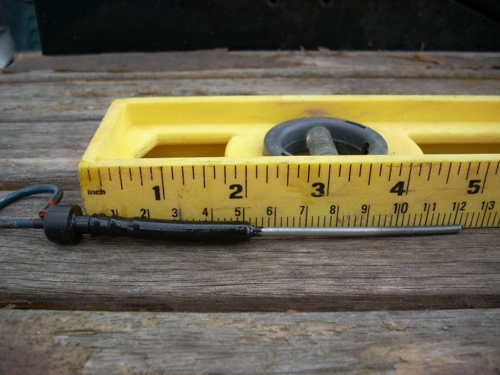

Im hearing a buzzing sound from the hydraulic system and the 3pt is shuttering. Hopefully its not the pump going. There is a dip stick next to the shifter. Its the trans/hydr resivour. The dip stick is pretty short and its got no markings. The manual said check it has two lines like a car. Does anyone know how long its supposed to be? Thanks. BTW. I stripped the bolt that hold the trans screen.It feels like its welded on. Thats another issue.

This is what it looks like.

I got the measurement from Robert. 6" down from the top of the casting.
   / Kubota b8200 trans dip stick #6
when mu B8200 Hydraulics start to wine and the 3 pt shudders I take out the hydro filter and clean it with brake clean, blow it out and put it back in. problem solved.
