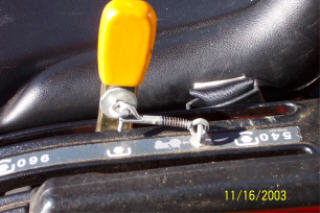

I was constantly catching my jacket on the PTO shift lever. The grinding was driving me nuts. So here is a latch idea to secure it. Latch is available at your local hardware store.

   / Kubota B7500 PTO Shift Securer #2
I have a customer with at the time a new B-series and every member knocked it out of four wheel drive. Took four calls and trips in a little more then a week before I put a rubber bungee cord on it for them! Been probably six years plus now since the last call, I haven't seen one totally perfect yet for everyone.

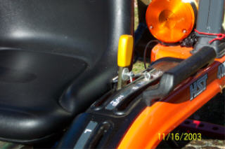

Here is picture #2

   / Kubota B7500 PTO Shift Securer #4
are u saying that catching your jacket on the pto lever is moving it? and trying to engage pto?
the answer is yes. getting off the tractor on the left side my jacket and my wife's would sometimes catch on lever and gind the gears by pulling the lever forward
