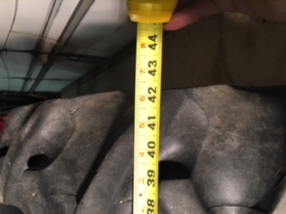

Hi All,
I'm new here and have a question regarding my Kubota B7500. I just took delivery this week and already move the rear wheels into there narrowest position along the axle shaft. My pin and axle tightening thingy ma jig is located on the inside of the wheel. I've seen a video showing this stuff located on the outside of the wheel. My question is this, is it possible to swap the wheels left to right so the pin and axle tightener are on the outside of the wheel hub which should tuck my tires in even closer for a narrower width? I am trying to reduce the width as much as possible for when I run my tiller behind the tractor. My tiller is around 42" wide and my rear wheel width is approx 46" wide with AG tires.
Thanks all

jayyohe, Which AG tires do you have? My Operator's Manual shows different wheel spacing arrangements for the 8-16 and 8.3-16 Farm tires on the B7500DTN, and for the 9.5-16 Farm tire on the B7500. Assuming you have the 9.5-16 tires, the center line of tire spacing can be 32.9"' 34.9" or 39.6". The narrower spacings are with the wheel hub on the outside of the wheel disk. The wider spacing is with the hub on the inside of the wheel. The wider setting is obtained by, "Remove the wheel hub and reinstall it on the other side of the wheel disk, then set the wheel as shown." (Figure F-8441).
I don't know why you could not just turn each rear wheel around on its own axle. Perhaps, others can comment on that idea.

Thanks for the replay Rusty. I'm not sure which tires I have. I'll have to check on that. I was thinking if I move the tires left to right and right to left, placing the hub on the outside, it will not effect the tread pattern. If I turn each wheel around on its own axle, I was thinking the tread pattern will be wrong. Only hicup I see with my idea is the valve stem will be located on the inside of the wheel which IMO is not a big deal.

Good grief...I just finished removing each wheel and relocating the hubs to the outside of the wheel. This kept my valve stems on the outside of the wheel as well. After reinstalling, I lost a good 4" of width which put my wheel spacing right around 42" which should be perfect for running my tiller. I torqued all nuts to 100ftlb. I've read that tractor tires can be filled with liquid calcium or something like that for weight. Mine are definitely filled with something. I could hear it swishing around in there and they darn things got to weigh at least 150 lbs each. Getting them back on by myself took a bit of finessing but I was able to roll the tires up on a 2x4 and then used my jack to raise the tractor up or down to line the hub up with the axle. Only smashed one finger and I don't think it's broken so I guess I made out okay. Appreciate the insight. Now I am going to post another question on a new thread concerning getting hydraulics to the rear of the machine so I can run a 3 point log splitter.
I don't know why the frig my pictures get all screwed up when I attached them.....SORRY Seems that if you click on each picture to make it bigger, they show up the correct way.

Congratulations!!! Do you still have enough spread (width) in your 3-point lower arms to connect to your tiller, without hitting your tires?
