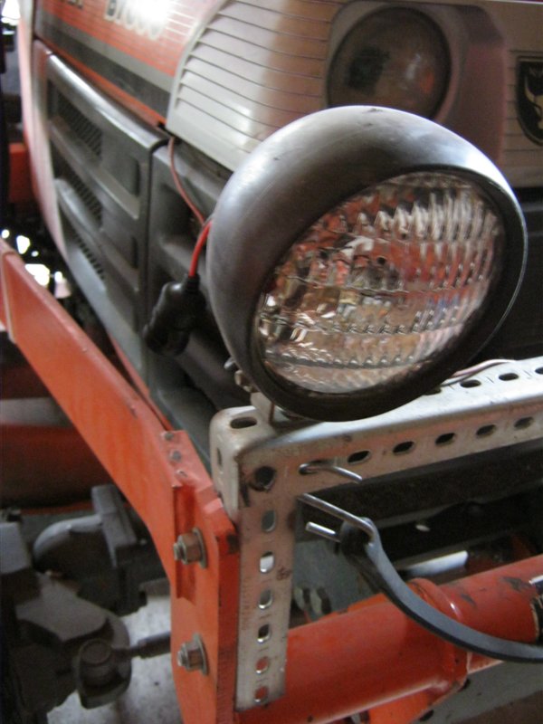

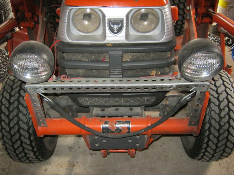

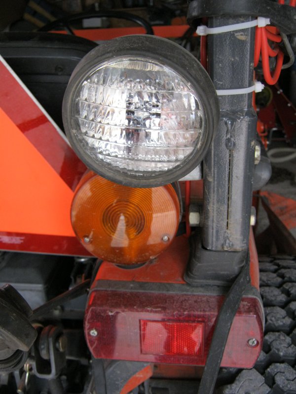

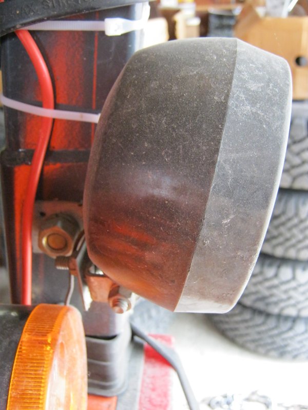

I have a B7300 and found that the headlamps were both cheap and inefficient....I purchased these lights from NorthernTool[]Northern Industrial Tractor Implement Light 12 Volt | Automotive Work Lights | Northern Tool + Equipment, added a cross bar across where the grill guard would normally mount, and attached lights there...also added one to the rear attached to the fused utility light wire there and added an in-line switch. Some have commented on B7300 "generator" not being able to handle larger lights. I have had zero problems since I did this back in 2002. Just jumped wires for original lamps to the new ones and original light switch runs them. In pics you can see original K headlamps are dead (plastic sockets broke) so need for real lamps.
