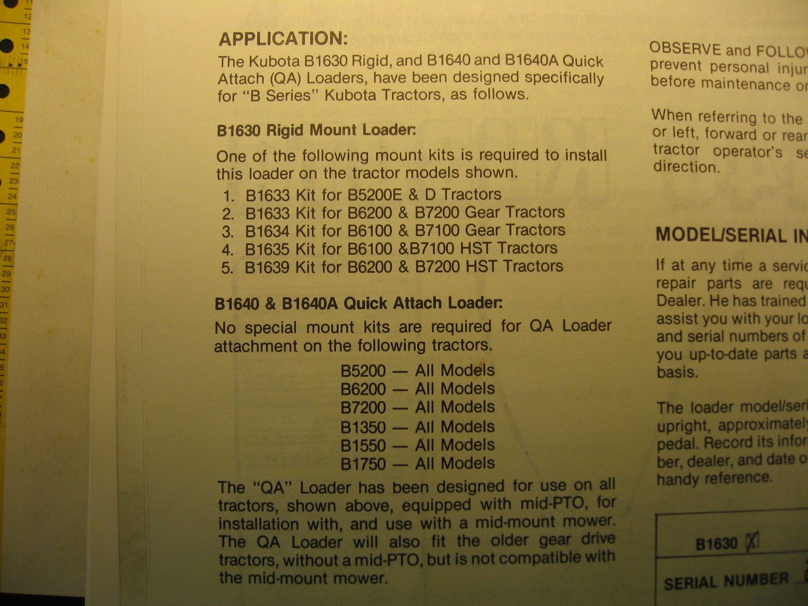

I have an older (late 70's I think) Kubota B7100 with a manual transmission. I have found a great deal on a 1640a loader that was on a B6100 manual transmission.
Does anyone know if this loader will fit on my tractor?

This photo is from the manual of a 1640 loader. If you can't read it I can email you a better photo.

I have 1 of each tractor a B6100 and a B7100. The B6100 is here in Florida but the B7100 is in Georgia. I believe they are exactly the same frame with a different motor. Both are manual transmission. Only the B7100 has a loader.
