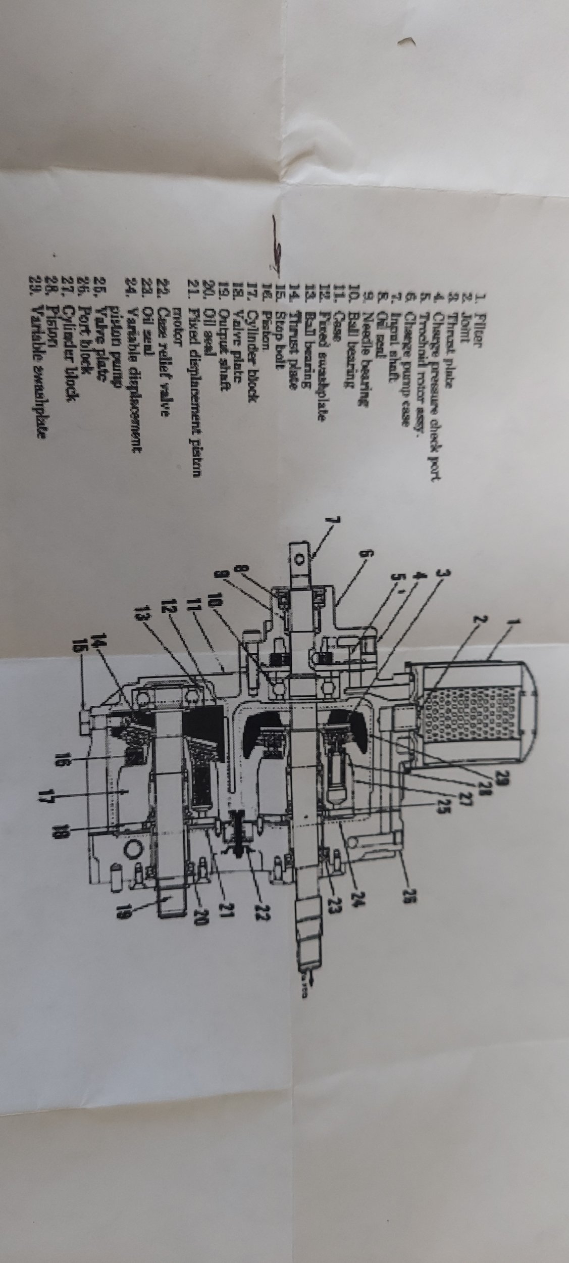

So I bought an old B7100, wanted to flush all the fluids. Removed what I thought was a drain plug and it was actually a stop plug for the hydraulic control valve pump and then the bolt (plug) won't go back in. Something is preventing it from threading in. I tried forcing it and now the threads are stripped in the aluminum. I can't be the first idiot to do this as it looks exactly like a drain plug as it's directly below the oil filter on the pump. So, now what? How do I move the piston out of the way so I can re-tap a larger bolt with a ground down shoulder to put back in there. I've attached a picture from the parts manual to show number 15 is what I'm talking about. Anybody want to help this idiot understand what's going on inside that hole and tell me how to fix my mess?

Judging by the parts break down that bolt holds the thrust plate that the piston slippers ride on. There a spring load on that plate so it could possibly have slipped out of position.
I would be very cautious trying to machine that since chips are potentially going to get into the rotating group ( piston assembly) and destroy your HST transmission.
might have to dismantle that portion of the HST transmission to perform the repair

Anyways, back to the topic, I'm with oldnslo. That bolt held the motor swash plate in place and things maybe have moved inside and now requires further disassembly of the HST unit to repair. Which might not be that bad as you still needed to take most of it apart to repair the threads.

This looks to be some type of stop or pressure port for the wobble plate style of pump. Have to tried turning the engine to reinstall the plug?
   / Kubota B7100 HST transmission woes #10
Might try having a helper move the hydrostat treadle (speed adjustment) gently when trying to screw the "bolt" in. That might let it in but doesn't fix the thread problem.
A thought for fixing the stripped threads might be a spiral fluted tap which pulls the shavings out of the hole but still run the risk of contamination.
Gravity would be in your favor, however.
Hate to ask but would some JBWeld or equivalent on the threads fix the problem "permanently"?
