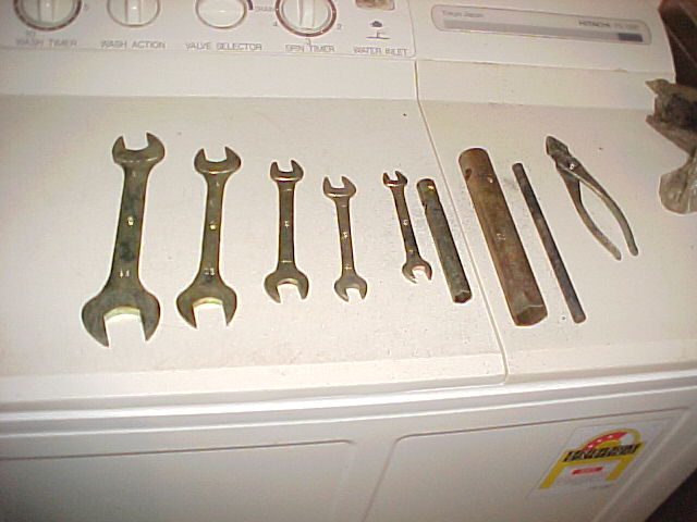

Apologies to BandDcabinet, I had only to step out to the workshop.
After a s/h B6100 and two s/h B5100's, finally got a toolkit with the third B5100.
The open enders are 26/21mm, 22/19, 17/14, 14/12 and 12/10mm.
Box spanners are 22 & 12mm (only one end on each).
