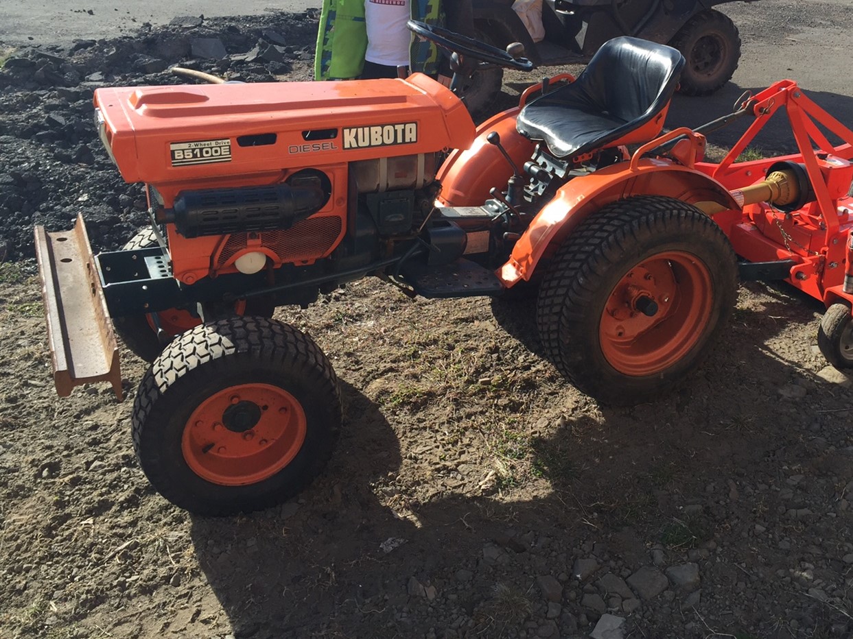

no fel or bucket, just new rear Kioti finish mower. I zoomed in on pic , its actually a B5100E, not 6100. only 12 hp.......;little smaller than i thought.

Check your local Craigslist and machine sale websites. 2400 sounds like a lot for what you'd be getting. I recently checked out a dealer in Ontario that was selling an Alis 165 for the same price(Just looked and it apparently sold). The B5100E can only lift 300lbs at the three point. That seems light, and would size you out of most implements, as would the 10 PTO HP.
It's a really beautiful tiny tractor and I can see the appeal...super cute. But really I am afraid it is just too small for anything more than the very lightest jobs like mowing and such. Check the size of the 3 pt arms, with only a few hundred pounds lift the three point might be the garden tractor category 0 instead of the more standard category I typical of small tractors. If so, that would really restrict the kind of implements for it. Even if it does turn out to be category I size, keep in mind that most most category I implements weight several hundred pounds bare. That doesn't leave anything extra for when you hit a tough spot plowing or blading.
I'm not just guessing here. 40 years ago we did all our work on our first little farm with a 16 hp Yanmar that was also too small. But it was way more heavily built than a 5100 (or 6100) and had some things the 5100 did not. Such as 4wd, 6 speeds forward, much larger frame and axles, tires with chains, a decent loader that would lift 500+ lbs, and a real Cat I 3 pt that would lift 600+ lbs. It was still too small, but could be made to do some work.
Now an older Kubota 7100 with the original loader would really do you up right. They were popular for good reason.
But that 5100 is sure way cute...
