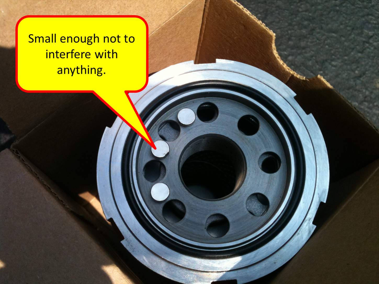

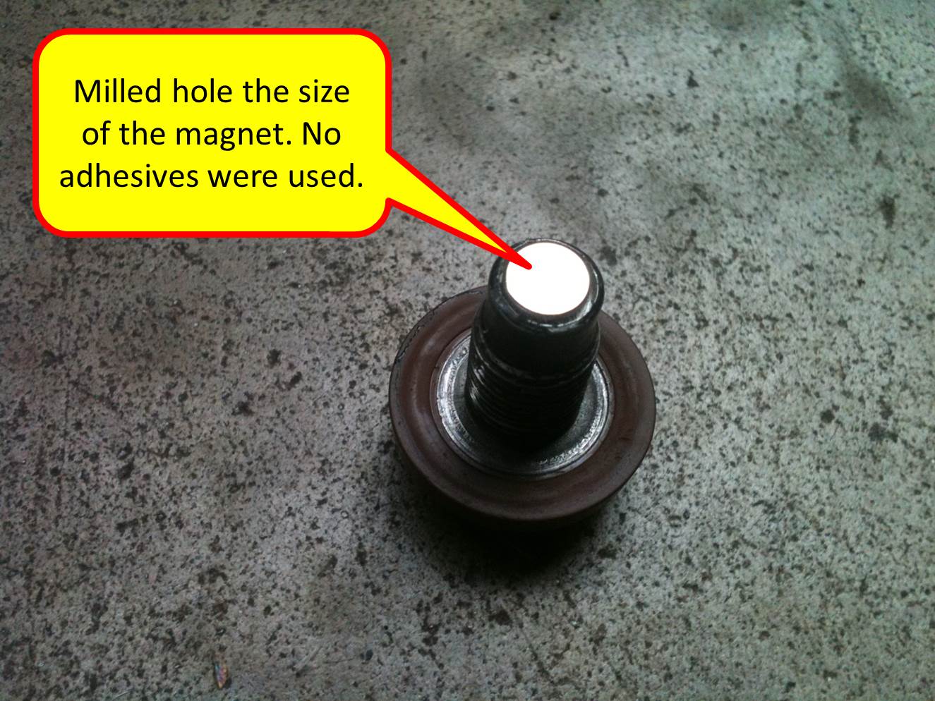

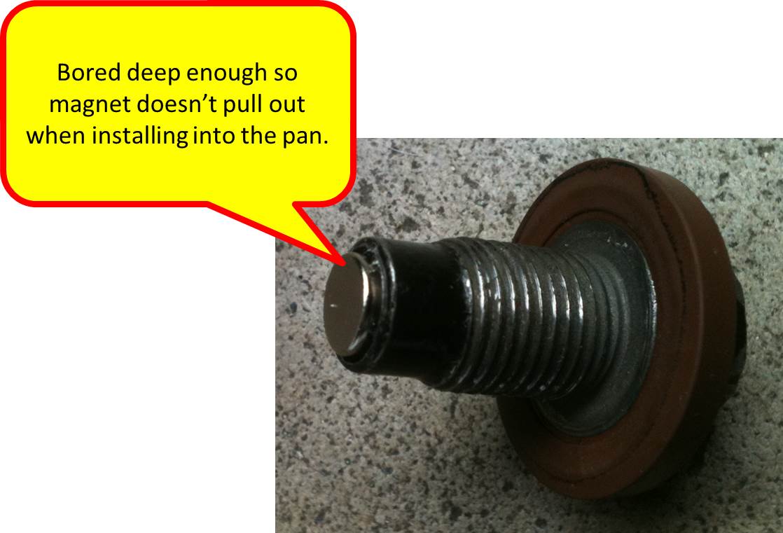

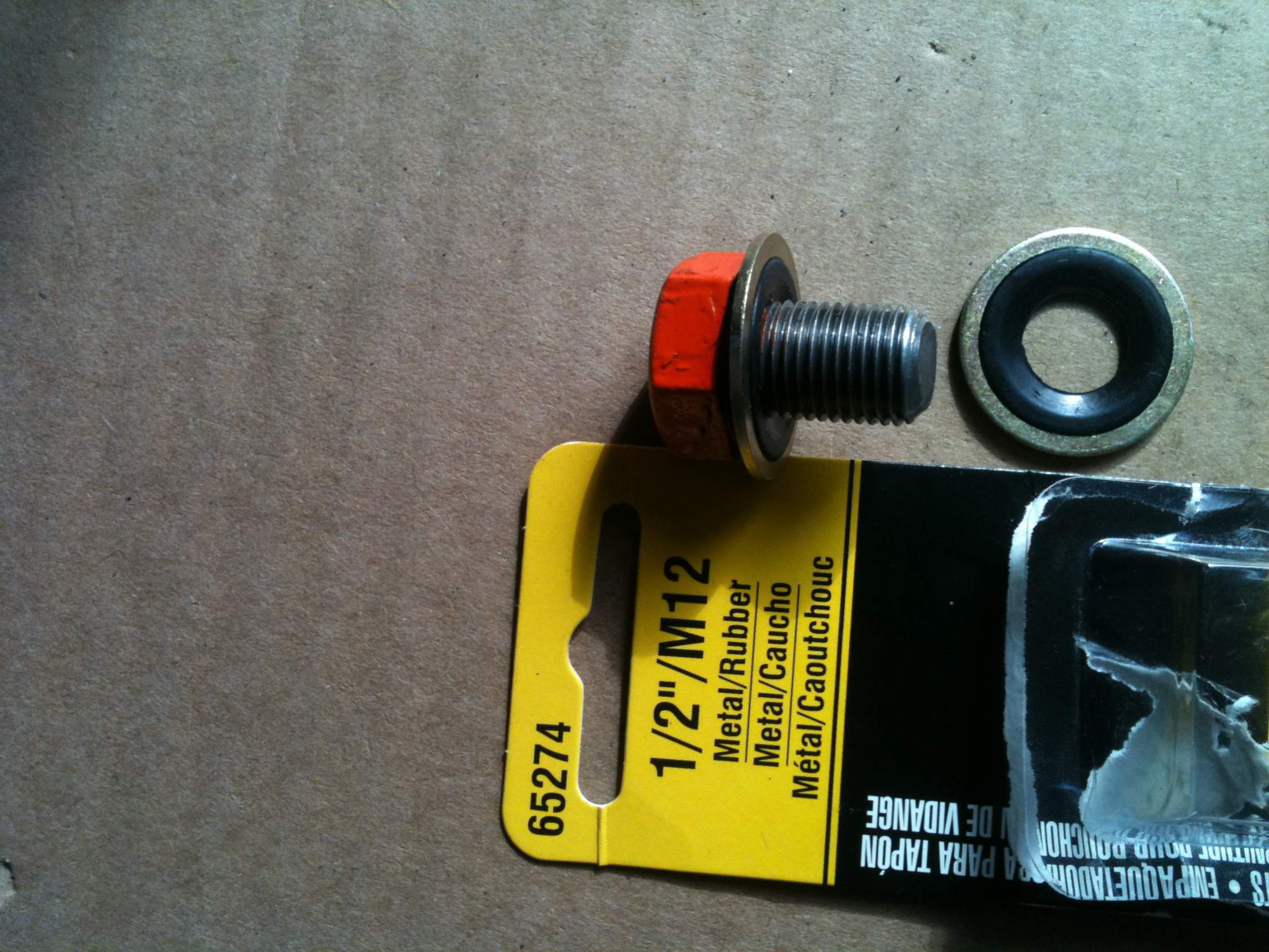

Kozman,
Besides the normal items here are a few items I did to mine while servicing it for the first time.
1. Painted all the drain plugs using Kubota orange paint to make them easier to see.
2. Added "rare earth" (neodymium) magnets to the all the drain plugs. Rare earth magnets are much stronger than then conventional household magnets. Plus they don't lose as much holding strength with temperature.
3. Added "rare earth magnets to the various filters.
4. Changed the drain plug gaskets to ones with encapsulated O-rings. Any automotive store will have these.
Sorry I don't have a picture of the painted drain plugs...
Example of magnets in the filter
O-Ring style drain plug washer
Thanks for the info. I'm new at this so what are the magnets for anyway?
