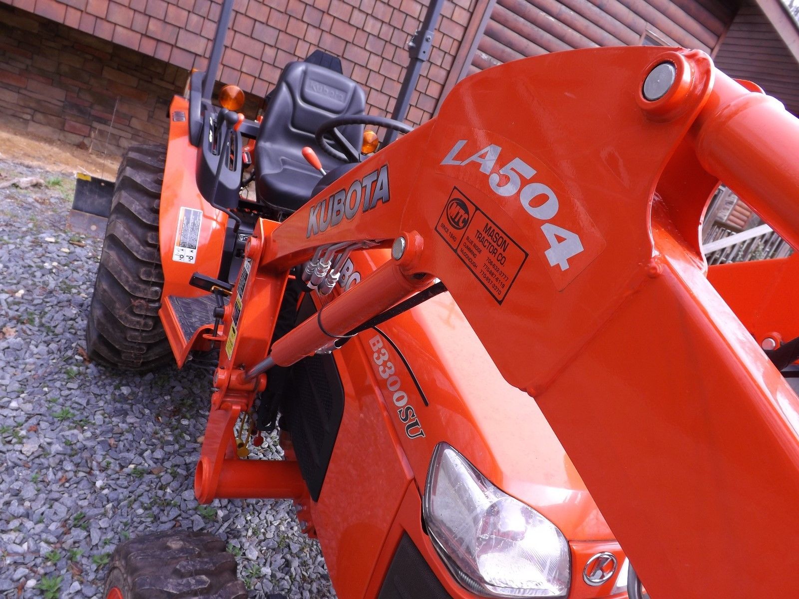

I've got a B3300 with L504 SSQA from Kubota. So they will have a SSQA that fits your loader for sure.
I also added the WR Long 3rd function valve and EA 50" Wicked Grapple. Awesome and capable combination! The SSQA is invaluable in attachment change (grapple to bucket to forks etc).

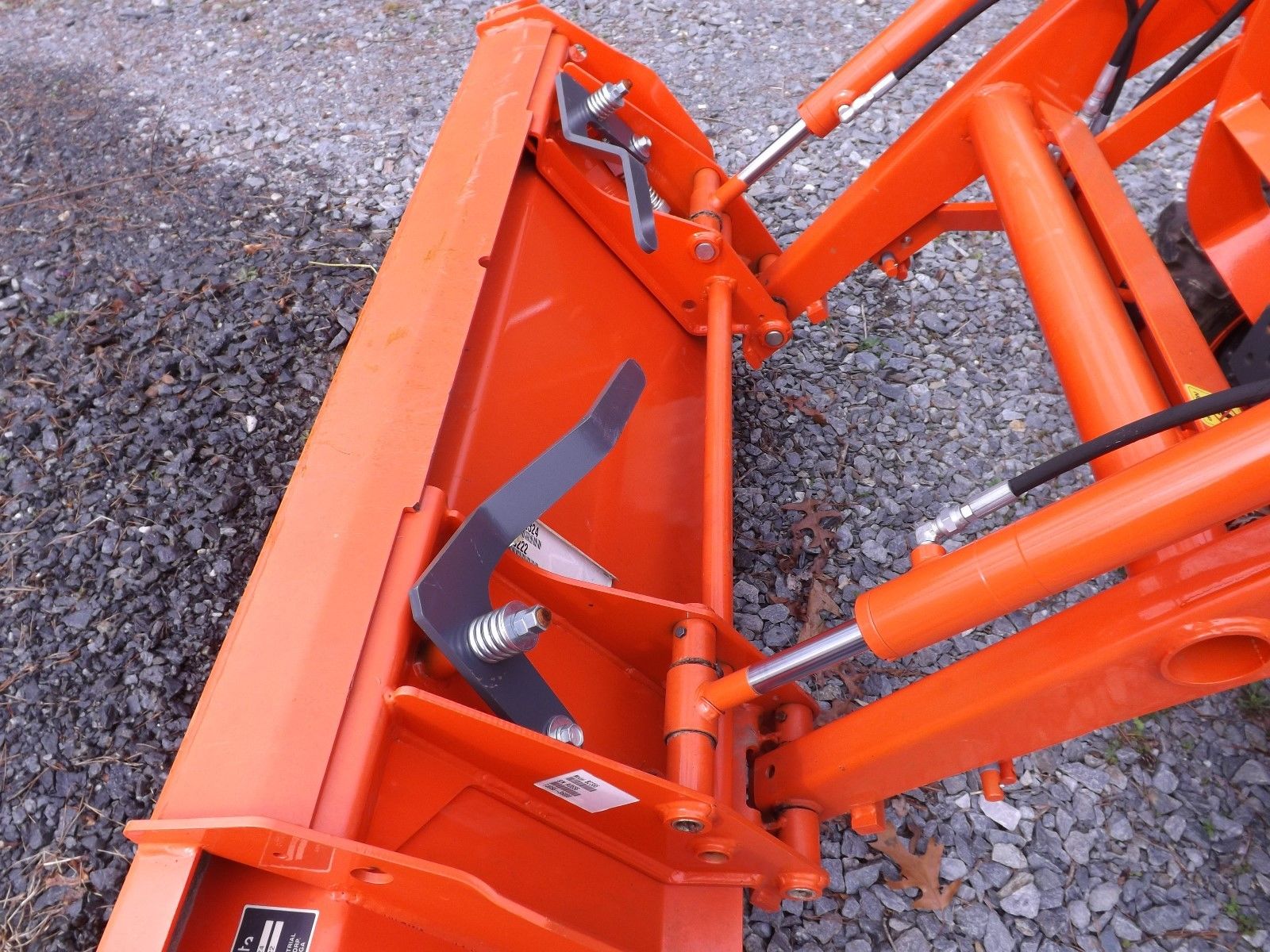

You'll be very happy if you are able to make it work. But regardless, press Kubota because they have the solution. I ordered by machine with the SSQA included and it wasn't a big deal for them at all. Here's a 1 minute walkaround showing the setup. https://www.youtube.com/watch?v=7yd9d8Ywusw
   / Kubota B3200 / LA504 FEL SSQA/Grapple Question #6
I made a call, but couldn't come up with an answer. I do know that the pin spacing of the 504 is the same as the 304 and 364 though.
I'm sure someone here will measure for you. If they have a SSQA, they can just measure where the quick attach pins onto the loader.

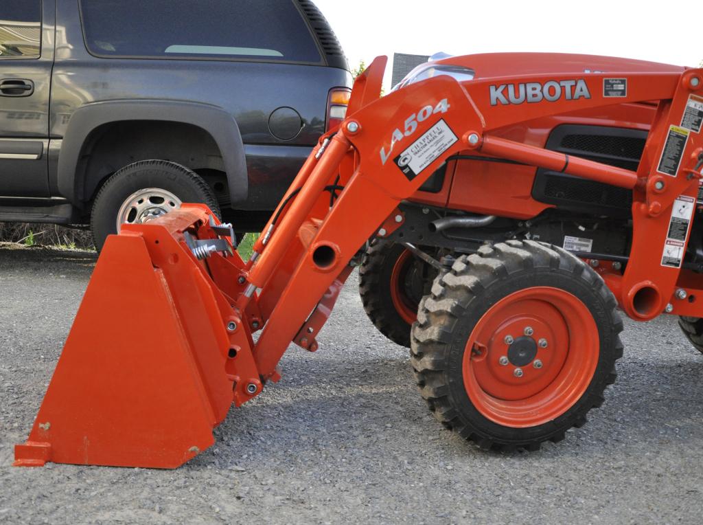

From a google image search:
I've also sold hooks to quite a few guys with that setup ;)
Here is a older ebay listing showing one: http://www.ebay.com/itm/2013-Kubota...D&orig_cvip=true&rt=nc&_trksid=p2047675.l2557

I called and talked to a salesman at Messick's today and he crossed the pin-on bucket part numbers for the 504 and 534 and told me they were the same. :cool2:
It sounds like I have a SSQA solution. :D
He also told me a SSQA bucket would be $660......so it looks like I'll be pinning on a bucket for a little bit. In the mean time I'll do some research on mod'ing my existing bucket to SSQA.
