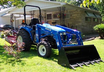

Well, I don't know about the other two, but I can tell you about the TC29D. Also I will do my very best not to go on a rant about how awesome the tractor is... but it's hard not to. It is the best investment I have made EVER! Ok, as far as mowing your lawn. I chose to NOT have my tires loaded for that particular reason. And, I chose the R4 tires (Industrial) so that they arent so radically agressive that they eat up my lawn. When I finally took delivery of my tractor, it came with a rotary cutter. I currently own a house just outside of town with a 1 acre lawn, and I also own a 50 acre plot of land out in the country that I just purchased that I will be building on next year. Well, I was so excited when my tractor arrived that I just had to try mowing with it. My lawn in town needed mowing bad, and although I knew I couldnt mow with the rotary cutter, I wanted to make a few passes with it anyways. Well, it had rained the day before so the ground was a little soft but not bad. I made about 10 passes with the rotary cutter, and NO ruts at all. I plan on mowing my lawn on my 50 acres next year with a finish mower so weight was important to me, and the TC29 was perfect.. Heavy enough to be stable with the FEL and to provide plenty of traction when needed, but light enough not to gouge a wet lawn. Sorry for such a long post but I thought you would want to know firsthand of an actual experience with it. One more thing, and I think everyone on TBN will agree.. if you do get a compact utility tractor, at all cost.... get a Loader and get HST!!! Those two options payed for themselves in the first WEEK!!!
Good luck..
Brad
