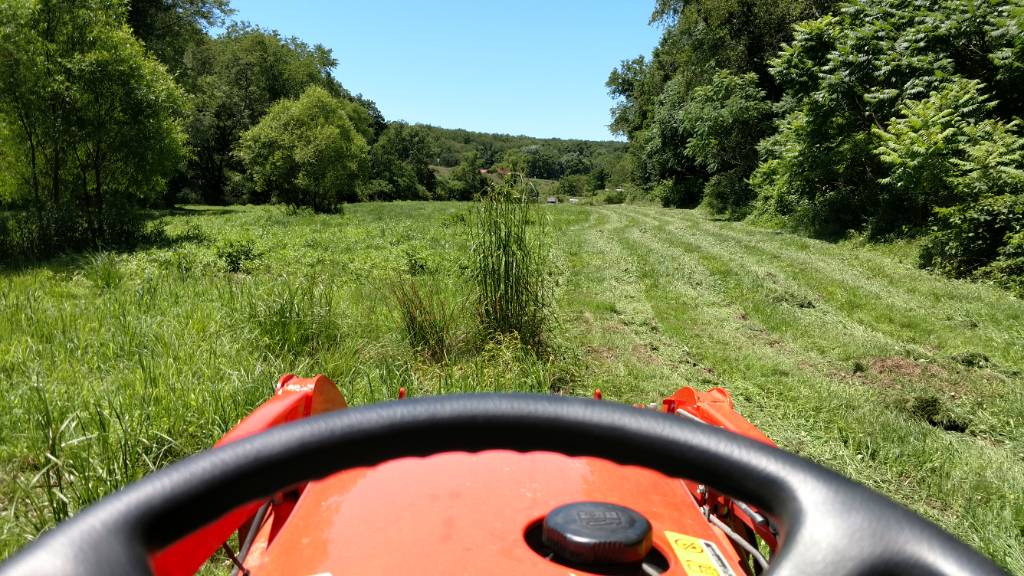

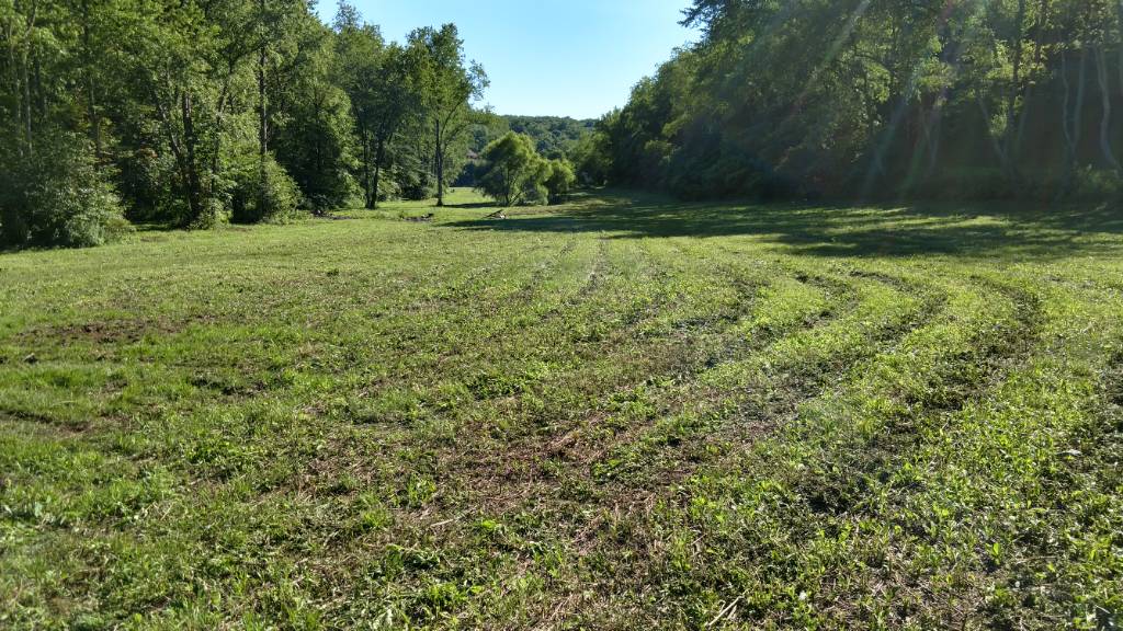

I mow my father in laws 4 acres every 4 weeks or so with my B2650 HST, and instead of trailering it 4 miles I just drive over and do the job, and drive back to my home after. It takes as long to load and unload from the trailer as it does to just hammer down in high range and drive there.
