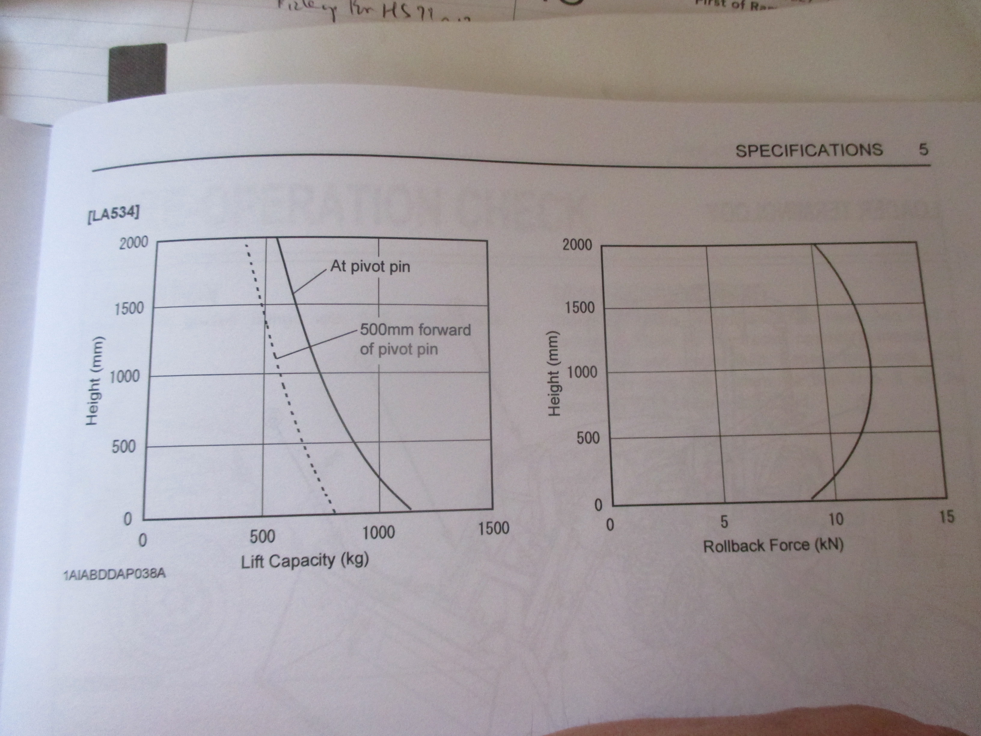

So far, I haven't been able to find complete specs for the loader...id like to know what the loader will lift at carrying height of around 1.5 meter, roughly at the 3 to 4 high stack level. Wondering about the loader lift curve and what the capacity would be at roughly this height.
The small squares weight on average 65 pounds each. The Kuhns compact grabber is about 340 pounds, dimensions of 36"x72".

I don't know if it will help, but the Kubota loader model number tells you how much it will lift in kilos. The LA534 lifts 534 kilos at the end of the arms without an attachment.
Actually, it's 530kg, and the "4" on the end is the revision of the loader.
Hopefully a B2650 owner can make a photo or scan of his loader curve from the owner's manual and post it here. That will give the best answer to the OP's question.

i will try an remember to get a pick when i get to the office where the owner's manual is

Hi Terry, that's exactly what I was looking for. Looks like the 534 will lift all that I need it to. From the curve, I see that the further out from the pins, the lift capacity decreases. The bale grabber I'm considering extends out 36 inches. Total weight with 4 hay bales would be approx 600 pounds. Based on your experience with the B2650, would you feel confident it would lift this bale grabber up to around 5 feet? That's plenty high enough.
