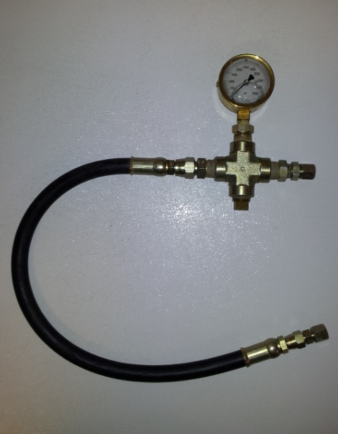

That B2150 is a terrific tractor. Mine has never ceased to amaze me in its durability and the amount of work it can do for its size. Hopefully your problem will be a blocked screen, but in my case, the same symptoms were the result of worn FEL hydraulic lift cylinder seals. Had them rebuilt years ago and no problems with the loader since. You can buy a 4000 or 5000 psi oil-filled pressure gauge for under $30 and make up a pigtail to check pressures on your own (see pic). I don't recall now what they should be. Your local Kubota dealer can look that up for you, or another TBN member may know. In fact, some of the hydraulics gurus on this board (e.g. J.J.) can likely step you through just how to isolate the problem. Good luck with this.

Well I did have a screen in the rear side of the tractor it was clogged. So I bought a new filter and I had the same problem. since then I took apart the lift control valve and rebuilt it. still it does not work. I will now try the pressure valve. Where do you place the pressure gage at the lift control valve?
   / Kubota b2150 #7
I have 2 of the B2150s and never a lift problem. One with 650 hrs, the other 470hrs. The gauge is a very good idea. In the B2150 you have a hydraulic junction body at your right foot. Just find the correct port and see what pressure you get. Ought to be in the 2500 psi range (though I have not looked that up, check websites.) Exact number matters little. If you have solid pressure at some level above 2000psi then the problem must be flow and that gets back to the filters and other things mentioned above.
How many hours ? Main concern would be the pump of course. Do you have a FEL or other hyd driven things that might vindicate the pump ? Solid pressure on your gauge should also vindicate the pump.
