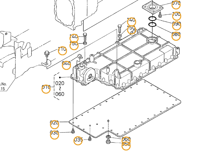

Hello, new guy here. Bought a B21 from a friend a few months back to help clear my dad's 5 acres of property, cars and business. Came with forks, a back hoe, bush hog and a box scrape. Dad passed in October and left a mess.
Quick question is - This thing leaks hydraulic fluid all over the shop. I removed the pan and found nothing but black RTV holding it together, no gasket. I get online and look, and sure enough, no gasket showing up in drawings. I'm really surprised b/c of how the tank is made with a groove all the way around on the inside of all the screws. Am I supposed to fill that groove with RTV (plus a little bit for spreading) and rock on? Previous installer had it slathered on waaay too much. I've been a Corvair guy going on 25 years now so I'm a decent mechanic. I avoid RTV at all costs if possible. I need this thing working and back moving cars, parts and trash!

You'd have to check the parts breakdown at kubotausa.com but it's quite possible there is no gasket. Much machinery uses none. The common replacement is the gray gasket making RTV - and don't overdo it. You can get the stuff at Auto Zone, O'Reilly's, or other parts places. I learned that while trying to reseal the Spicer - Dana transaxle on my garden tractor.
   / Kubota B21 Oil Tank Gasket - Does this exist?
I found this image on colemanequip.com. I'll find some gray and get on it.
Also, I did find one screw that was short (035) but wasn't in the location below. I'll correct that. That one may have been bottoming out below the filter.
Confirmed same diagram is on kubotausa, too. Thanks for confirmation.
