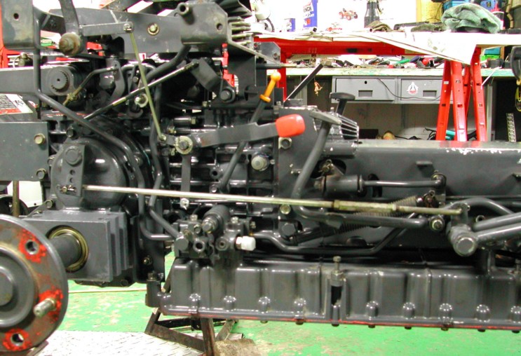

Hi everyone,
My Kubota B21 has been leaking hydraulic oil on top of the tank for a long time now. I did remove the tank and did not see anything suspicious. Its very hard to detect as the oil accumulates on top of the tank and eventually spills to the ground while working with the tractor.
If this is something you have dealt with before let me know what was the cause.
Thanks in advance!
Etienne

The B21 doesn't have a tank that I am aware of the oil goes in the top of the transmission. Then there is a hyd oil cooler at the radiator. Pictures would help.

Please see the pictures attached.

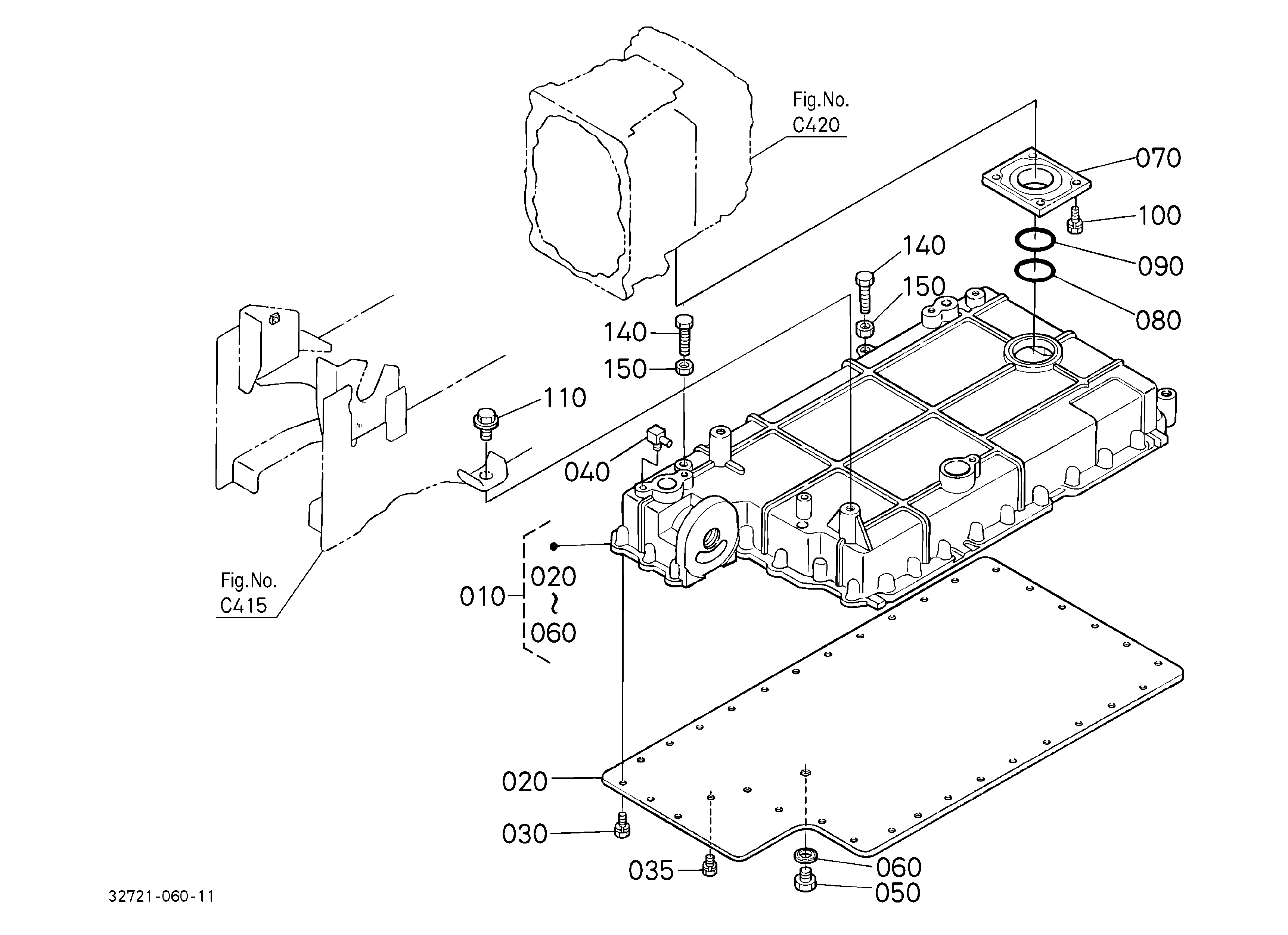

Regarding your oil tank - yes I know what you refer, and from what I surmise, is there is a leak in the connection to the hydro or other fittings on the top of the tank/transmission.
Messicks.com on line parts diagrams are very good here Kubota B21 Parts Diagrams also a TBN member DF Krug has rebuilt several of the B21 machines.

Does it leak just sitting or just when running? If sitting, it could be the tank seal/o-ring, if running I would suspect a bad line connection - I am sure you have eliminated the pipe filters/suction hose etc as you can see those connections from the top side.

I did change the o-ring and looked at what was accessible when the tank was removed. Seems to leak when working hard with the machine.
