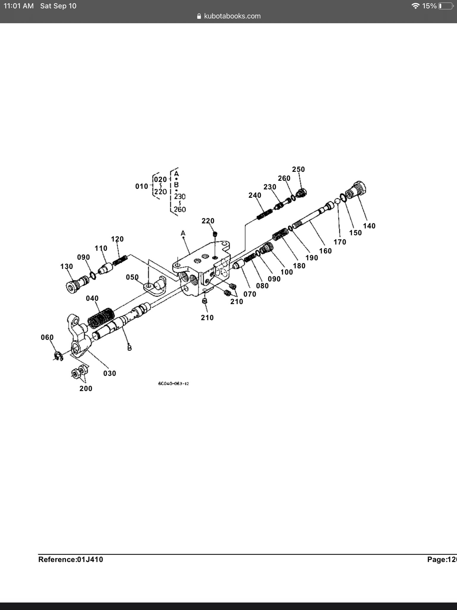

This is the control valve
   / Kubota b21 3 point problem #7
That looks typical.

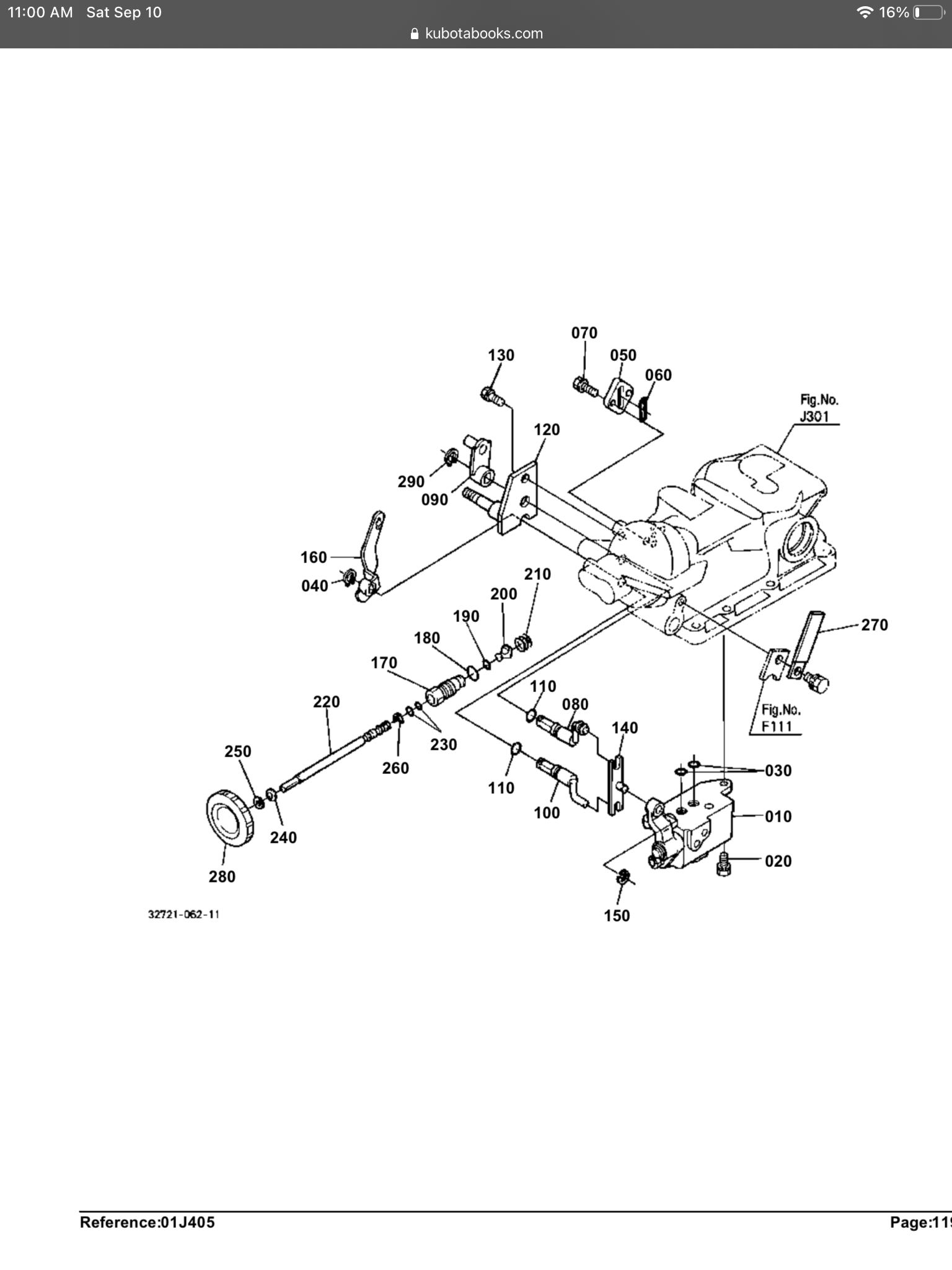

As I understand it, on yours the problem is that you can lift the arms manually and they will just fall down. If the control valve #280 in illustration 1 is working properly, then screwing it in should reduce the speed of the fall and screwing it in all the way should hold the arms in position. At least that is how it should work if everything connected to shaft #220 is doing its job and the 3pt piston seal is intact.
There was a thread not long ago where the securing nut that holds part #170 to the end of shaft 220 had come adrift. The result was that part 170 was left behind when the shaft was unscrewed. For awhile the owner thought that it was missing but finally saw it in the hole and was able to hook it and pull the parts out.
Coming apart like that had caused his odd lifting problems even though it still did work to lock the arms. Anyway, that is pretty simple to check. I'd do that & then try to dream up some more experiments before taking anything else apart.
It could be a problem in the main 3 pt control valve - but problems inside that valve seem to be rare.

rScotty I think you were absolutely right with the problem being in control valve as when I close it it with piston arms raised it it is locked in place and doesn’t bleed off. That should eliminate piston seal at least. Unfortunately it is enclosed in same housing as piston that also has transmission shifter going into it.. I ordered workshop manual and will see how to proceed with disassembly. Thanks for the advice
