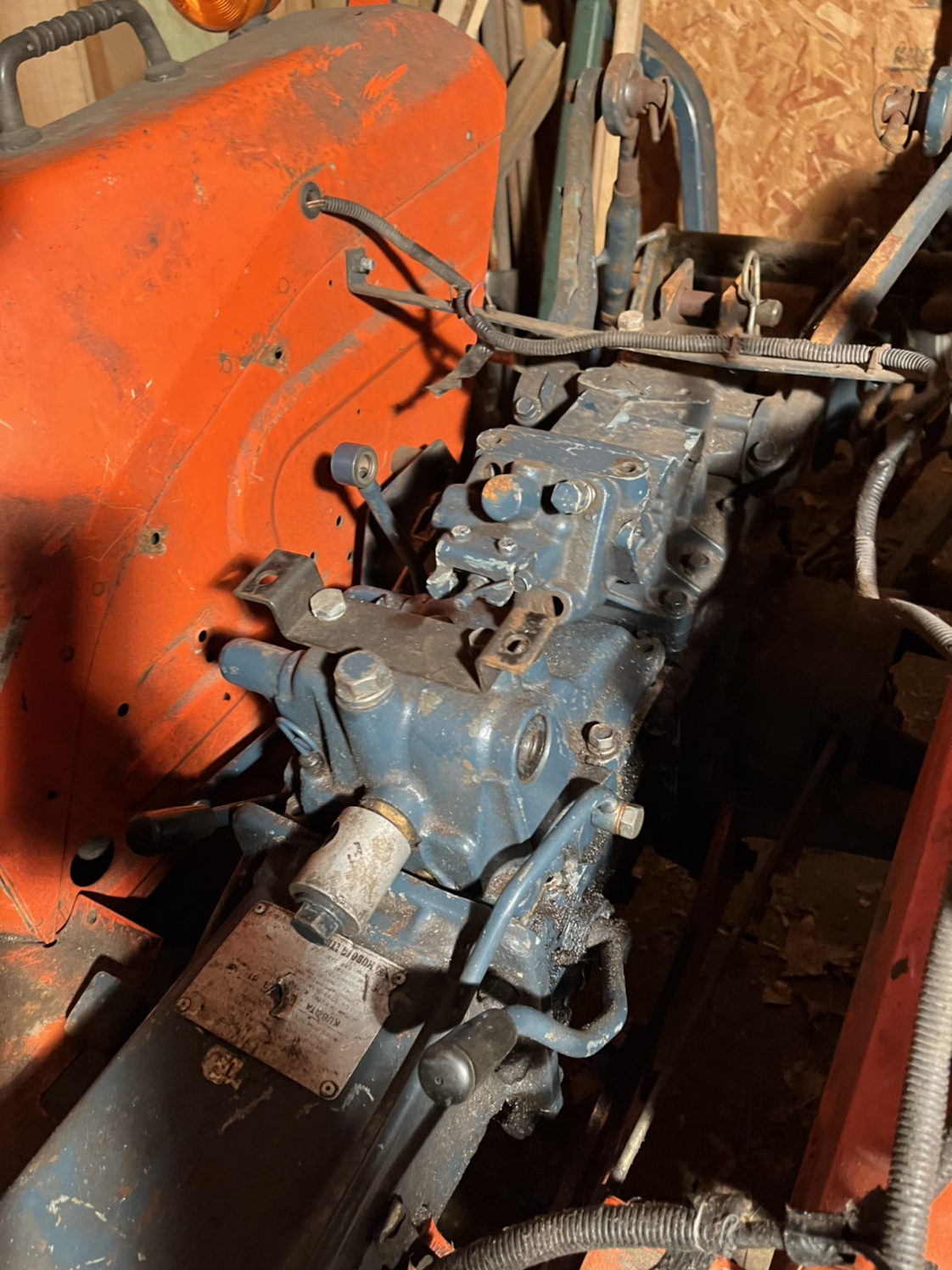

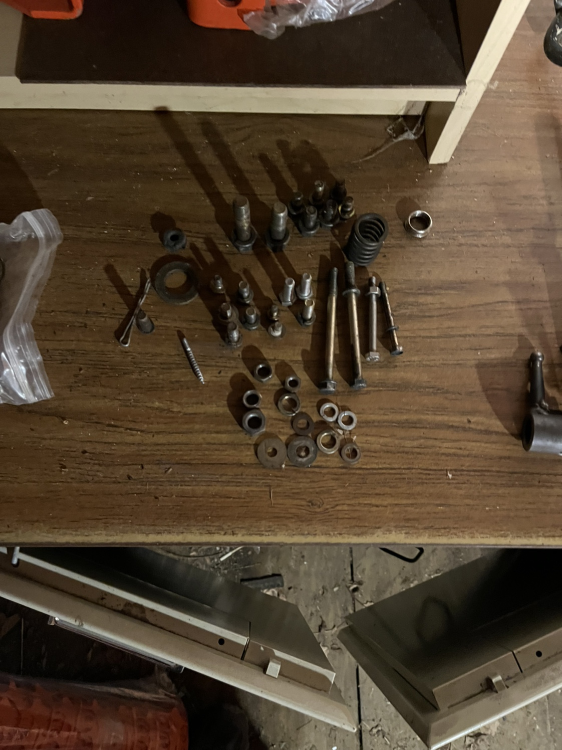

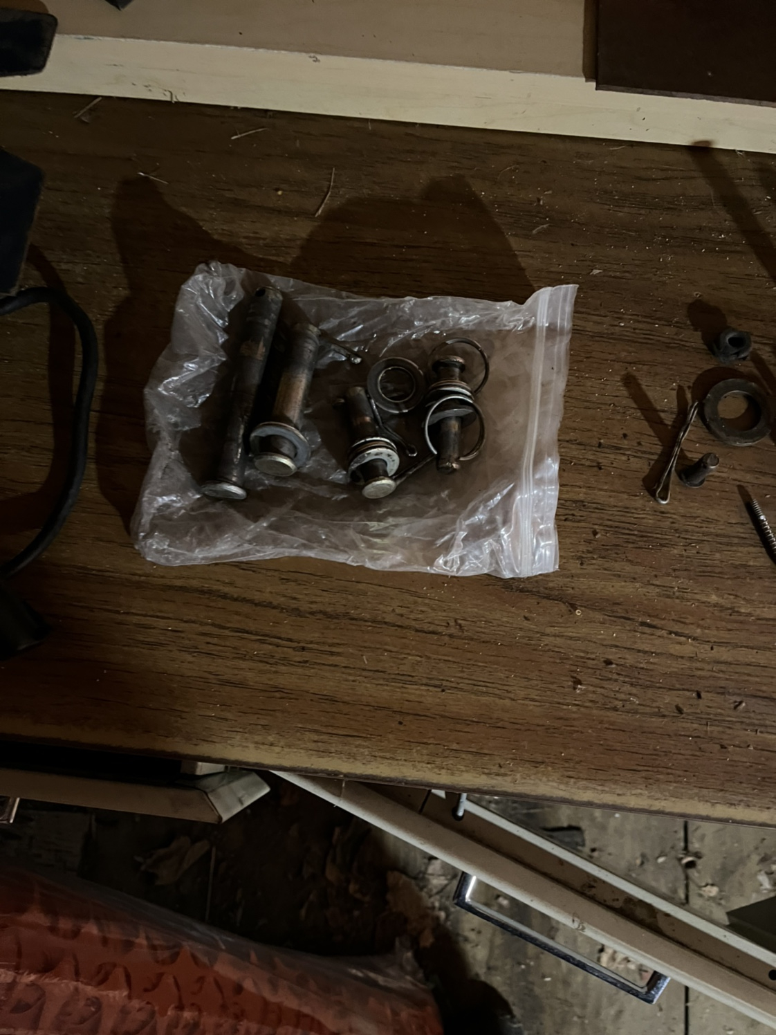

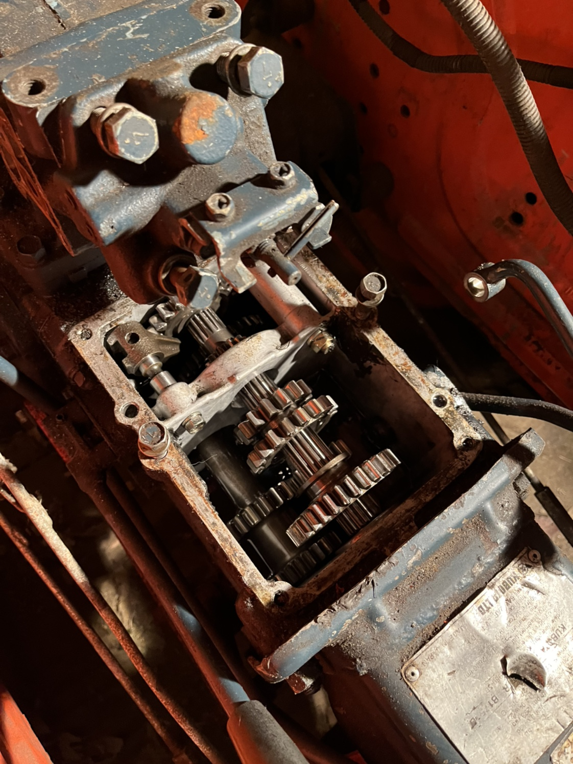

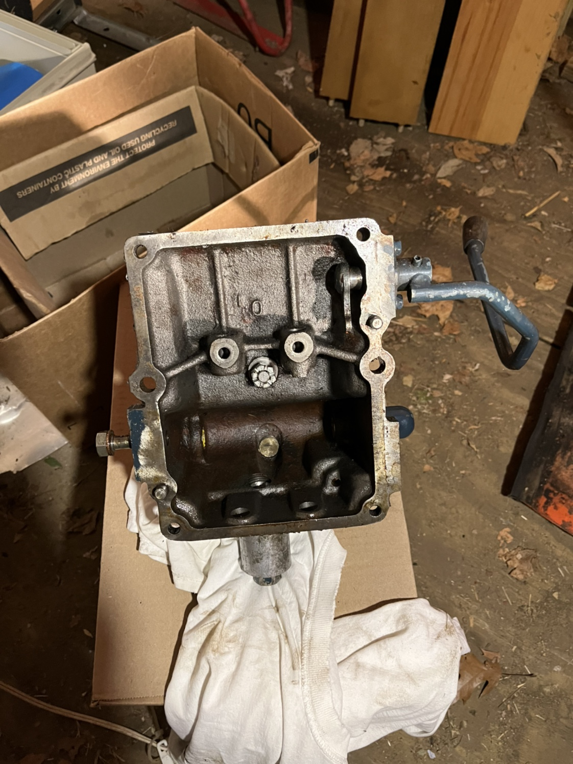

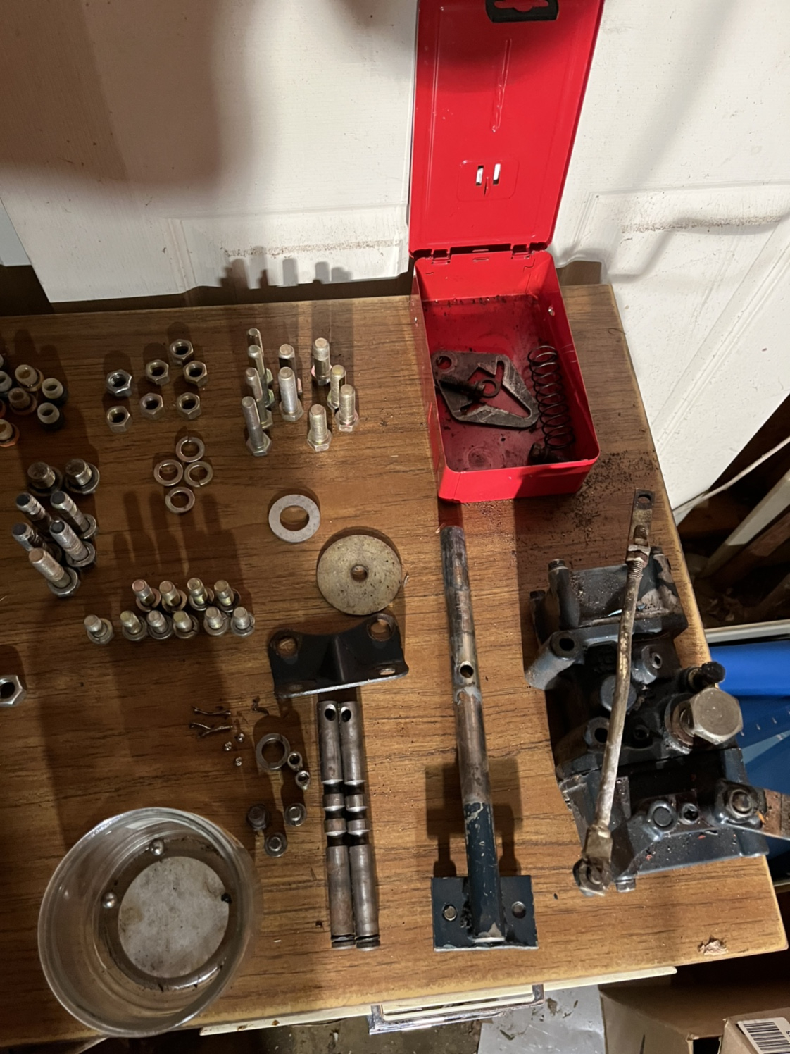

I deleted last post by mistake. Anyway, does anyone have a detailed diagram on how to put together the top case cover with the forks, levers, etc. I have the WSM, parts catalog, and owners manual but none of them show how the parts on the case cover go together. The last owner took it apart because they couldn’t figure out why it was slipping out of gear but never put the parts in bags and labeled them. So it’s a box full of parts. (See photos). Any help would be appreciated.
   / Kubota b1750 manual transmission
Anyone have a diagram, a drawing, or a good picture of how the parts go together in the top case cover?
