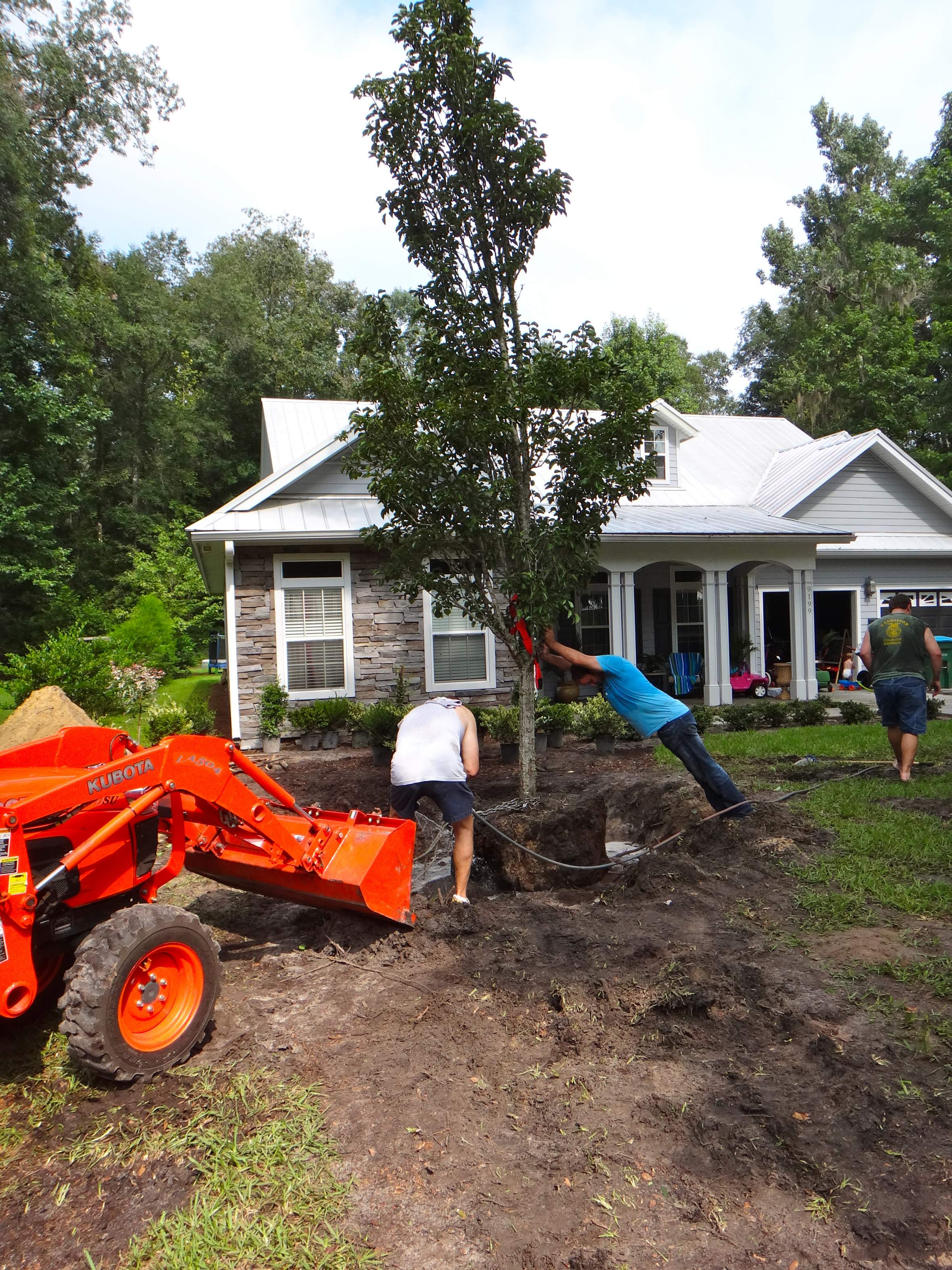

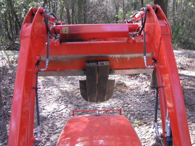

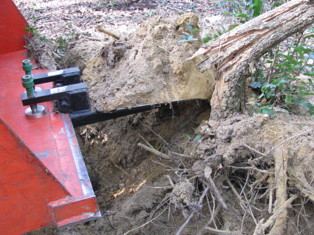

The BX series basically have 9" ground clearance. Not enough for rough ground nor woods work.
Most B's have 12"-13" of ground clearance. B3300SU/B3300 have 14+" of ground clearance. Fine for woods work.
An "L" is a more capable tractor. Buy an "L" if it is in your budget. If you buy an "L" with an FEL consider a Bucket Spade or Ratchet Rake "Rip & Dig" in lieu of a backhoe. (Pictures show Bucket Spade on my former B3300SU)
Bucket Solutions' Bucket Spade LINK:
Tractor and Skidsteer bucket spade shovel
Here is a relevant thread, "B" Series Vs. "L" Series, from the T-B-N archive:
http://www.tractorbynet.com/forums/kubota-buying-pricing/172079-b-series-vs-l-series.html
