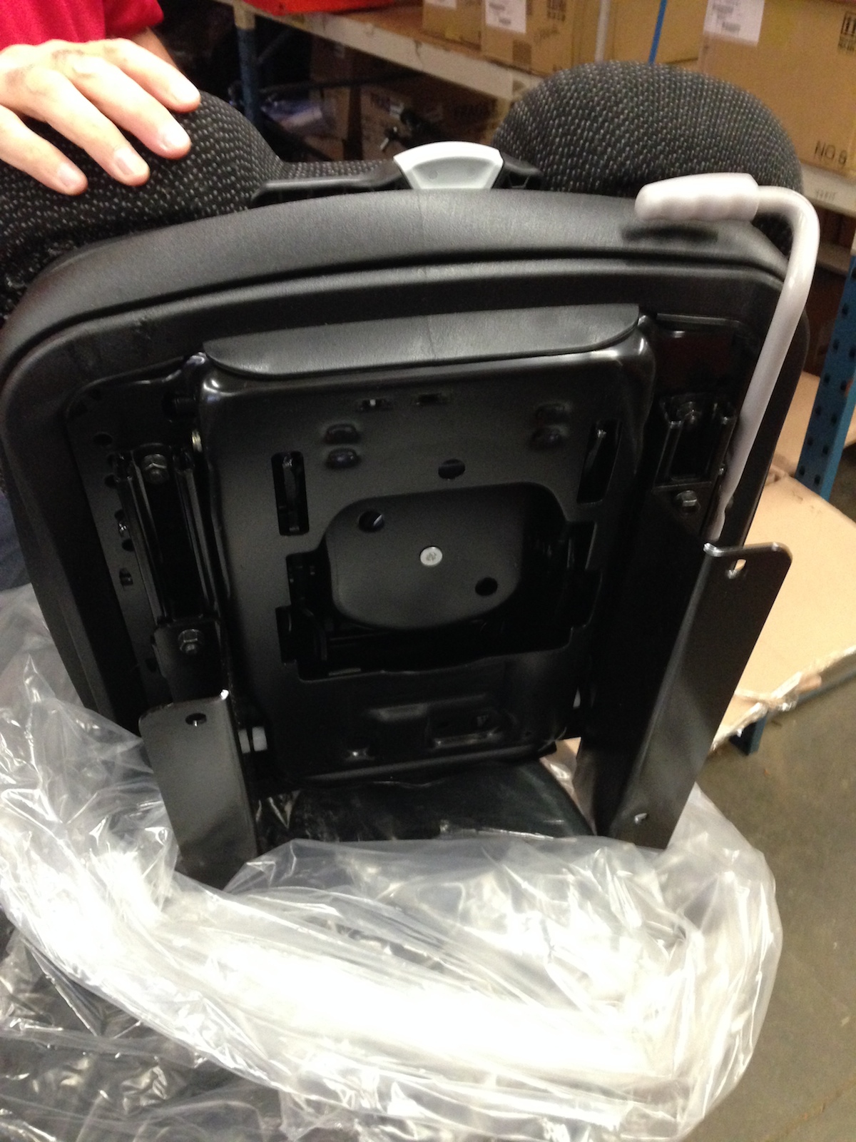

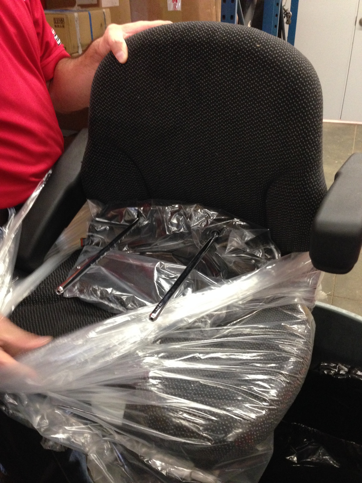

When I look at the pics of the new air ride seat I am confused about the base??? Is the base part of the new seat or a seperate base like shown in 4shorts picture?
I hope it has a seperate base, cause it doesn't look like it would mount on the current seat base?
The new seat pics don't show the seat belts, or operator presence system?
If you have to remove the whole seat and just install what is shown in the pics.....thats going to be a short seat..... especially when you look at the current seat.....or 4shorts seat.
Then again.....maybe I am missing something?
The new air ride seat from Grammer comes with an entirely new base, and you remove the old seat/base on the L60 to install it. There was a wire loom coming off the seat that I didn't get a picture, which I believe includes a plug for the operator presence system and 12 volts to power the seat.
