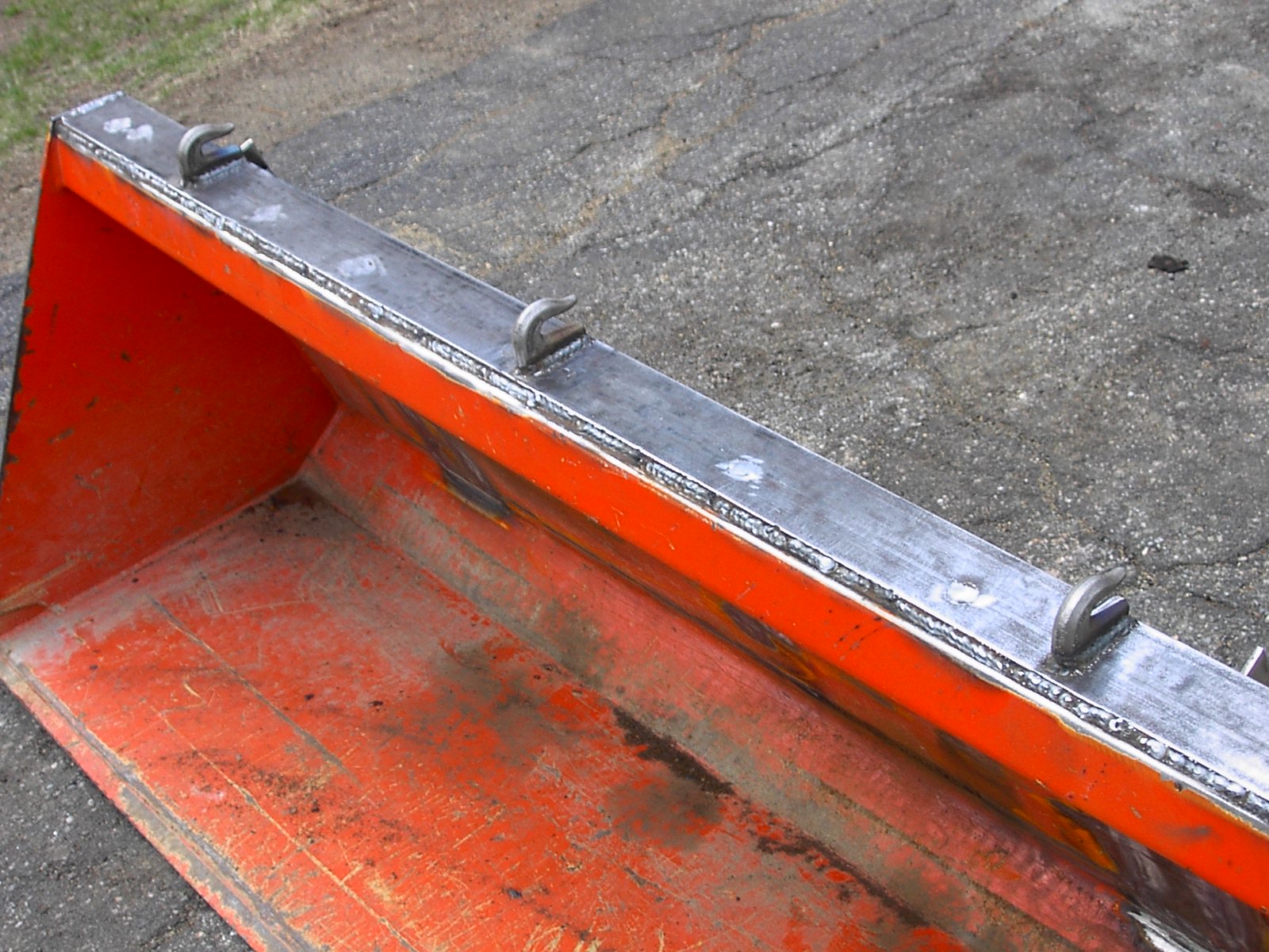

I'd suggest having the tires filled with Rim Guard, non-corrosive and doesn't freeze.
Depending on how bad the bucket is bent, you may be able to clamp a piece of angle to it and straighten it as you weld the angle to it. This will give you a solid place to weld some bucket hooks.
Since you are welding to the bucket anyway, might as well just spend that thousand dollars on an ATI Tach-all and weld a Skidsteer adapter to the back of the bucket.
I suggest loading the rears AND having some weight on the three point when doing any loader work.

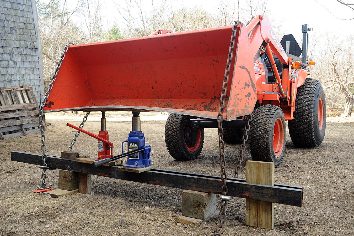

If the top of the bucket is bent that is no big deal. You can try to push it straight with a jack if you weld a flat surface inside to push on and put a couple of 2x8's in the bottom. I mean make the surface parallel with the bottom of the bucket. When done cut off the piece from the bucket weld a piece of flat bar or angle iron is better on the top and weld hooks onto that just like in the Ductape's picture. DO NOT buy a ballast box. You can make you own with a beat up garbage can, some steel, and several bags of concrete. It will cost you about $50.
If you describe what you are planning to do with the tractor people will be able to give specific advice on implements.
ps: here is a picture of how I straightened the cutting edge on my tractor. It had a considerable "smile" when I bought it and it is now near perfect. I didn't need two jacks but I didn't want to point load the metal.
