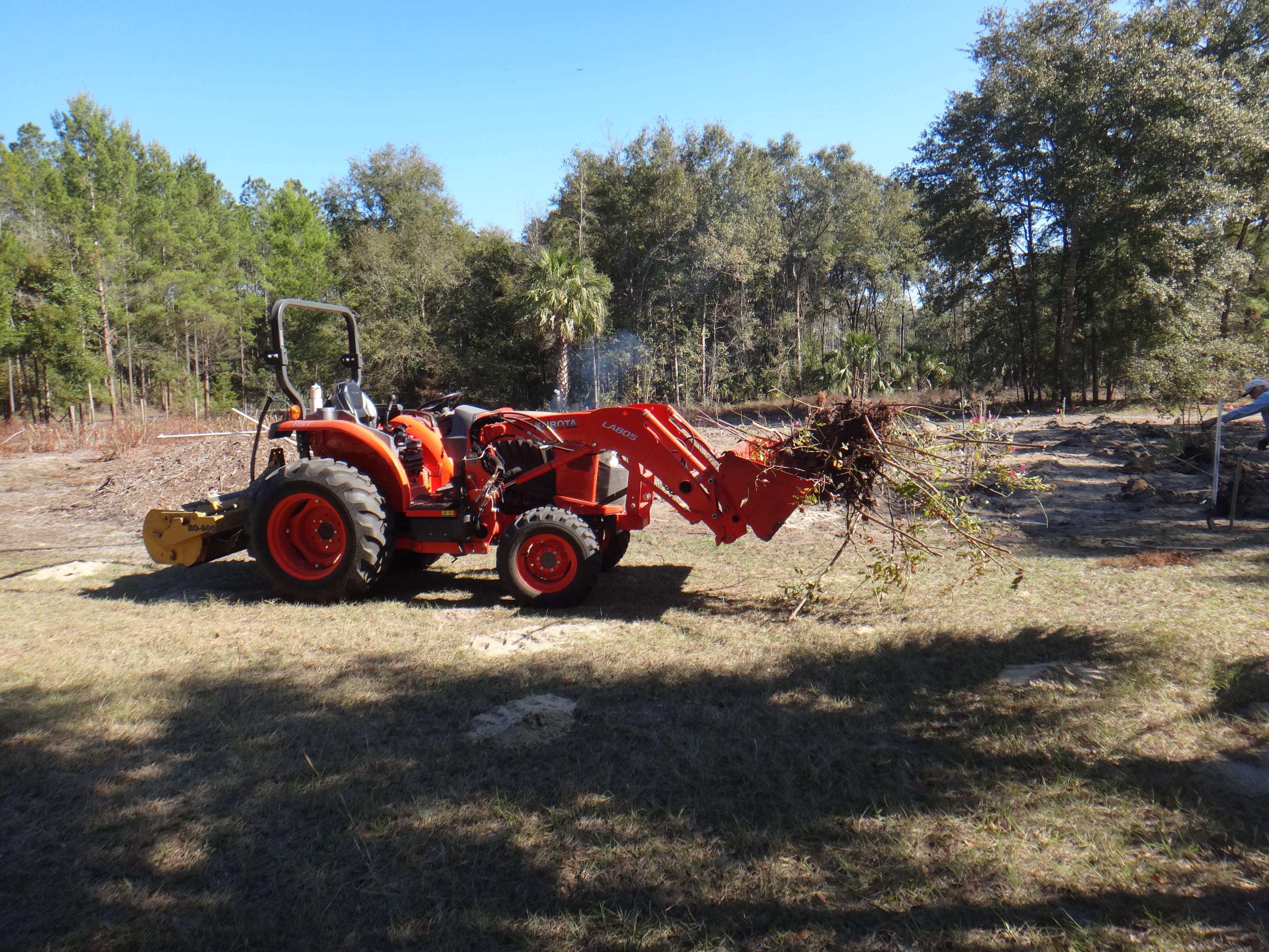

I have the L2296 HD RB bucket on my LA805 FEL. It is 100 pounds heavier than the standard Kubota bucket due to reinforcement. L2296 comes with SSQA (Skid Steer Quick Attach). You do not have to baby a L2296.
L2296 makes a superb, rigid mount for a 110 pound Bucket Spade, the most underrated tractor attachment. Also a wonderful mount for an 88 pound Ratchet Rake.
Photo #5 is Kubota B3300SU with standard 'B' bucket.

Looks like the chain hooks gave it a run for its money though :)
