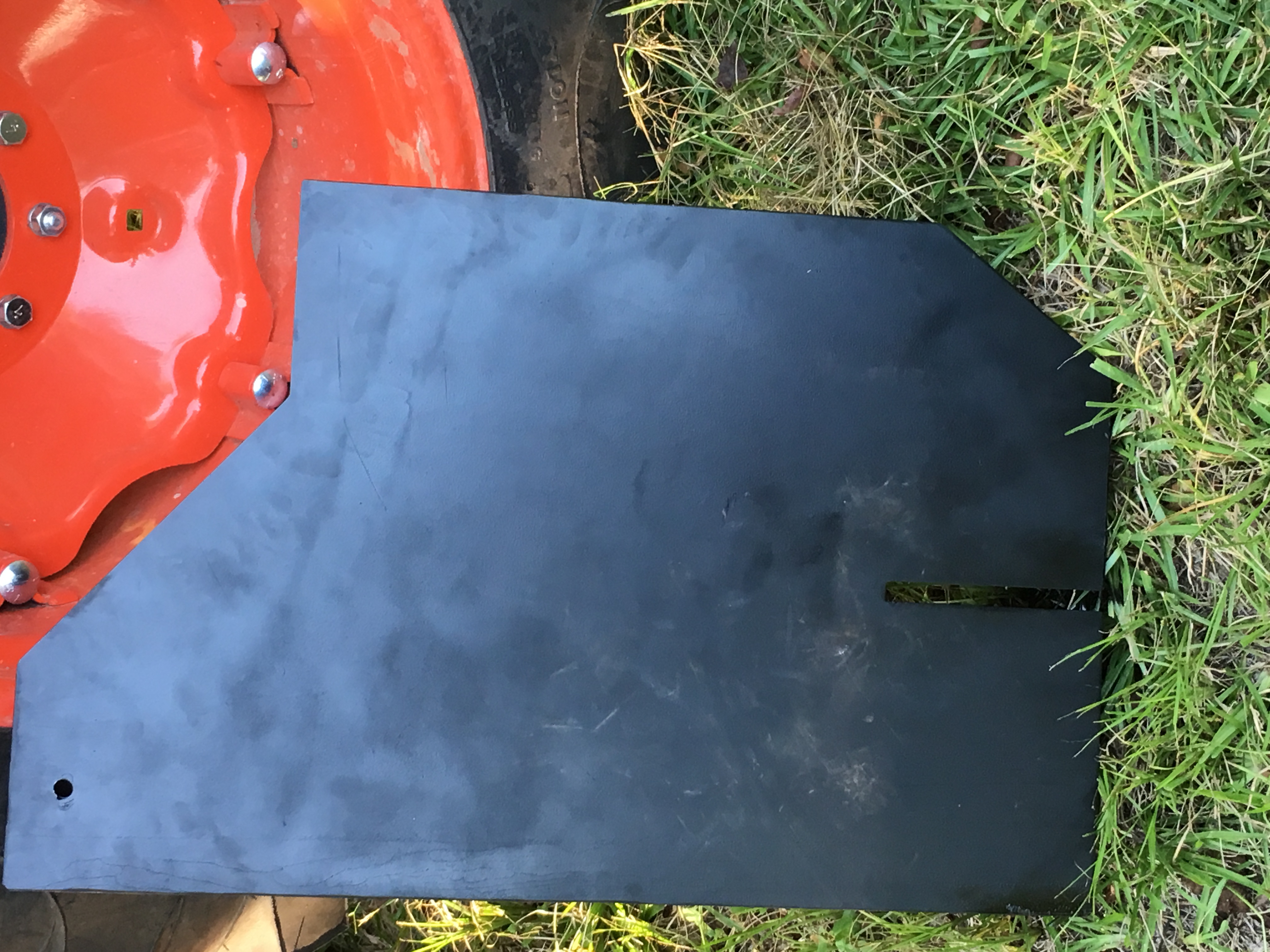

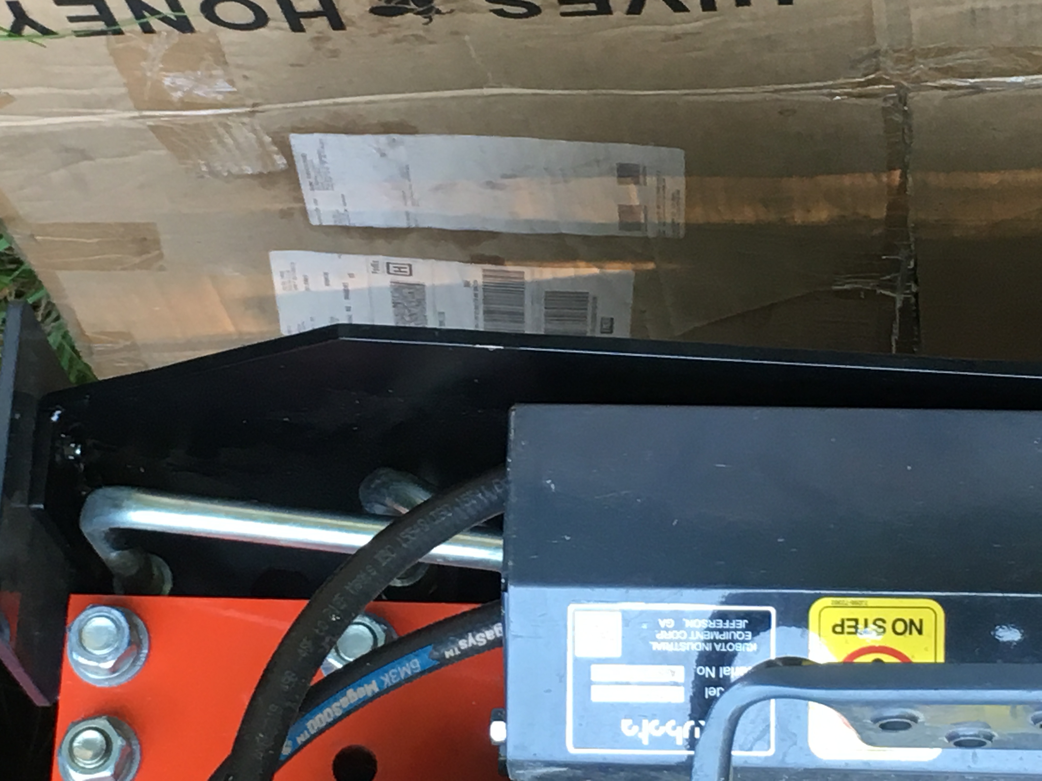

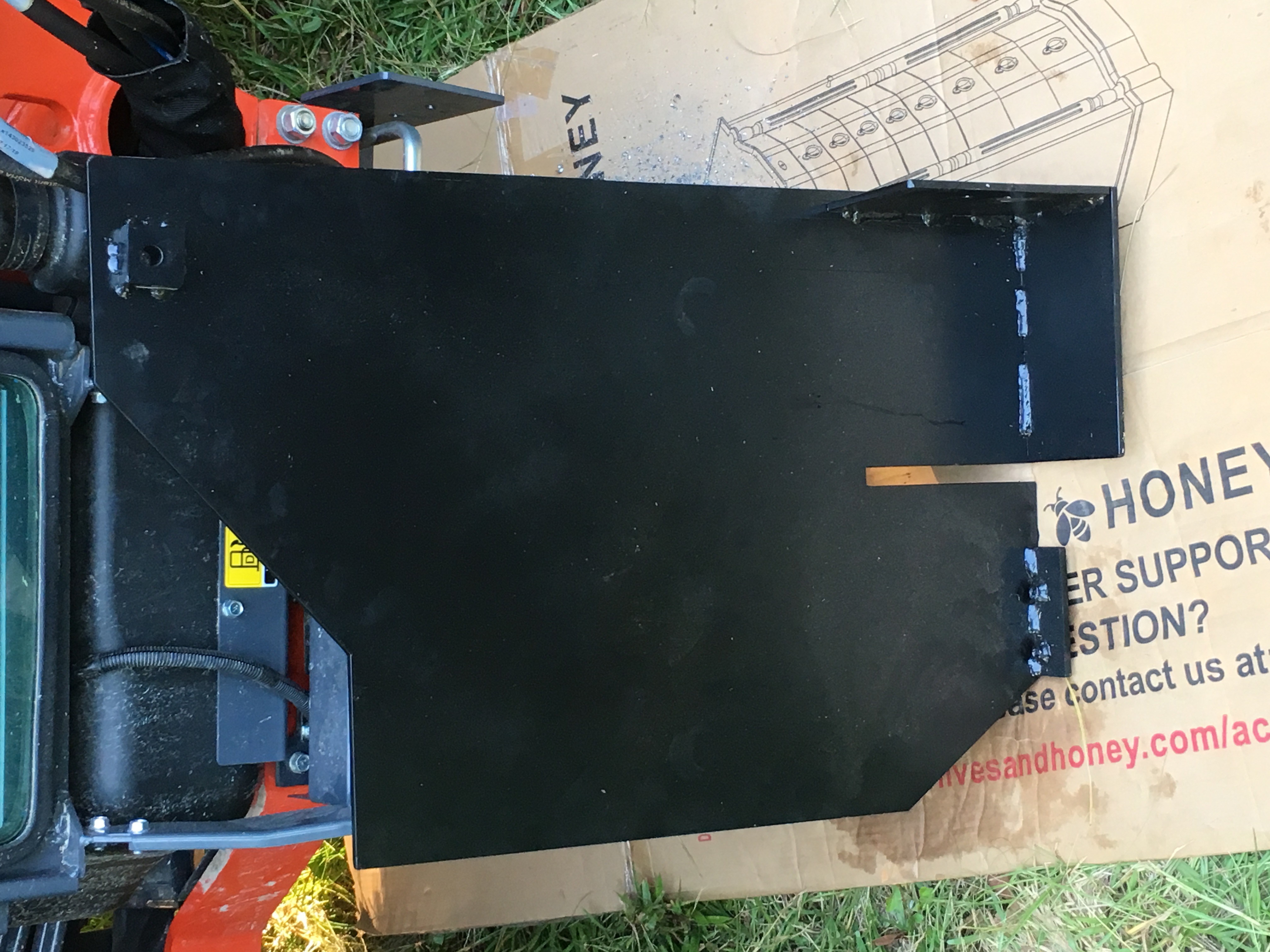

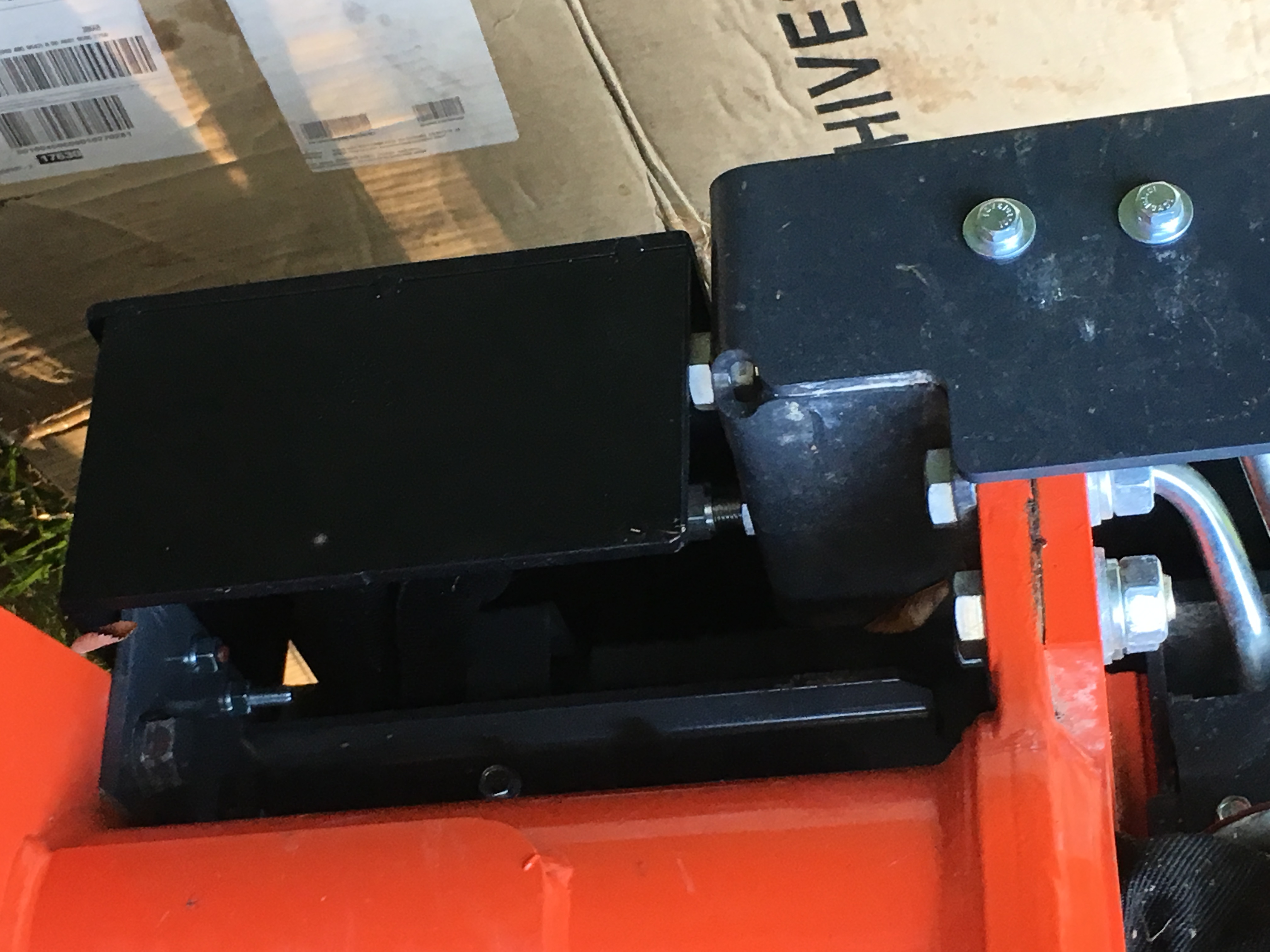

I finally got the skid plate made and mounted to protect the fragile under side of my Grand L. I originally only planned to protect the third function hoses but then decided to extend the plate back a little further to provide some protection for the filters and metal lines as well. Sorry that the phots are not the best. I tried to get a picture under the tractor but there was not enough room to get a decent photo.
   / Kubota 5460 skid plate #2
Very nice. The underside of my M6800 is also fragile. Where did you get the plates? Were they custom made? I didn’t know Kubota made any.
I had a coworker make it. I made a cardboard template that he used as a pattern.

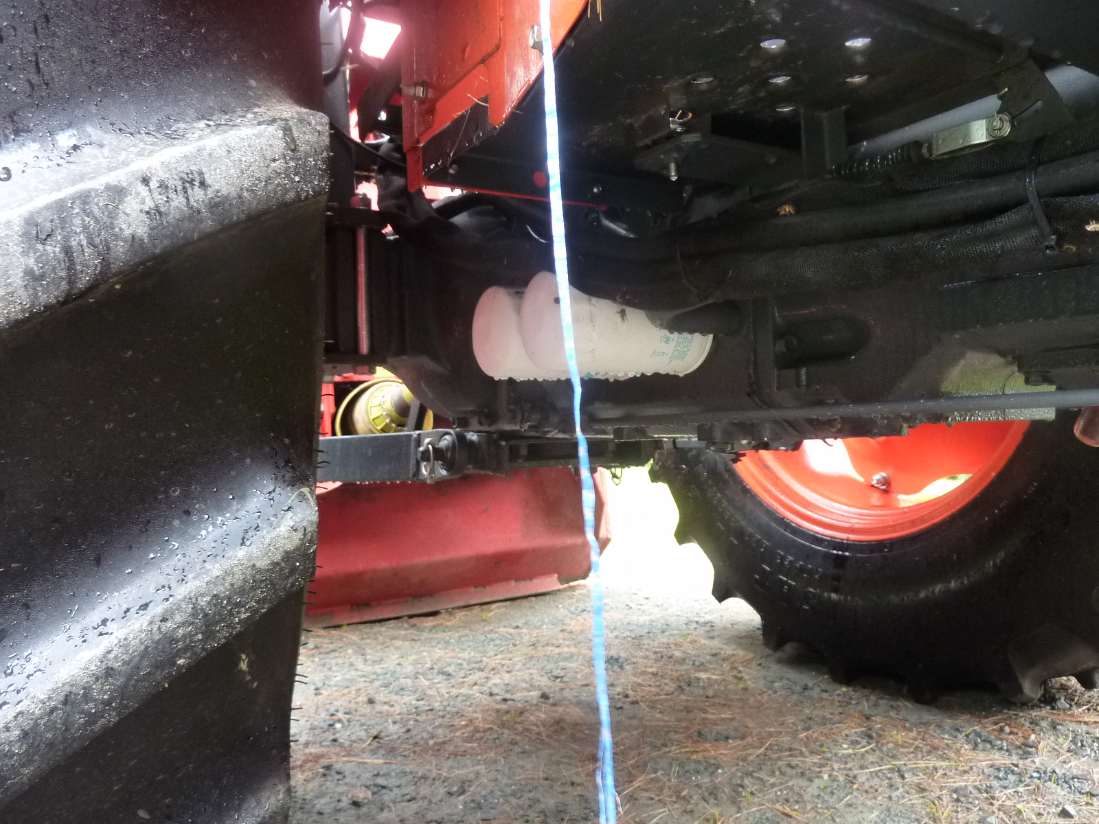

That came out nice. Smart to cover those filters. They are a big thin skinned target.

The hydraulic filters are tucked away on this tractor but a stick could still find its way. Several years ago I had teed log crush the hydraulic filter and break the cast fitter housing on my Mahindra. I think there is probably an old thread on TBN about that incident.
   / Kubota 5460 skid plate #7
You're lucky they are tucked away. On both my Kubotas they are hanging right out there. Once bit, twice shy is a good way to go though.

Gordon, mine are vulnerable too. I went forward and protected the valves as well.

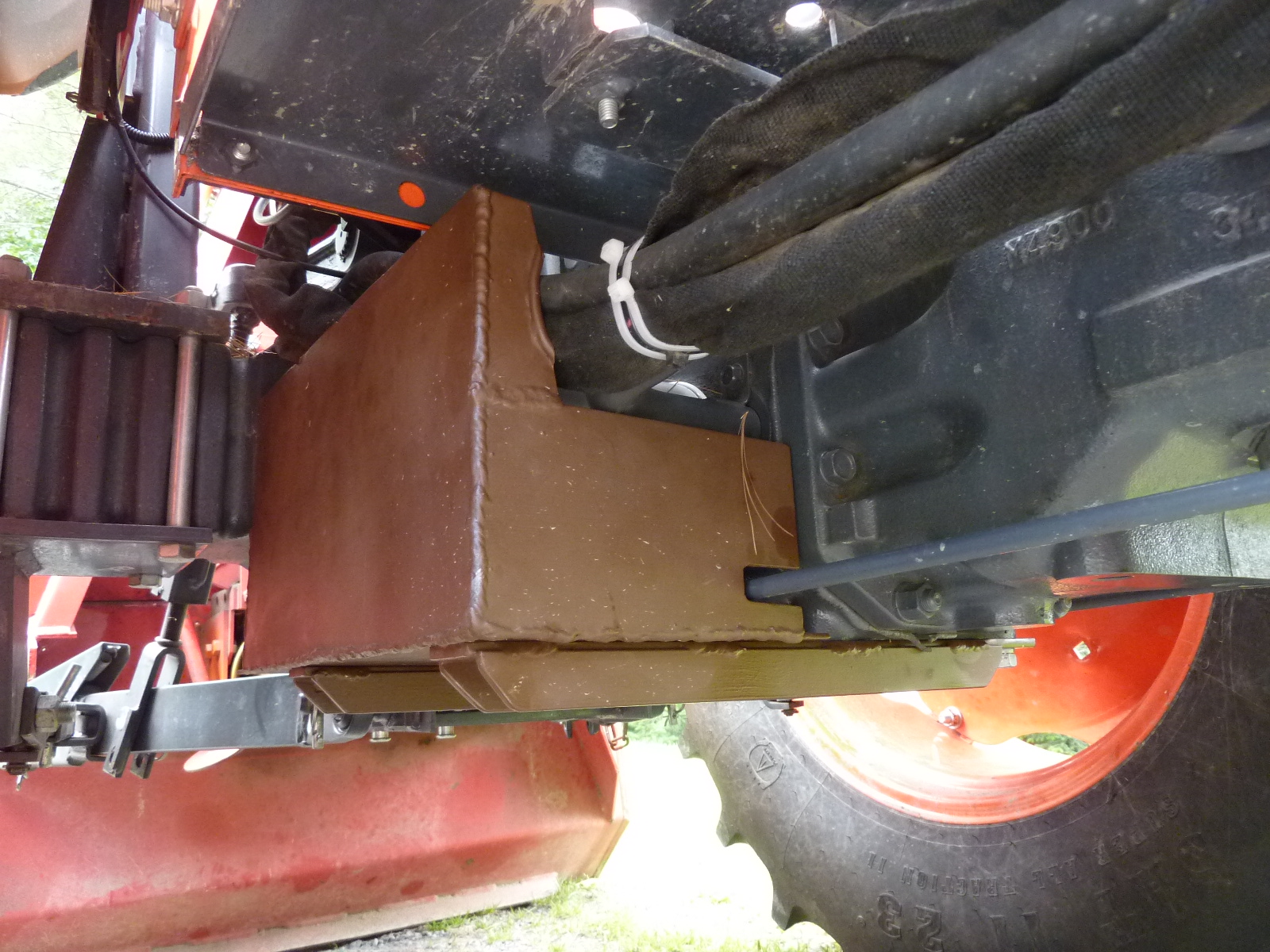

Nice job on the 3rd function protection. I'm not much on metal work, so I ordered the kit that Paul Shorts sells (Specialty Repairs).
After hitting my rear high flasher lenses several times I also got his light guards.
