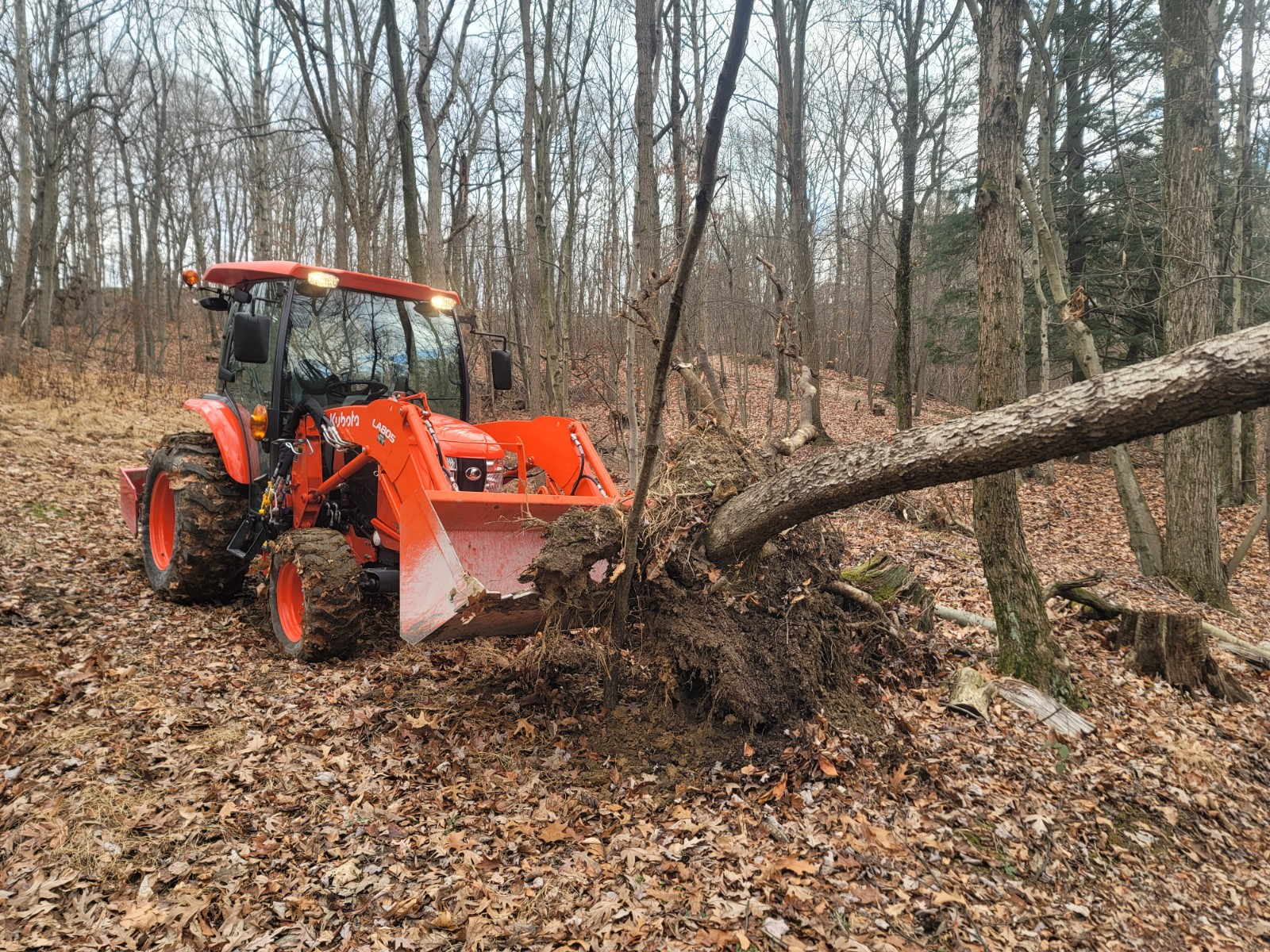

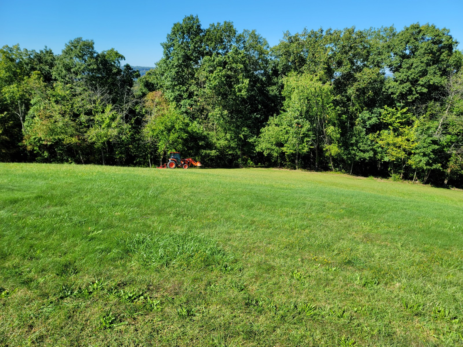

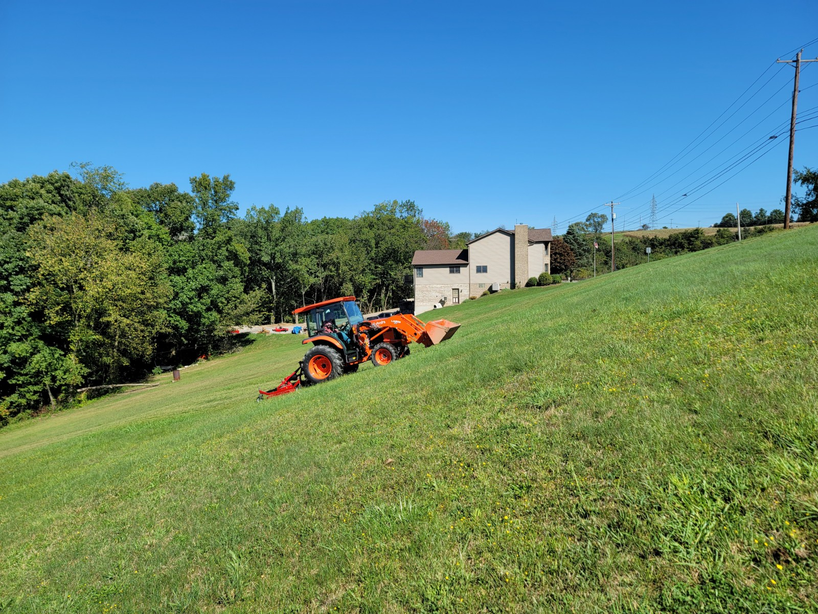

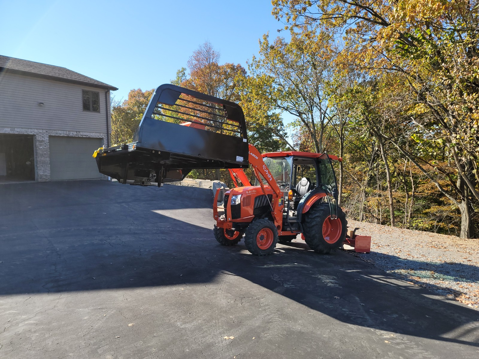

I can pull a 72" finish mower up my shallow sloped yard with a 3560. It does need the low side of mid range, and you want to get out of the auto hi/low shifting mode otherwise you do get a weird lag between the auto shifts that kills your motion. I use the auto shift mode for normal loader work as well as mowing my father in laws near flat pastures, but here I use manual. More HP would be nice only in this instance. Pulling the 72" up the slope using the stall guard means that it cuts HST motion to maintain the PTO speed and not dog out the engine. The system seams to be designed so that the motion is where the system takes from and the PTO speed is what the system wants to maintain. But unless your mowing on slopes like this that are pretty dang steep, even the L3560 gives pretty dang great torque for 72" mowers. I will tell you that I don't have any emotional issues in using this machine to mow this, my old B2650 flat out could not do it. And in honesty, this machine was not bought or intended for mowing this yard. I prefer my twin 54" Husqvarna garden tractors with my wife and I running in a line getting over 100" of cut width per pass. As far as mowing goes, this is for my father in laws place and doing some side work. But it's major reason for existing is for trail maintenance and handling thousands of triaxles of material each year. She's a real nice machine at around 4200 LBS plus another 1400 for the loader and bucket and around 1600 lbs of rim guard.... it's around 7000+ lbs of machine. She pushes pretty hard and can do some real work. My dealer claimed it was over 10K lbs as built with the backhoe on it, but I don't quite see that. I did ad rear top and tilt and a front 3rd function, that top and tilt is a total game changer. I recommend that every tractor owner on earth add that!
