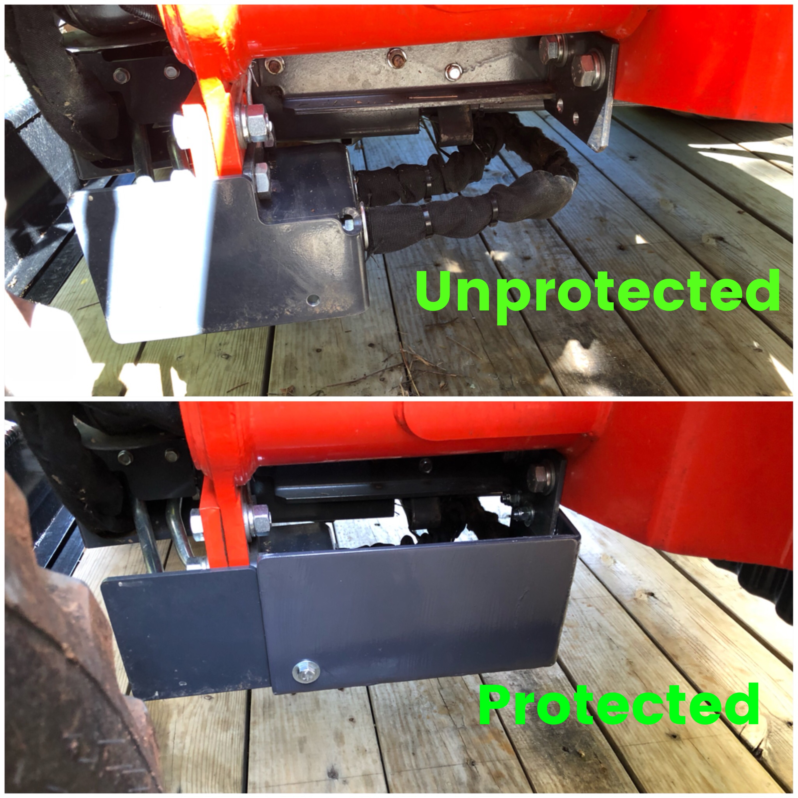

Hey guys. Two weeks ago I snagged one of my 3rd function hydraulic hoses on a small tree stump. It ripped the hydraulic fitting completely off. Within minutes I had lost 5 gallons of hydraulic fluid and my tractor was officially disabled in it's tracks. It's hard to believe Kubota didn't develop a better protection system for these two lower hydraulic hoses that are just waiting for something like a small stump or bush hogging saplings to rip them off.
I took this issue to my neighbor who is, by profession, a master welder for the Nascar circuit. In a matter a days, he had fabricated an exact perfect fit made out of steel that would FULLY protect these hoses. Using the two existing drilled holes on the inside frame, he made a complete box that protects not only the bottom of these hoses but also the front and inside portions. The hoses are now fully protected from any future damage.
I am attaching photos so you can see the before and after pictures as well as the complete finished job. If anyone out there has this same issue and you'd like this custom fabricated hydraulic hose protection system, give me a call 336-671-2665. My neighbor kept all the dimensions/specs when he made mine. It will work with any L-Series Kubota tractor with this 3rd function kit.

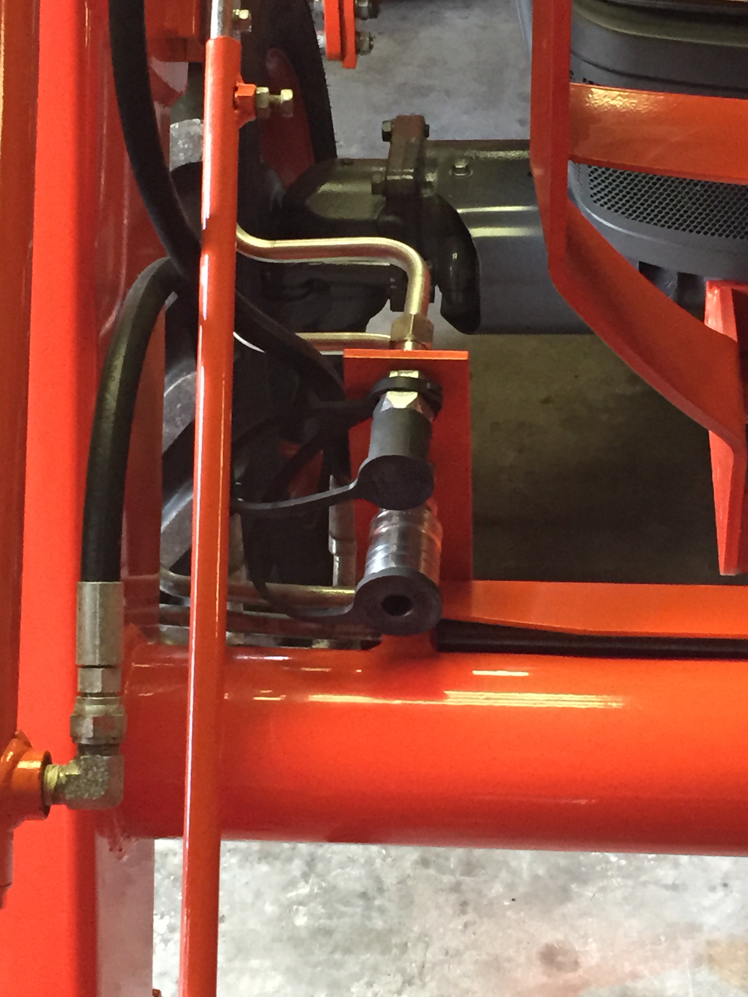

Neat job talented fab man, The below are factory installed 3rd function on my Grand L3540

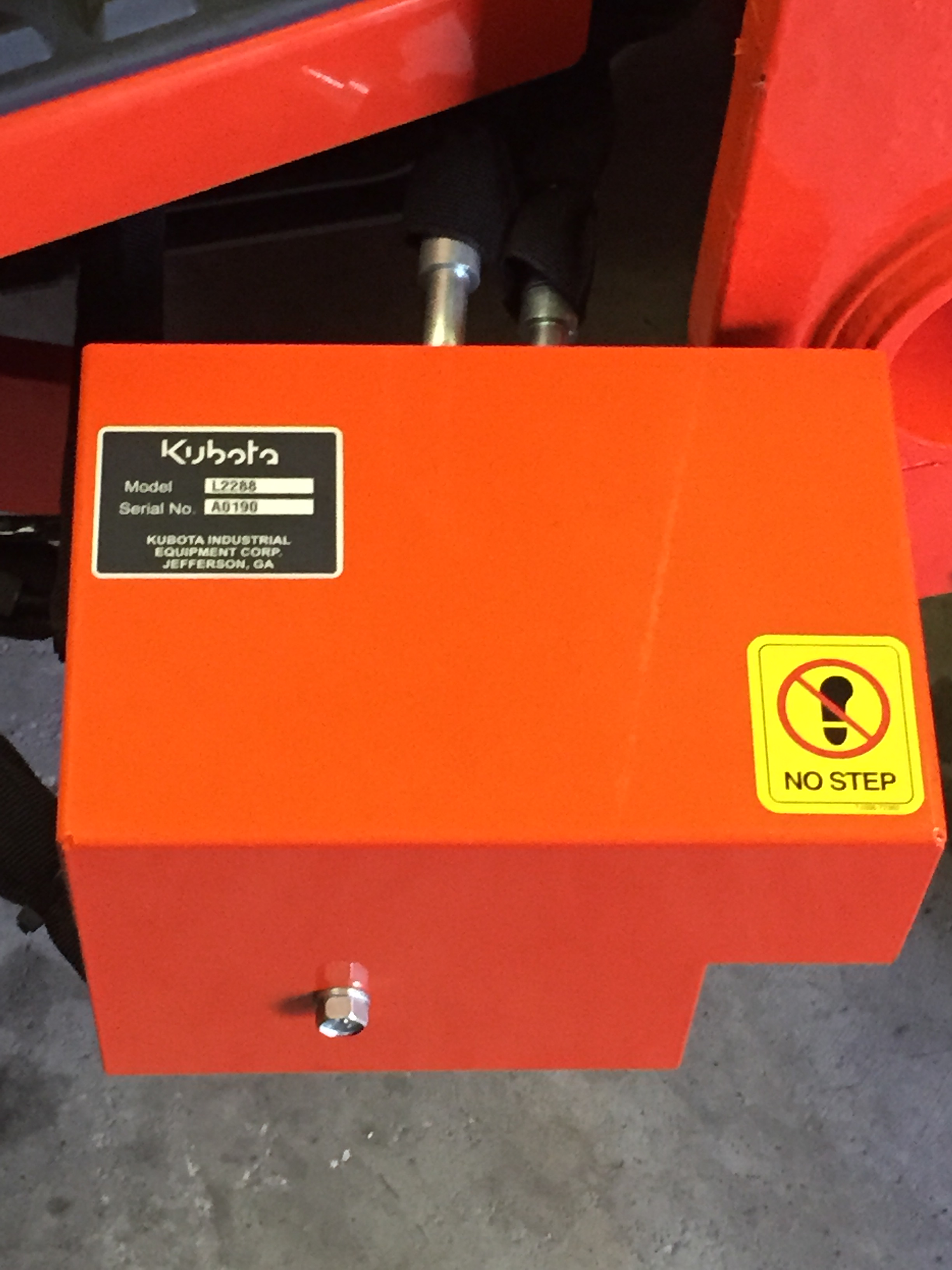

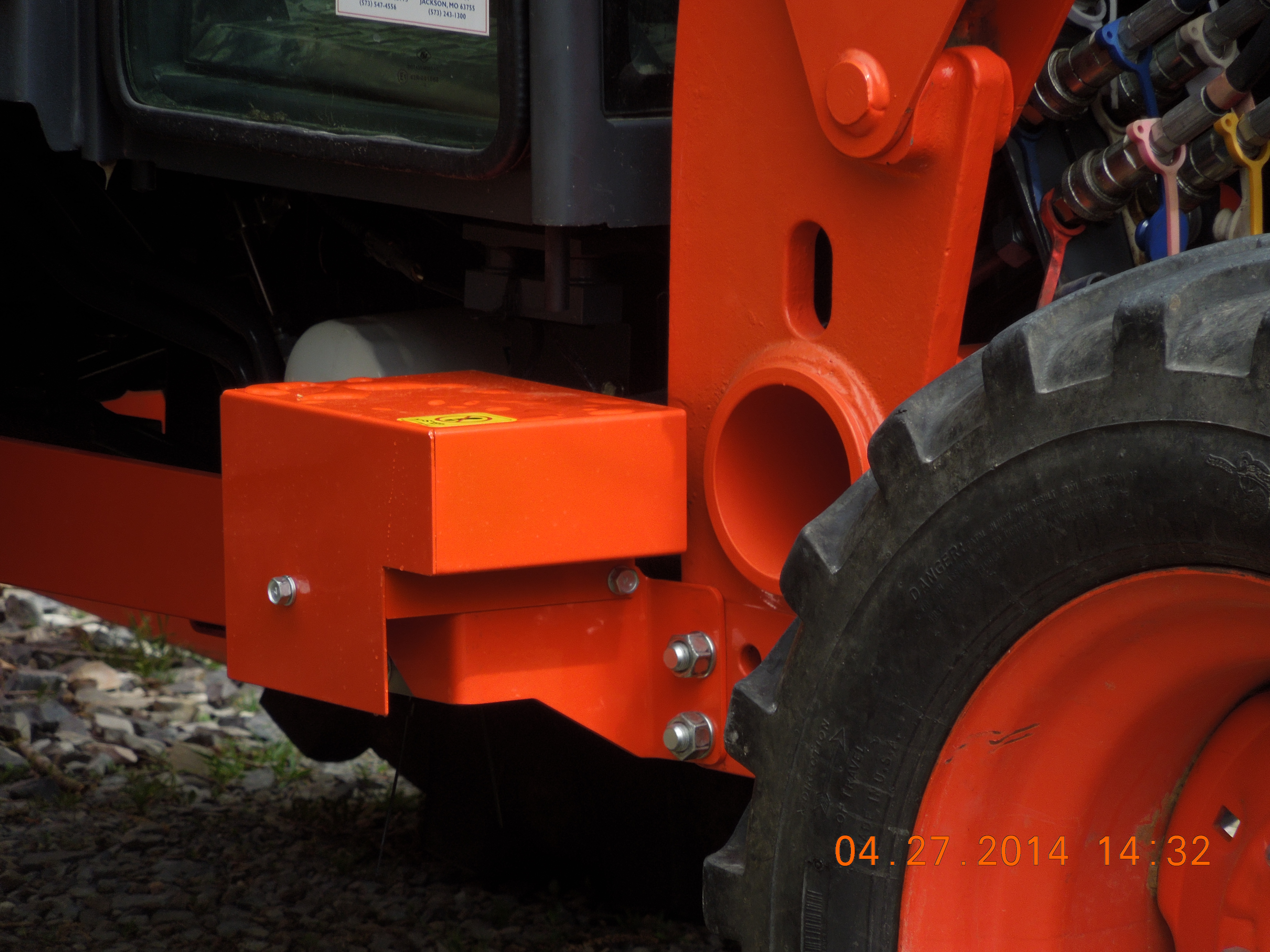

View attachment 564571That should do the job. That "box" looks exactly like the OEM protection on my 2009 Kubota M6040. Strange - they realize and provide protection on the M6040 - - why not yours. My hydraulic line positioning is almost an exact duplicate of yours.
The picture is of the OEM "box" that protects my hydraulic fittings & hoses. Also good at catching mud thrown off the front tire but its washes out easily with the garden hose.

I addressed the OP issue with my dealer on the 3rd function hoses. They made plates like shown in the first post and I am a happy camper. They are going to add this to any tractor they sell with the 3rd function kit. Makes great sense to me! Thanks L Downey.....this was a big issue on my tractor too.
