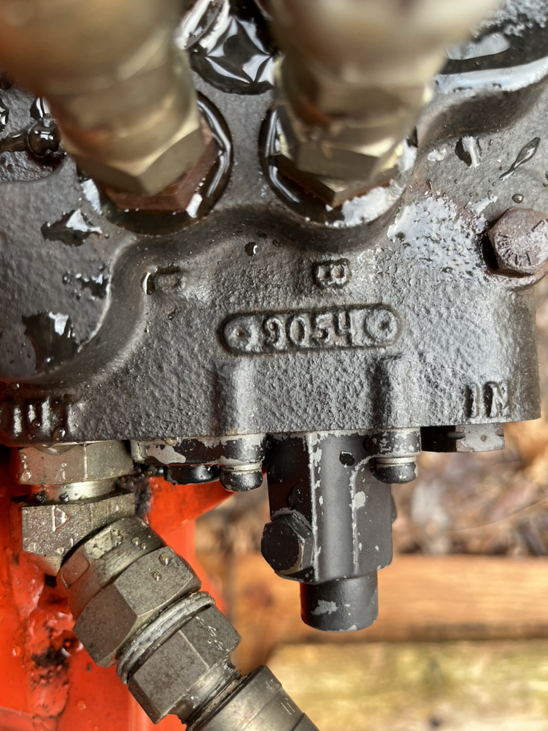

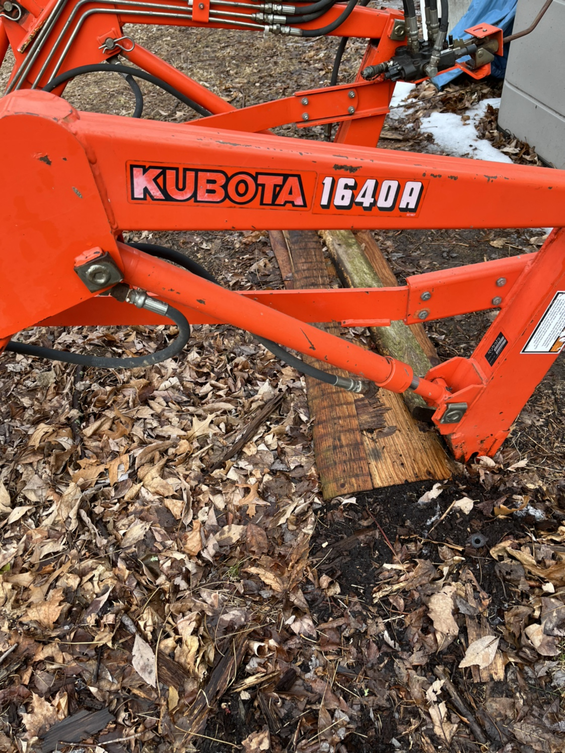

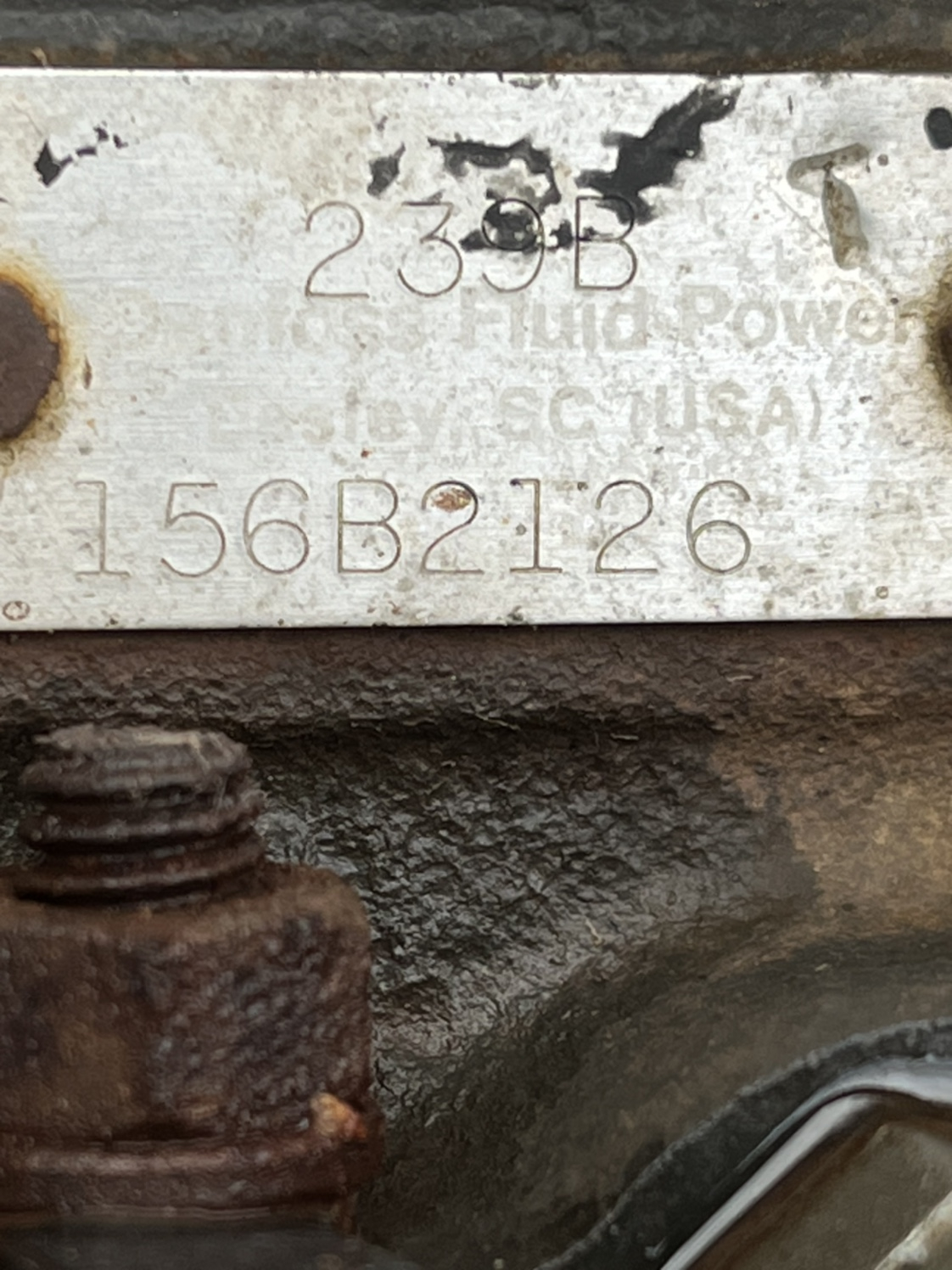

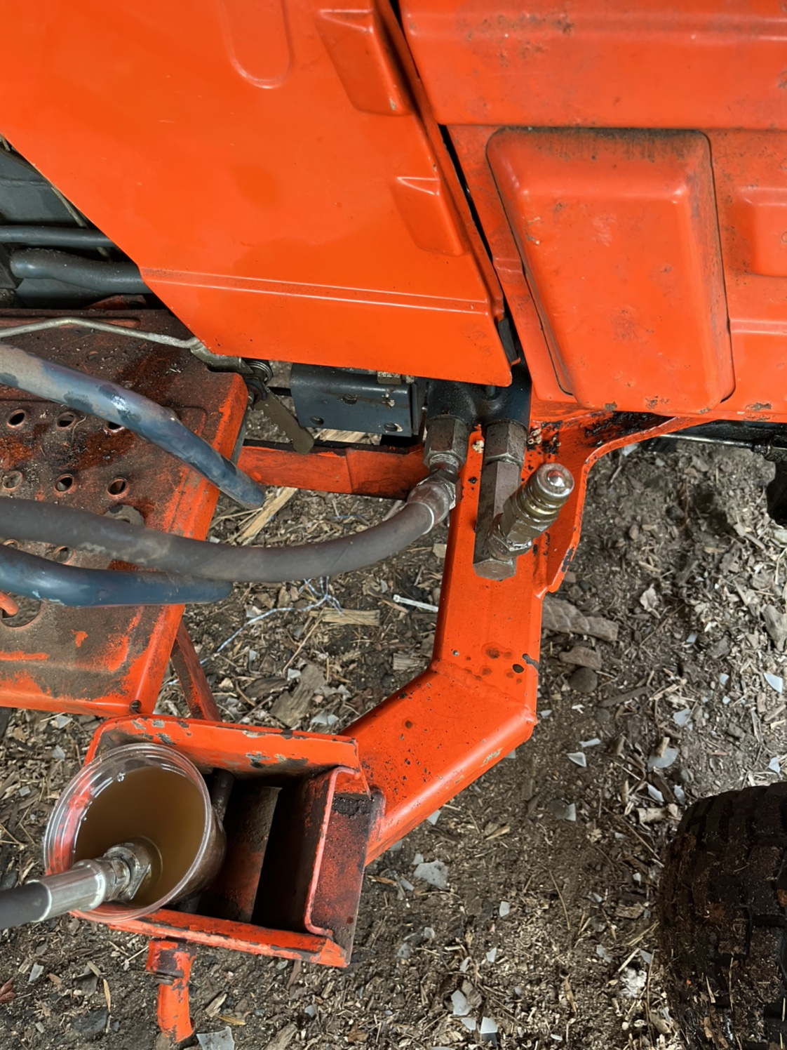

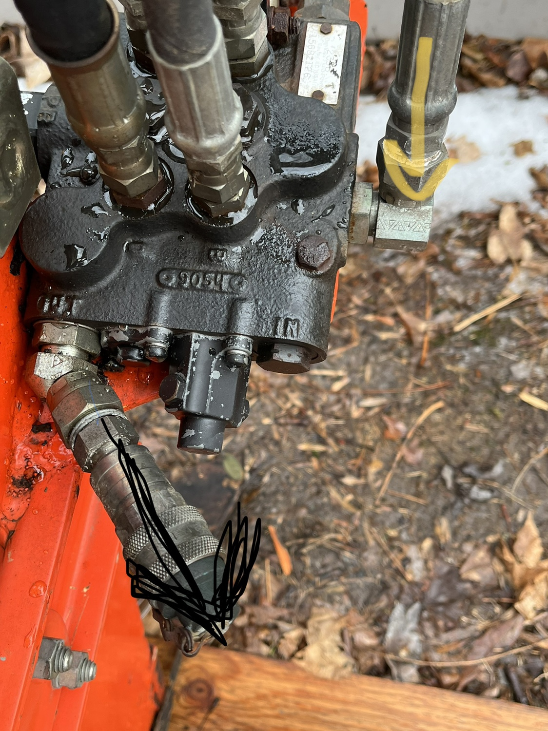

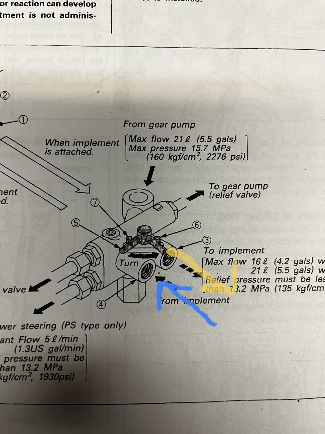

I have a kubota B1750D tractor with 1650A loader and I’m trying to figure out how they connect to each other. I bought this used and in pieces and I’m trying to rebuild the tractor. The way it’s setup right now doesn’t make sense to me and I’m wondering if it’s setup correctly. I have color coded the pictures where yellow is the out from the hydraulic block on the tractor and in the in on the loader. Blue is in on the hydraulic block and out using the Power Beyond on the loader. Black on the loader is out on the loader and gets a hose connected and dumps the fluid into the transmission of the tractor. I’ve had kubota’s, John Deere, Yanmar, Ford tractors and I’ve never had the loader connected like this. It’s usually just two connections from the block to the loader. Did the original owner did something wrong or is it like this for this loader/tractor combination.
   / Kubota 1640A loader connections
#2
never mind. I found a video on youtube and the connections are correct
