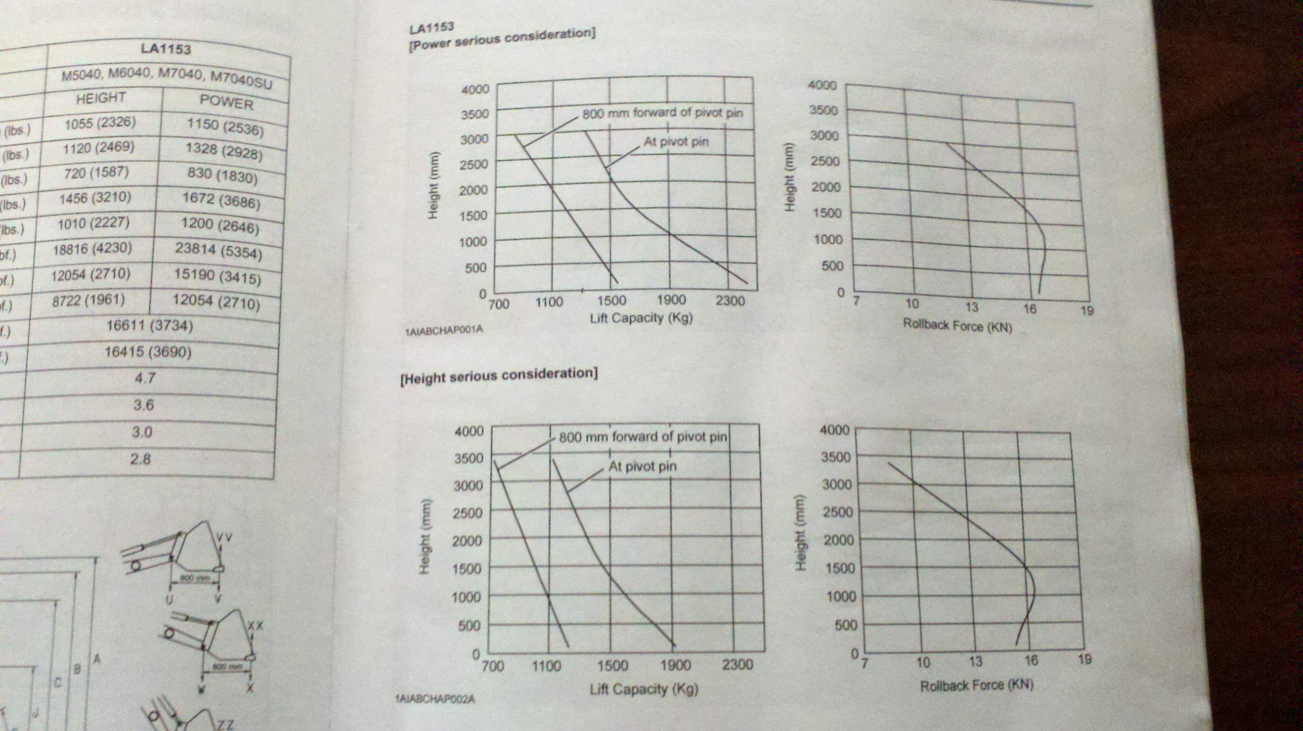

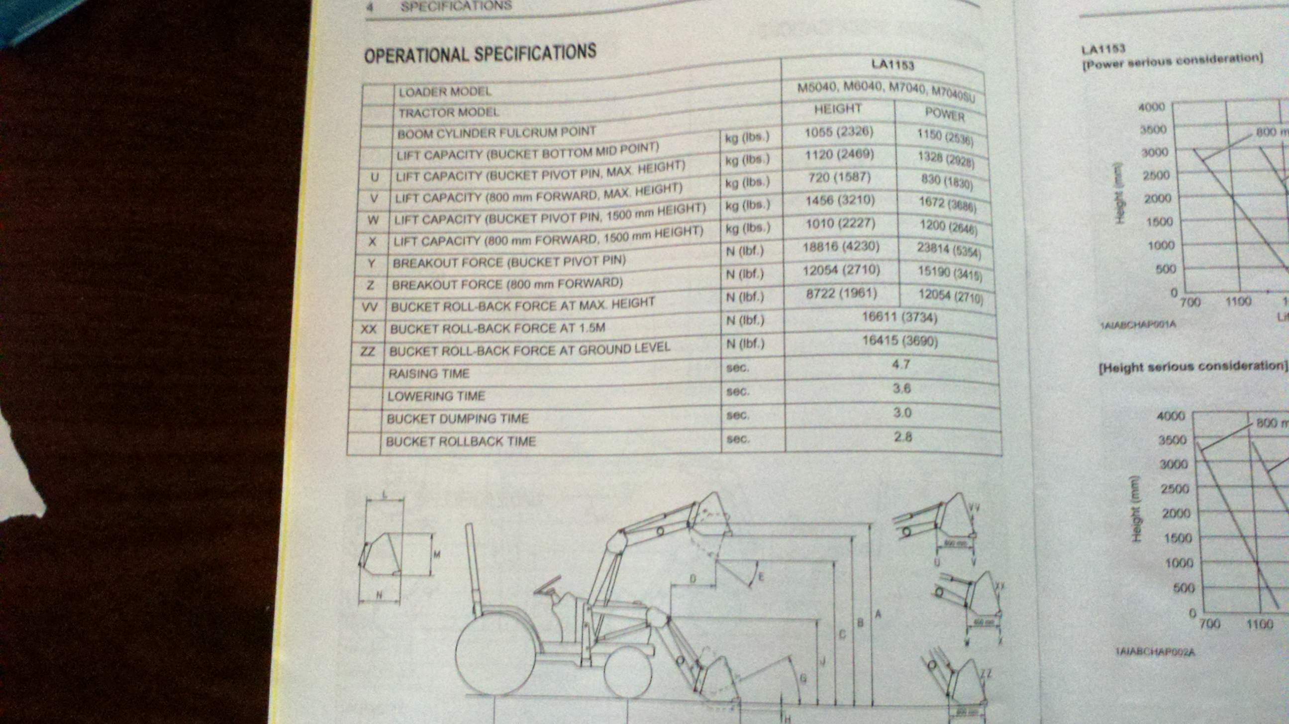

I recently bought a Kubota M5040 (HD/4WD/ROPS), and had gone back and forth for months (years?) before making my choice. A lot of the reason I bought this particular Kubota was the impressive lift capacity in the Loader. I really wanted to be able to unload a pallet full of material from the bed of my truck. Kubota publishes the specs for the max lift height, but i Had a hard time finding "half height" lift specs. Once I bought it, and cracked my user manual, I found what I WISH I could have found beforehand :) So I took some pictures of it, and will post them here.
The short version (for my particular needs) of taking a pallet out of a pickup truck bed:
Height Setting:
36" (914mm) High -
* 31" (800mm) Forward - 2,425 lbs
* Pivot Pin - 3,500 lbs
Power Setting:
36" (914mm) High -
* 31" (800mm) Forward - 2,866 lbs
* Pivot Pin - 4,299 lbs
Disclaimer: These are my interpretations from visually reading the graph below. I'm not an engineer, and don't even have that good of eyesight, so you should double check these before relying on them :)

Yup, Kubota has lots of great specs in the various manuals that they don't publish in the ad material. I don't know of any other brands that have such complete loader and implement limitation specs (although the latter tend to be pretty conservative)

Yes, those pages from the Kubota loader manuals are very informative indeed. Your 1153 loader can lift more that 1153 kg in power setting mode 800 mm in front of pivot point but not to full height.
