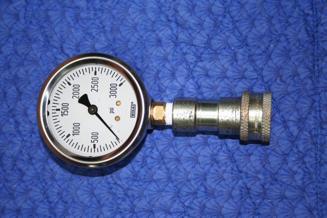

I would recommend a gage setup like these to test and monitor the hyd system.
Coat about $30
With a setup like this, you can tell where you have pressure, and how much.
Install a male QD wherever you want or install it permanently.
