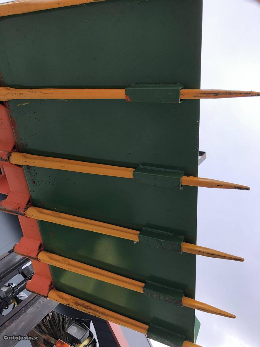

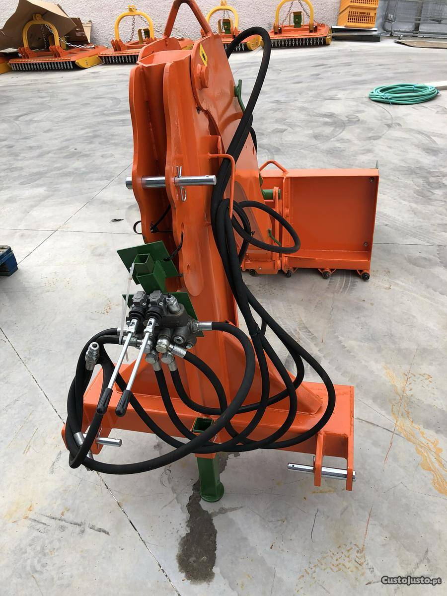

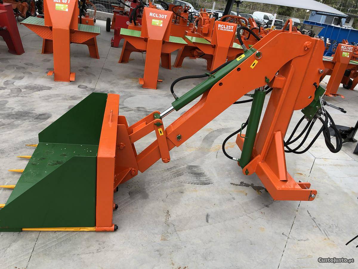

We have these 3 pt loaders over here, that do have some decent lift height and weight. They have a telescopic arm that you can the length by simply pulling a pin.
Max lift/height: Position 1 - 1800 lbs @ 100"
Position 2 - 1600 lbs @ 112"
Position 3 - 1488 lbs @ 124"
You can also get buckets, spikes for manure or bales, grapple, forks and a hook to use it as a crane. Since it's a single arm design vs the two arm on a front loader, the attachments are usually narrower (40" wide) than what you are used to.
The price here, goes from 900€ (1000$) to 1100€ (1220$). The cheaper one won't come with its own valve, so you would need 2 sets of remotes, one for lift and another for curl. The expensive one comes with a 2 element valve.
