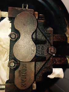

Sperry Rand New Holland S-14H
Any idea where to find information on Kontak valves in the US?
/ Kontak Directional Control Valves
I've been on that site. They are located somewhere in the UK/England and they don't have any information, only parts if you have part numbers.
Problem being, Kontak Hydraulics became Commercial Hydraulics which is now Parker.
The valve I have is on my Brantly LD6 backhoe that is on the Magntrac MT2016 I bought a few months ago.
I'd really like to find a manual, a source for seals, boots for the joysticks, a pressure relief valve, & a plug to replace the power beyond fitting.
I believe it is a Kontak Unit 10 which became Commercial KA10 which is now a Parker KA10.

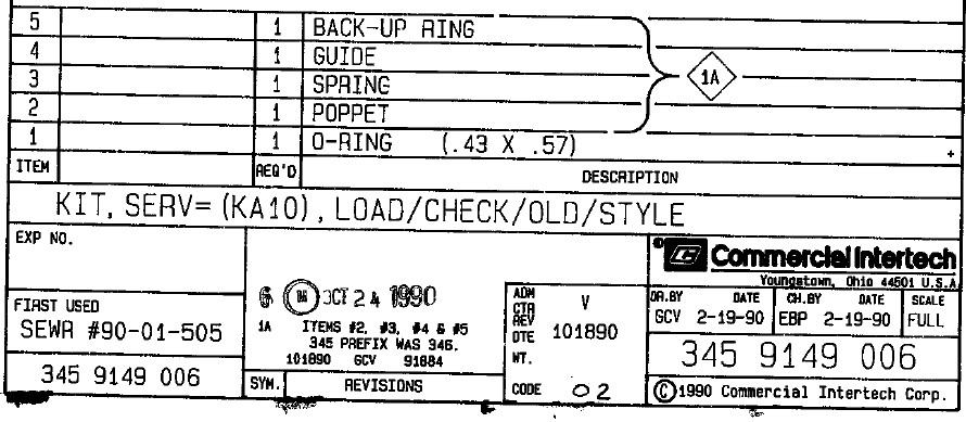

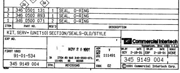

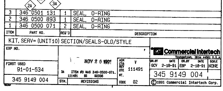

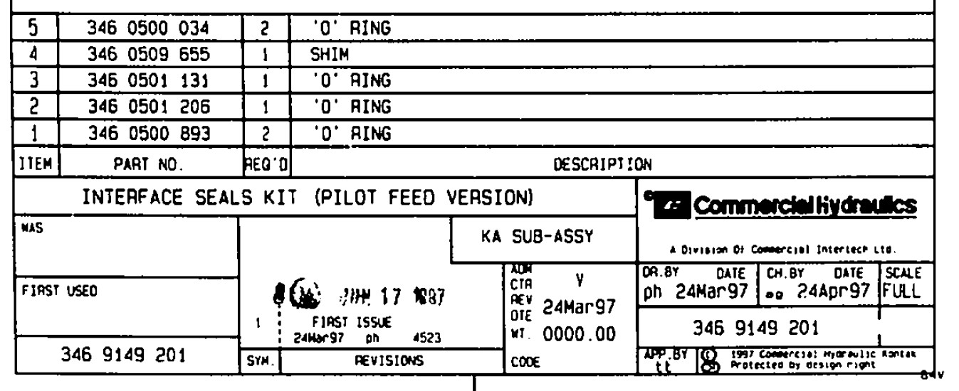

the o-rings between the sections
Parker part = 3460500071 / Dowty Code = 200-019-4490 2 per kit
Parker part = 3460500893 / Dowty Code = 200-020-4490 1 per kit
Parker part = 3460501131 / Dowty Code = 202-518-4490 1 per kit
I don't think I ever found the wiper/seal thats under the cap/around the spool but it's been 4 years :laughing:

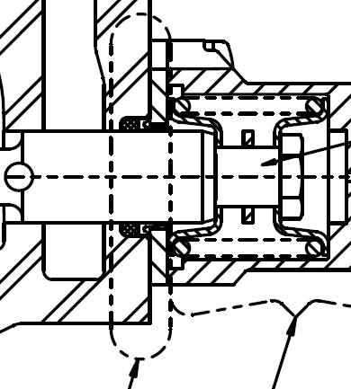

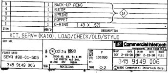

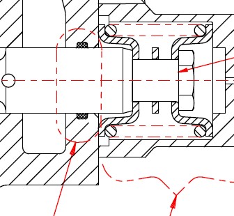

KA10/KA18 Spool sealing
Counterbore to take o-ring/ wiper
Kit No. 3469149103 (2x seals/ 2x wipers)
Unit 10/18 Spool Sealing
Groove to take o-ring
Kit No. 3459149003

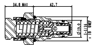

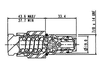

UNIT 10 MRV (1 1/16 UNEF THREAD)
3459001001 = Pressures between 35 and 100 bar
3459002001 = Pressures between 101 and 275 bar

Thanks for all the info. What I'm after is the power beyond fitting for my Kontak valve. My valve has a 3/4 BSP port where the power beyond fitting threads into. Any chance you still have your fitting?
