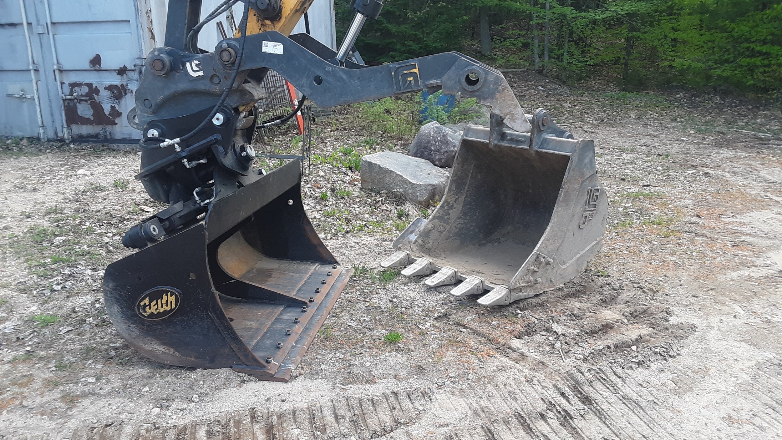

I'm not certain of the vocabulary concerning pins, I just bought a bigger excavator with a pin grabber for bucket change and am under the impression that the pin size refers/matters only for attachments that fit the pin grab. ?
These are 60mm pins but if you don't have the "grab" and are switching buckets the old way by pounding out the 2 pins that go through the stick and curl links.....

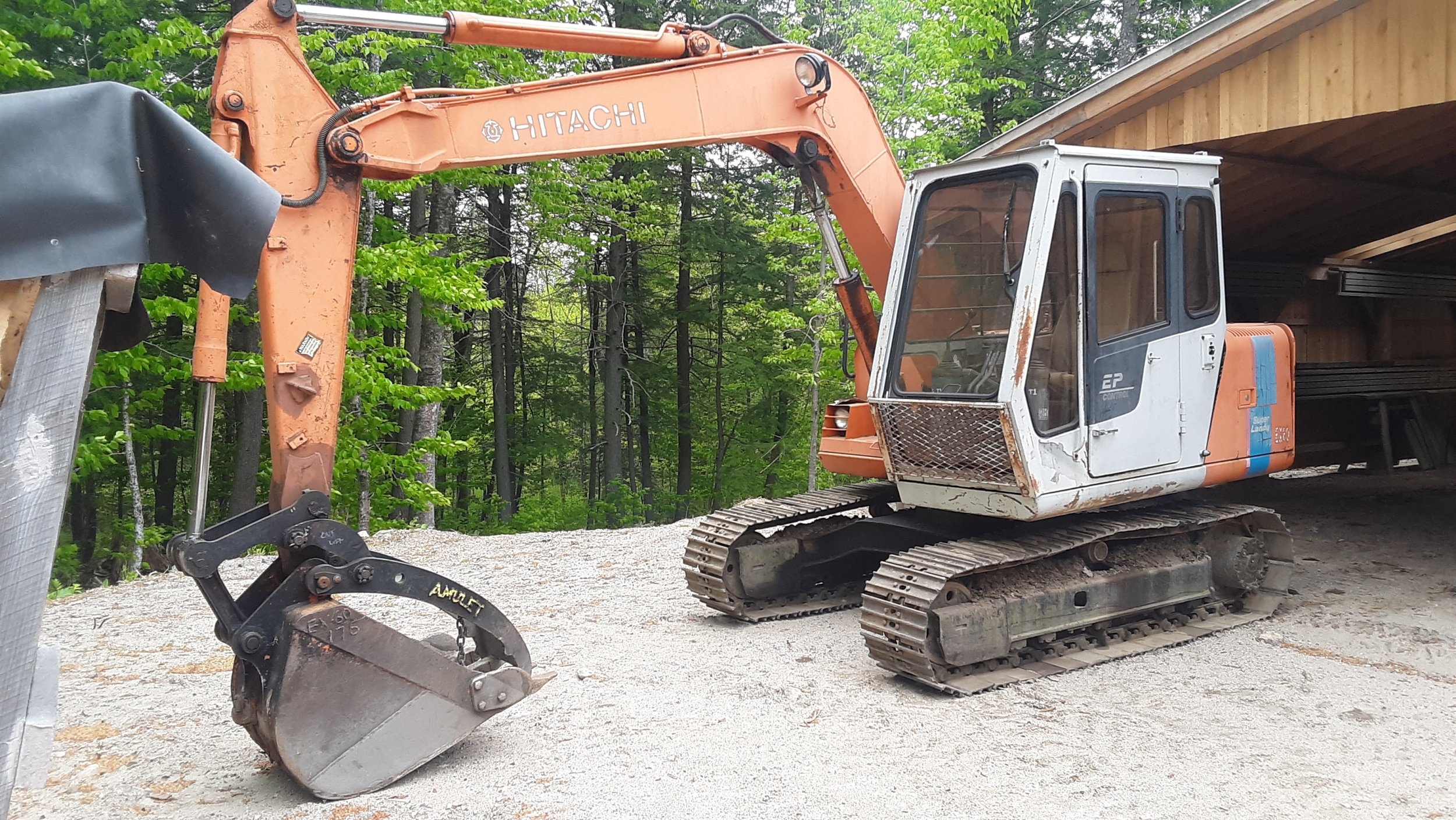

I'm learning too. I'm coming out of an excavator that I've owned for 22+ years and a couple of years older than that.😄
Just sold ole nelly last week.
I'm learning too. I'm coming out of an excavator that I've owned for 22+ years and a couple of years older than that.😄View attachment 802530
we have 2 machines the same size one with pin grabber and one without all the buckets fit both machines.
