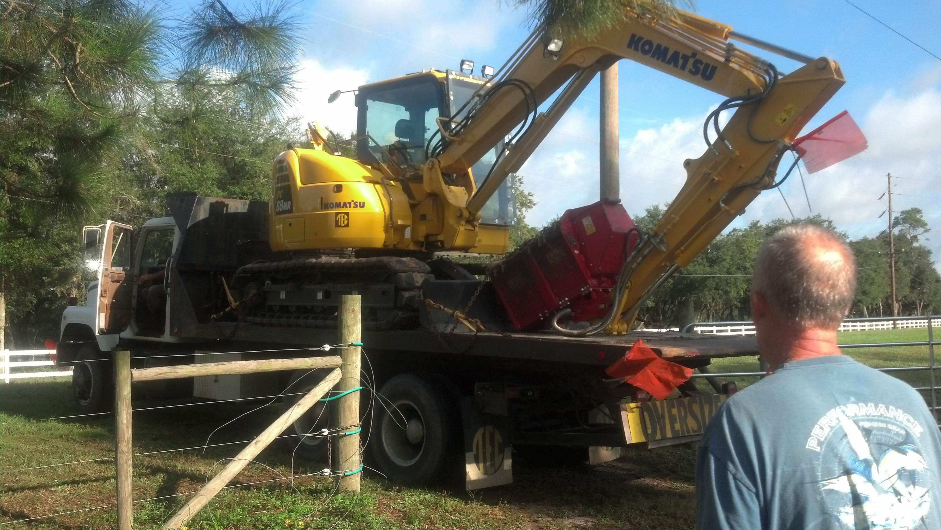

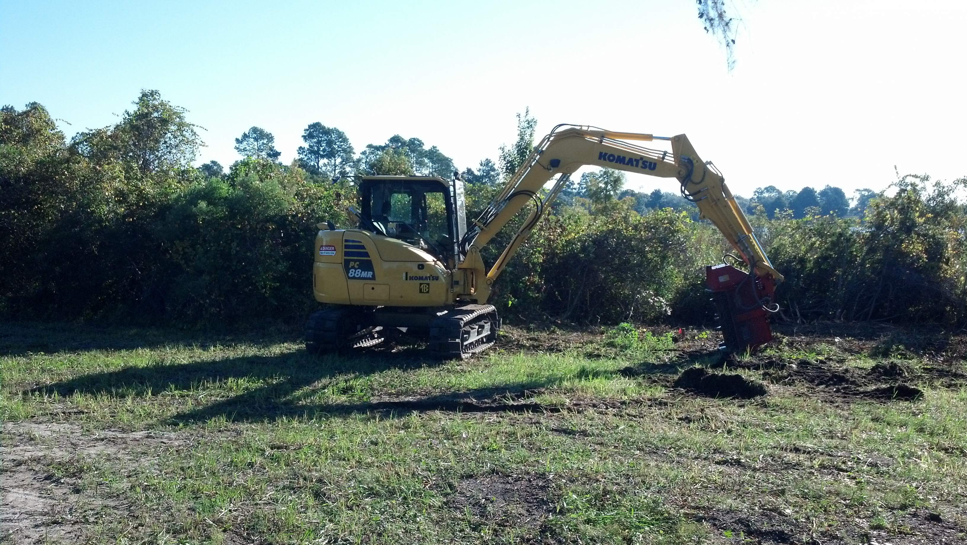

We demo'd a PC88MR-10 Komatsu with a Fecon head last week and it worked great for what we were doing. We still want to try one or two other 8 ton carriers but definitely sticking with planar teeth either way. We run Cimaf teeth on our Cat with great results and the 65 hp 'matsu needed all the help it could get from sharp teeth.

The Fecon had their Samurai teeth and it performed as expected. I'm not used to running planar teeth without some means of depth control so that was interesting. I stalled it out dead several times and I wonder if DCR would have prevented it. When the demo unit came to me, the teeth were pretty well shot. After about 5 hours of cutting, I sharpened them up and it made a noticeable difference but several were still too far gone to be brought back to new condition. Fortunately, we were mostly cutting brush.
