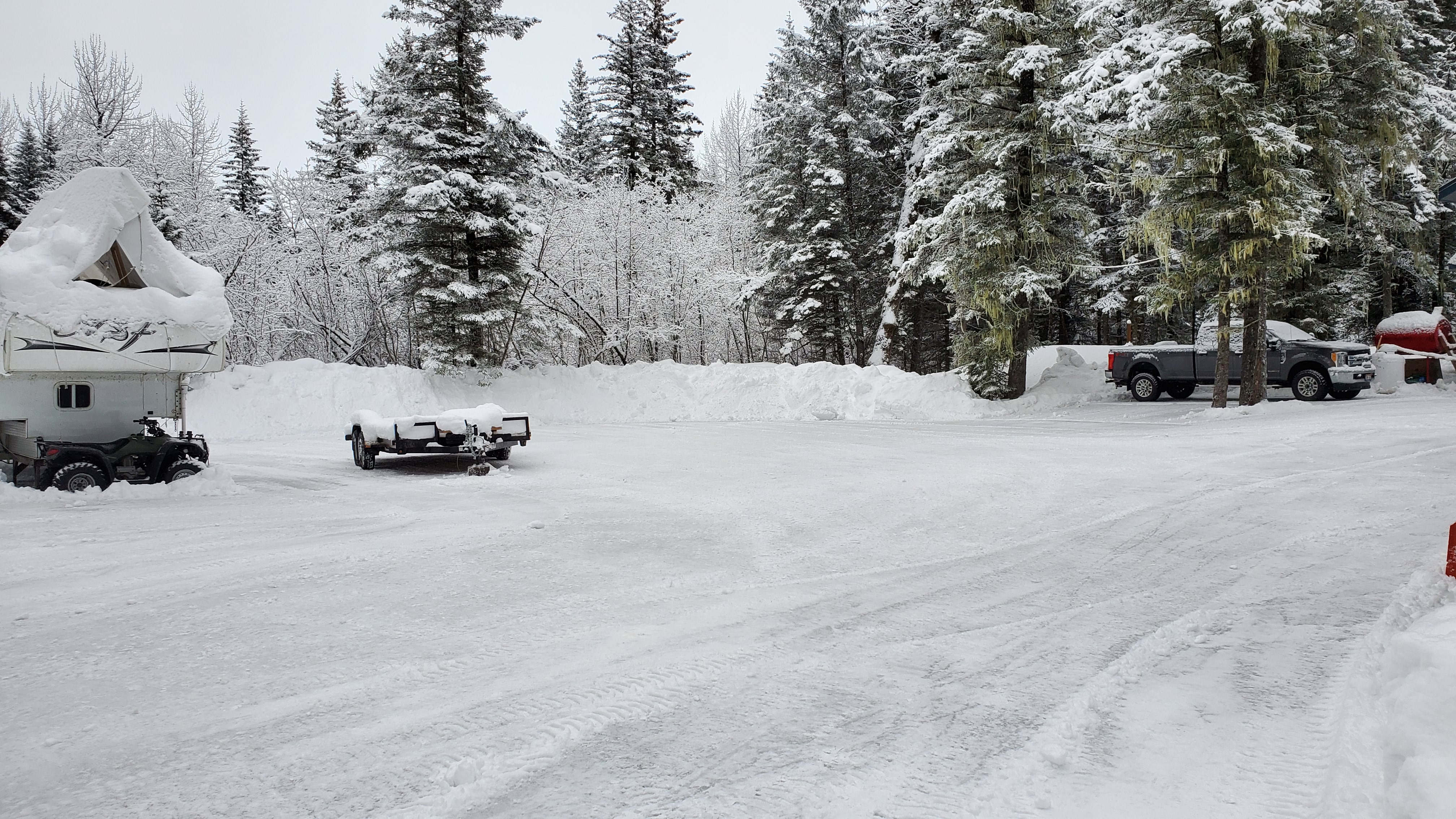

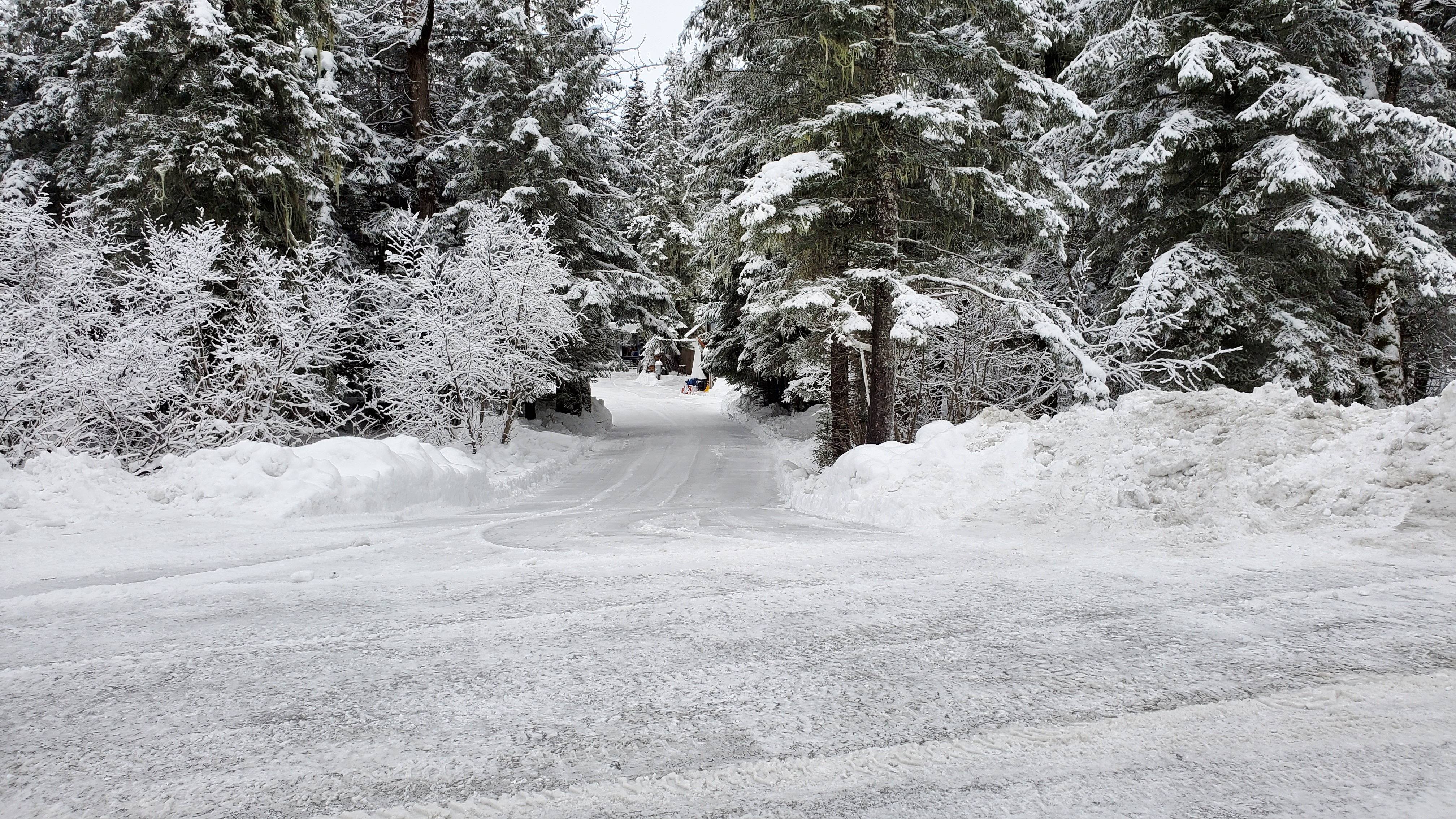

I put the 1" screws around the outside edge of the tire, inside and out. The middle looked iffy. So I bought some 1/2" hex head screws and put them in the middle of the tire tread.
I am running on hard ice, very little road contact out at the street. 10% grade out by the road but flat everywhere else.
The difference between the screws and chains: Screws are way more friendlier on my back and I don't see any less traction. With the R4 industrial tires I can still climb part way up the snow piles and haven't been stuck once. Used the locking rear diff once for traction. The chains were just too rough.
