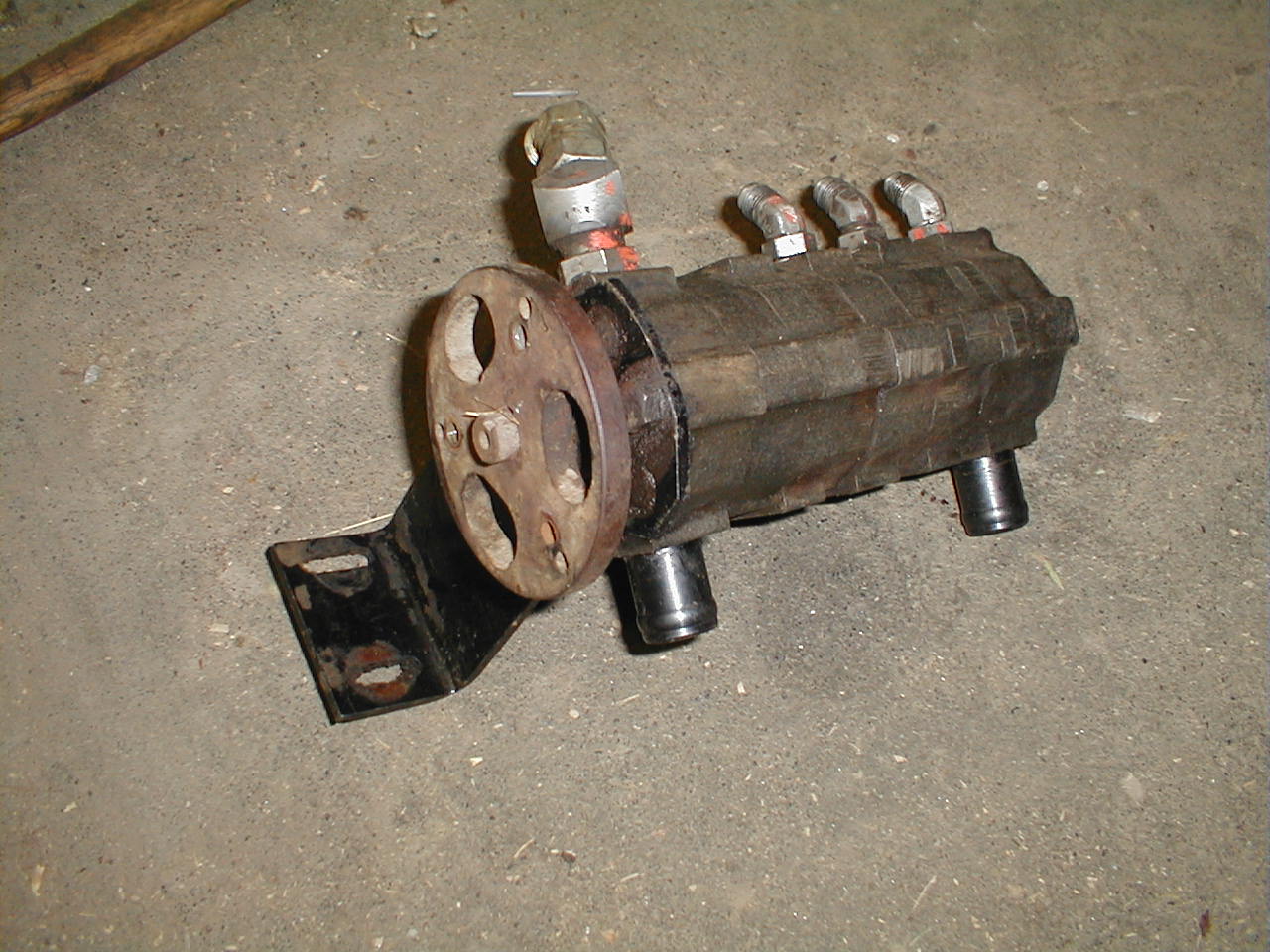

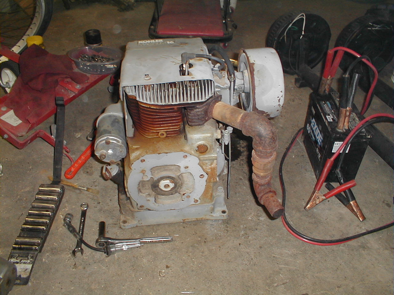

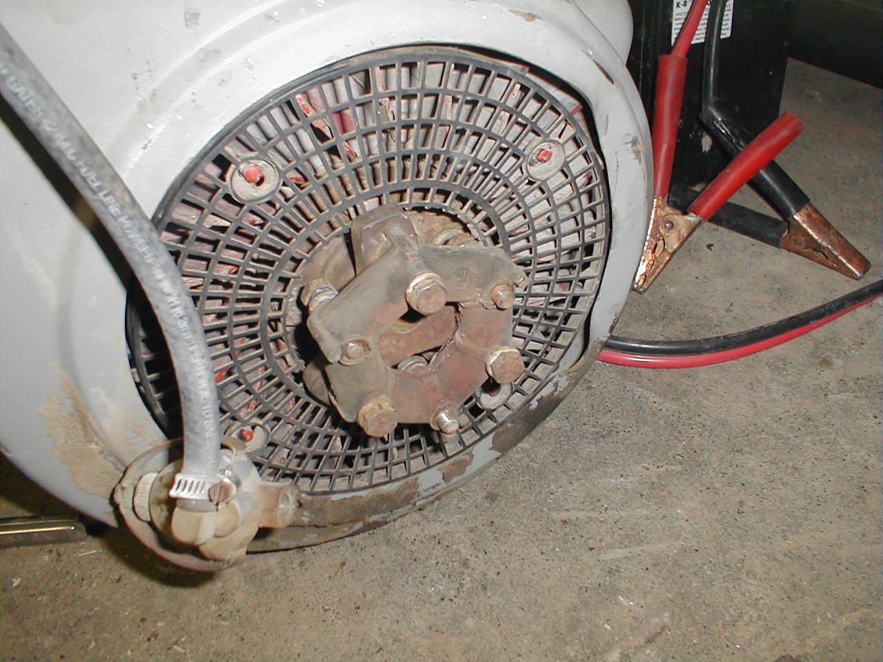

I took a few pictures just so any lurkers could see what I'm talking about.
In the second pic from the left you can see the rubber coupler thing. The last picture on the right shows the hydraulic pump.
Don't mind the random assortment of tools on the floor around the engine. I went out on a limb and posted an ad on Craig's List for anyone who wanted to trade this engine for one with a 1" shaft. I have one taker who has an old school 10 hp Briggs engine. I had to put this engine back together quickly so I could send him pictures of it. I'm still debating whether to make the trade. His is pretty old school, and it doesn't have the electric start.

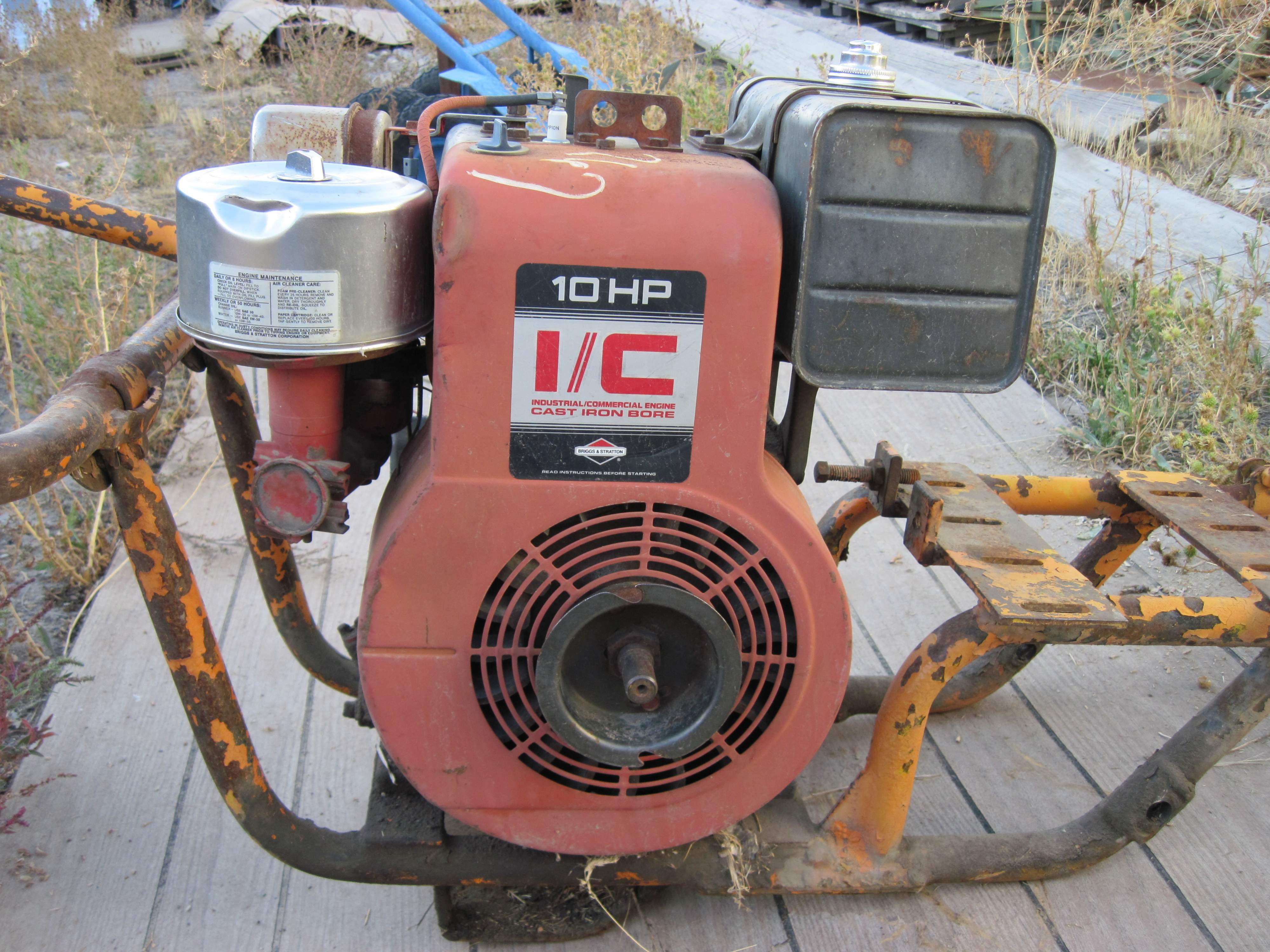

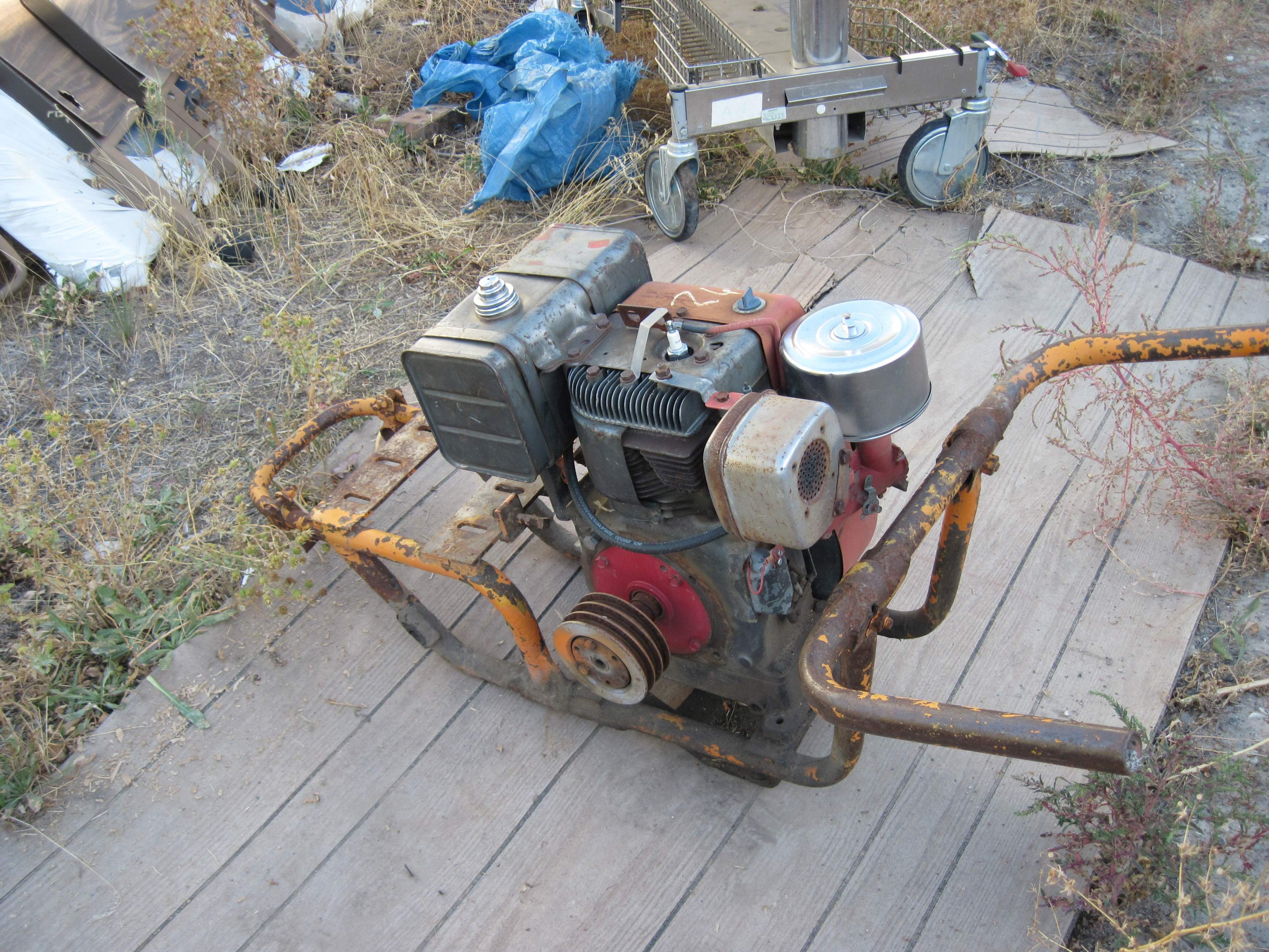

For reference sake I've posted a few pictures of the engine from Craig's list. I'd love to hear anyone's opinions.

There are many applications in the commercial mowers that use both ends of the crankshaft to power the machine. They use one end for the blade PTO and the other to drive the hydro pumps. I suspect that you can solve your problem by removing the current pump coupler and replacing it with an adapter shaft.:thumbsup:
I would think twice about trading a known good 16 hp K series Kohler for a 10 hp B&S.
