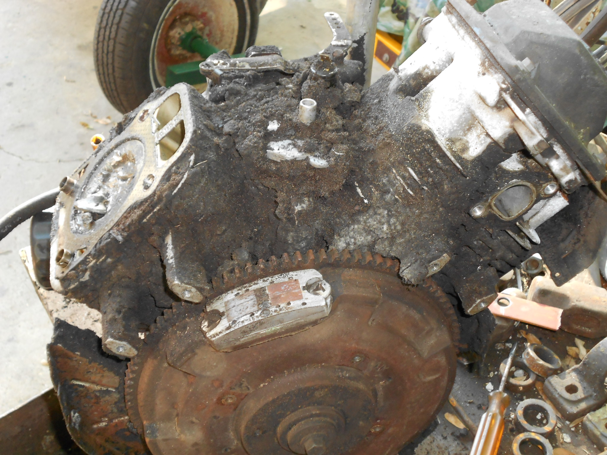

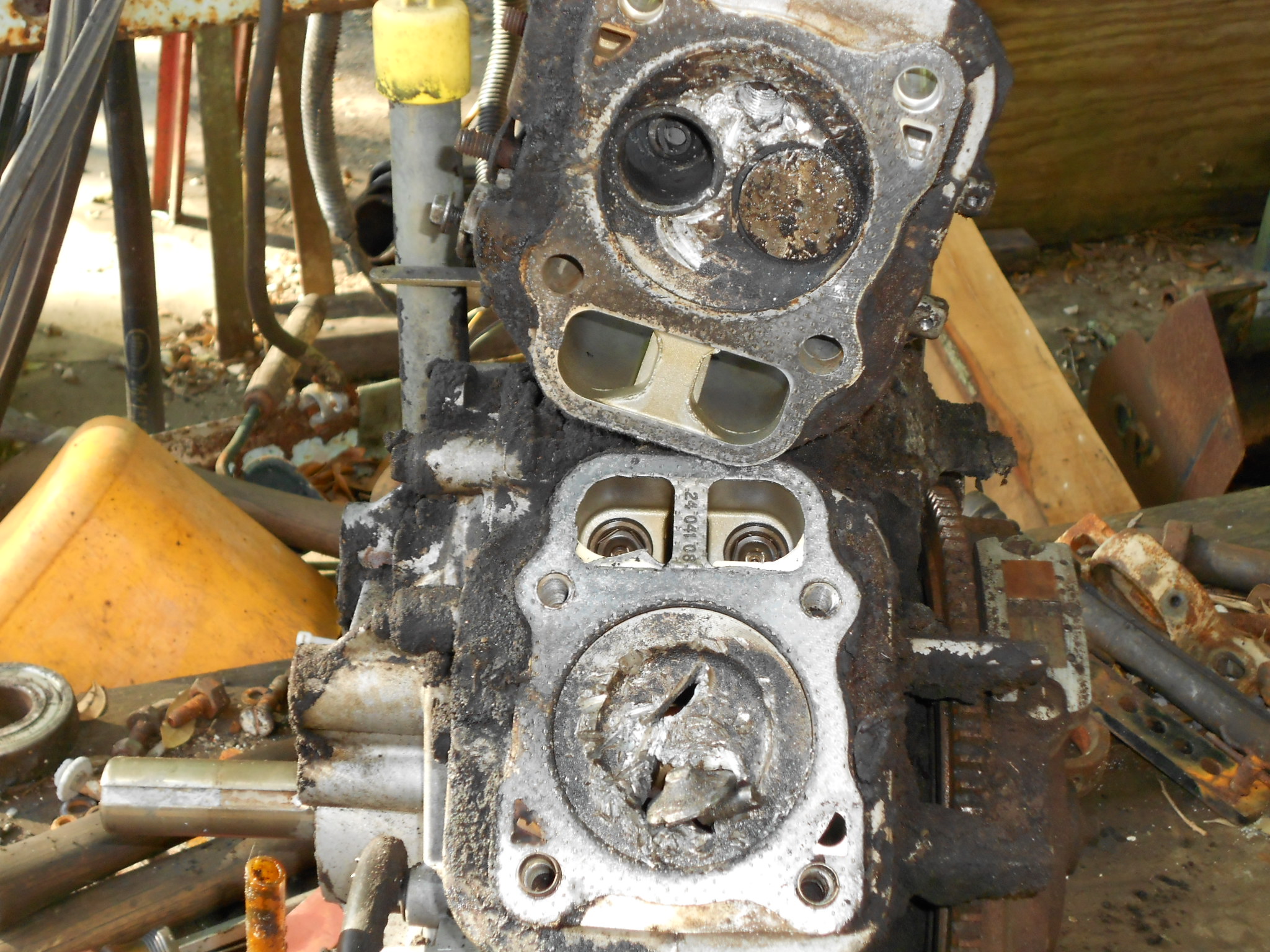

I had a customer give me a 2004 Grasshopper with a blown Kohler 22hp.
It got overheated from cooling fins clogged- see pic
When it overheated the exhaust valve stuck open and you can see the damage!!
It cost me $400. for new head and rebuild kit.
With 3100 hours on this engine the crank was PERFECT! and micrometer reading dead on!
So I ended up with an $8000. mower for $400.00 !!
Maybe yours got overheated??
