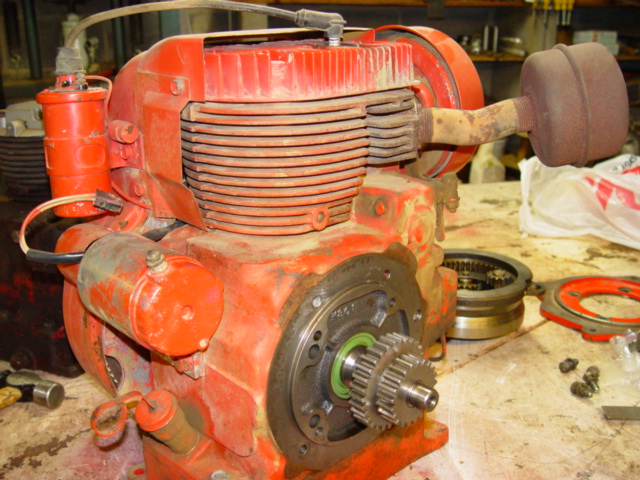

I have a K241 from a C10A Gravely that needs a rebuild. It does NOT have K301 embossed on the block and the block cannot be bored out to make a K301 from it. There just isn't enough metal there.
There is an adapter plate that is bolted to the PTO side of the engine for the Gravely.
Be careful with the gears on the end of the crank. They are pricey.
   / kohler block bolt pattern for Gravely #8
Here is a crank end of a Kohler for Gravely.
Ck out the bolt pattern and more important
Is what I call on the adapter a counter bore
It is really a boss on the engine that fits inside the adapter.
