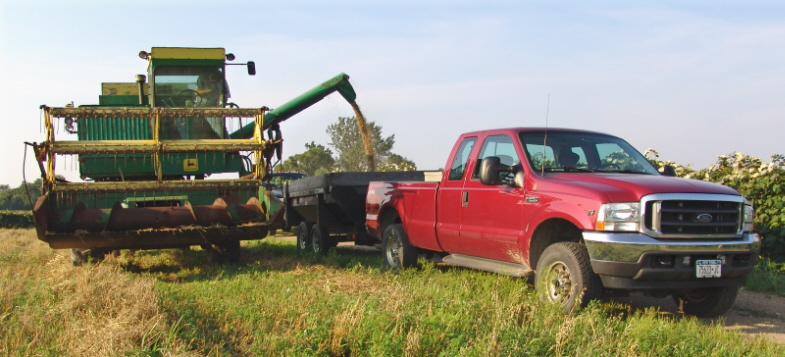

Bill, there are two variations of the 3300, the early ones had the feeder house built into the head, the later model has the feeder house built into the harvester and it is a quick tach system. You just have two bolts to keep the head from popping off.
Also, parts are readily available for the 3300. I have replaced a lot of parts on mine last summer and I never ran into a part not being available. Parts I bought ranged from the fuel system to the engine to kind of obscure screens for the elevators and auger system to help remove small weed seed and dirt. The parts were all available and delivered to my door the next day except for one that came from Indy instead of Syracuse. Edit-I was wrong, I was told I can not get the cab door glass for my model of 3300 from Deere anymore so there was one item I couldn't get.
VA, the 3300 is a good machine but if you can find a 4400 you will be further ahead. I have a 3300 gas machine with cab and the cab gets hot during the summer here in NY. I imagine it will be worse where you are as it doesn't have AC. I have the 10' grain platform and if you are not careful you can easily overload the feeder house and plug the machine. Then you learn the wonderful job of unplugging it manually (new machines have power reverse on the feeder house to remove a plug). The best way to remove the plug on the 3300 is to shut the machine down, get a long handled hook and use it to pull the material out from the feederhouse. It is not fun but so far it is the best way I have found to remove a plug. I have only owned my 3300 for 2 years but I have learned a lot as you will. Hopefully the diesel you want will have more power then the gas version.
The only real easy way to trailer this machine is on a lowboy. And even then they are terrible to back up so you do not want to load unload very often as I still dislike backing this machine up. It backs up faster then it goes forward and you can not see anything behind you so you will want a helper or two to guide you as you back into tight places. If you want to put this on any trailer other then a lowboy you will most likely need to pull the front tires and block the machine off the deck to reduce the height.
I have a 2 row corn head also but have never used it yet. I hooked it up and was going to harvest a small corn field this year but then I got hurt so I never had a chance to try to harvest corn yet. Now it is parked in the barn for the winter. The guys I bought it from never used the grain head as all they did was harvest corn and ended up buying a 4400 to run a slightly bigger corn head. I wish I could tell you how well the 3300 handled the 2 row.
The 3300 is actually quite easy to work on for the most part. I would love to have a newer machine but that is only for more luxury items. I do like my 3300 and the main two things I would change would be to add a ac unit and a diesel.
