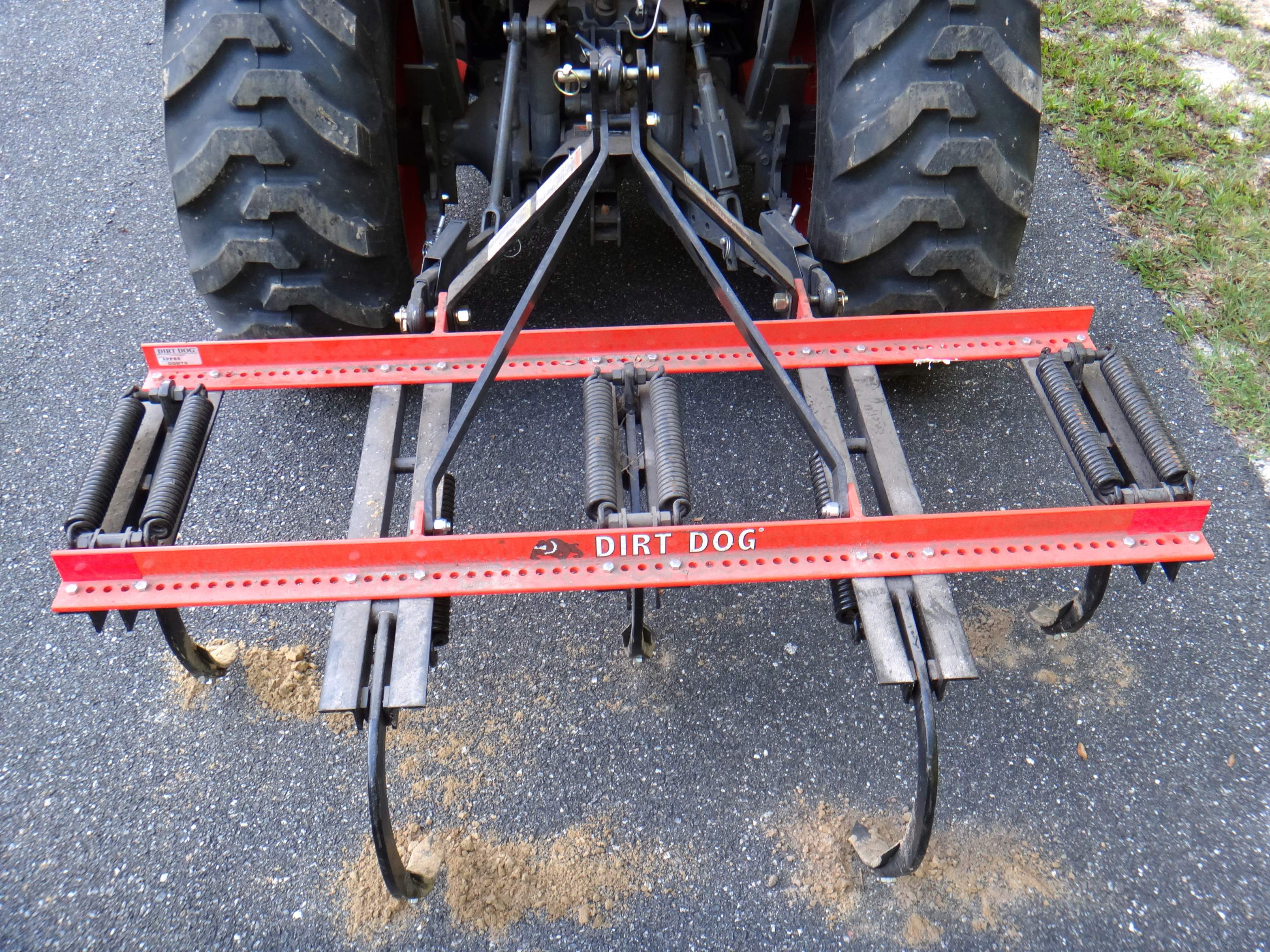

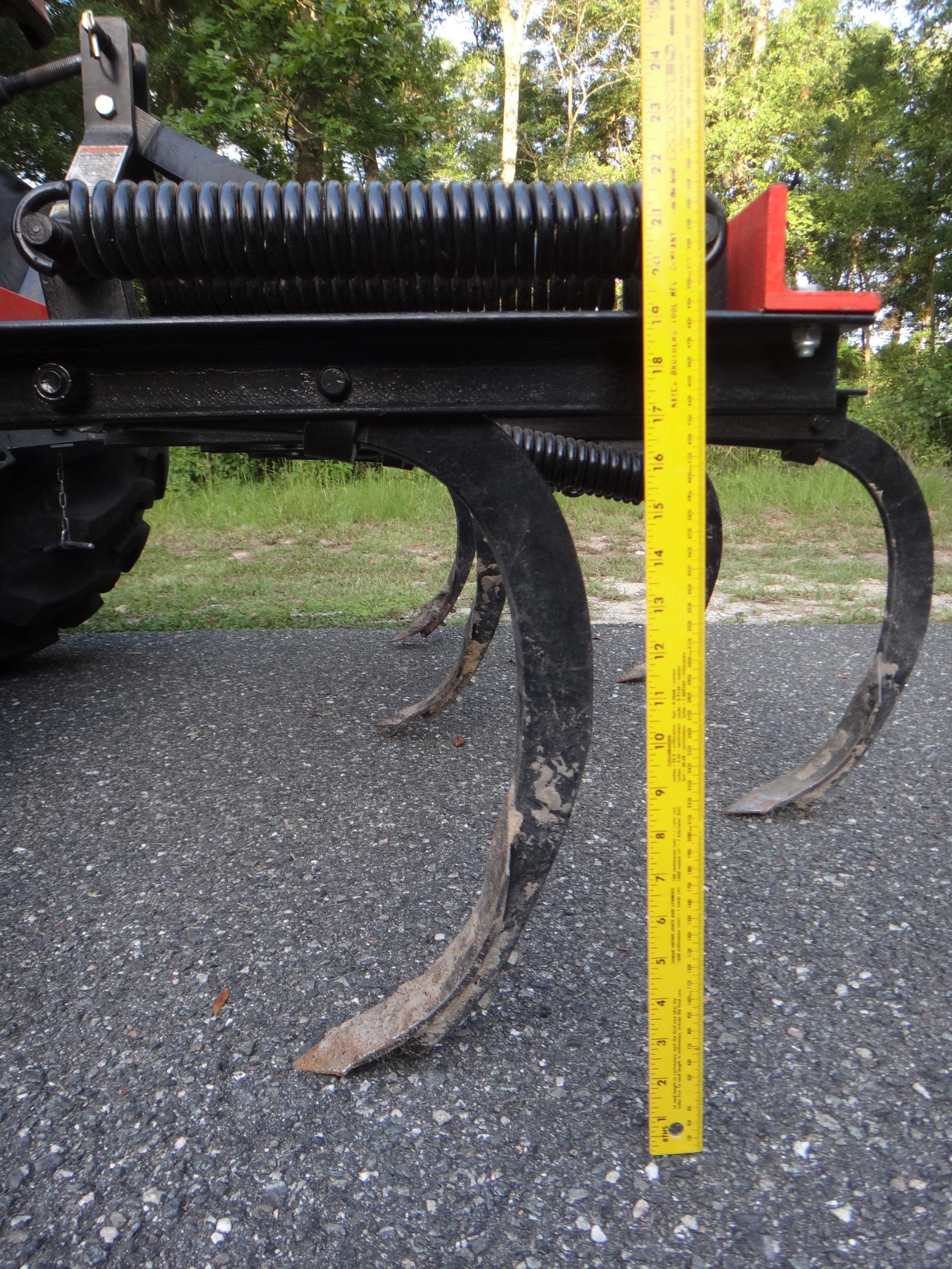

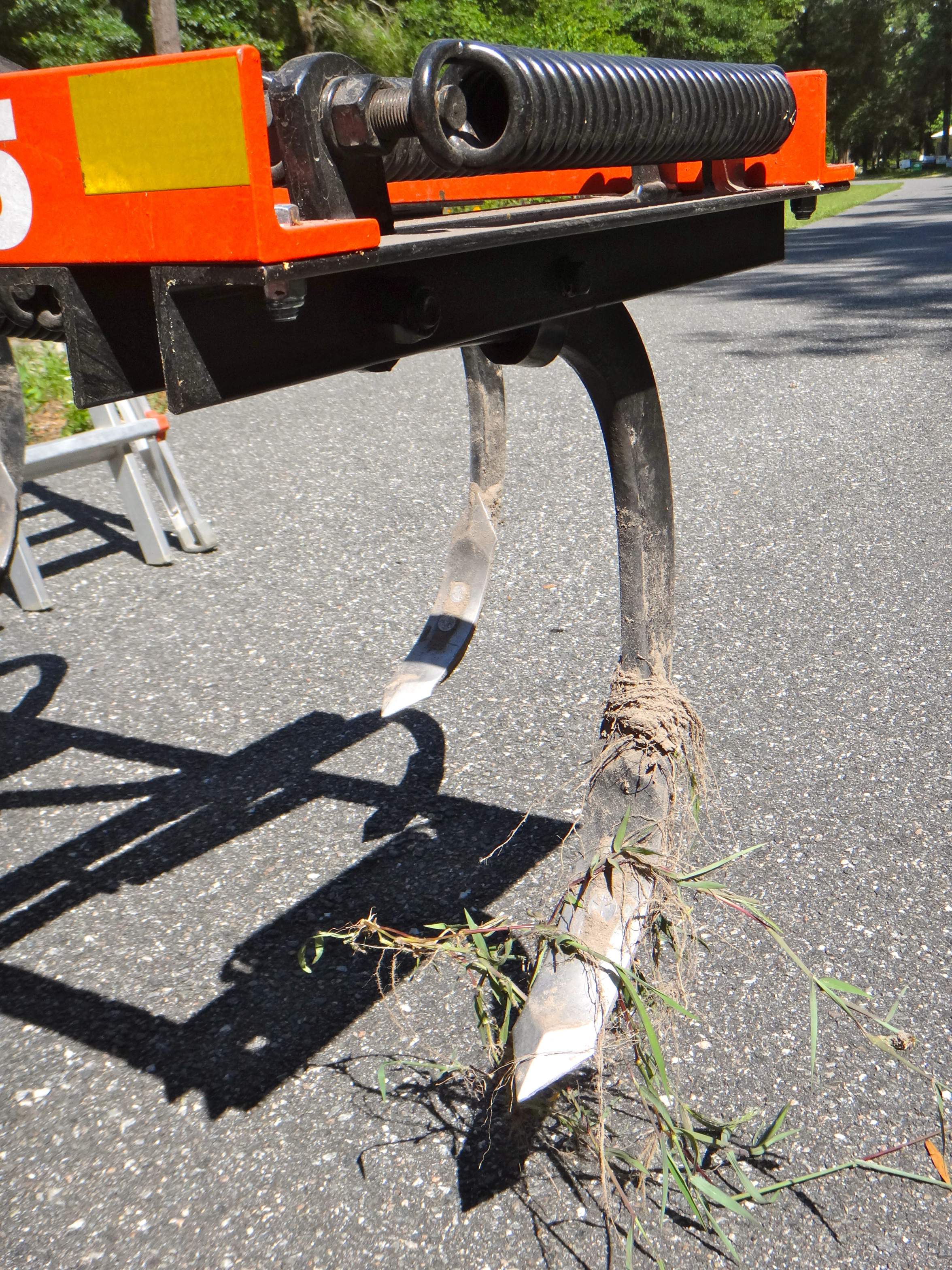

I do not think you can modify a Box Blade so the scarifiers will aerate, because Box Blade shanks are straight. Box Blade shanks are designed to reach to the bottom of road potholes and chip out surrounding road surface. I researched your idea for two years, prior to buying a Field Cultivator.
The implement you need is a spring-protected FIELD CULTIVATOR. Field Cultivators are secondary tillage implements, so ground must have been plowed within 3-4 years of when you want to aerate it. Field Cultivators, then called 'tillers', were among the first implements designed for the Three Point Hitch by its inventor, Harry Ferguson. Field Cultivators have parabolic shanks so the Field Cultivator 'points' cut horizontally through the dirt.
Field Cultivators are made in three shank/Cat 1 to 12 shank/Cat2 models.
Field Cultivators require five tractor horsepower per shank to pull through soil and grass.
The brand I have, pictures below, is 'Dirt Dog'.
TBN ARCHIVE: http://www.tractorbynet.com/forums/attachments/339095-dirt-dog-all-purpose-plow.html?highlight=
Craig's List LINK: CULTIVATOR~~~nine shank
How much pasture do you have?
