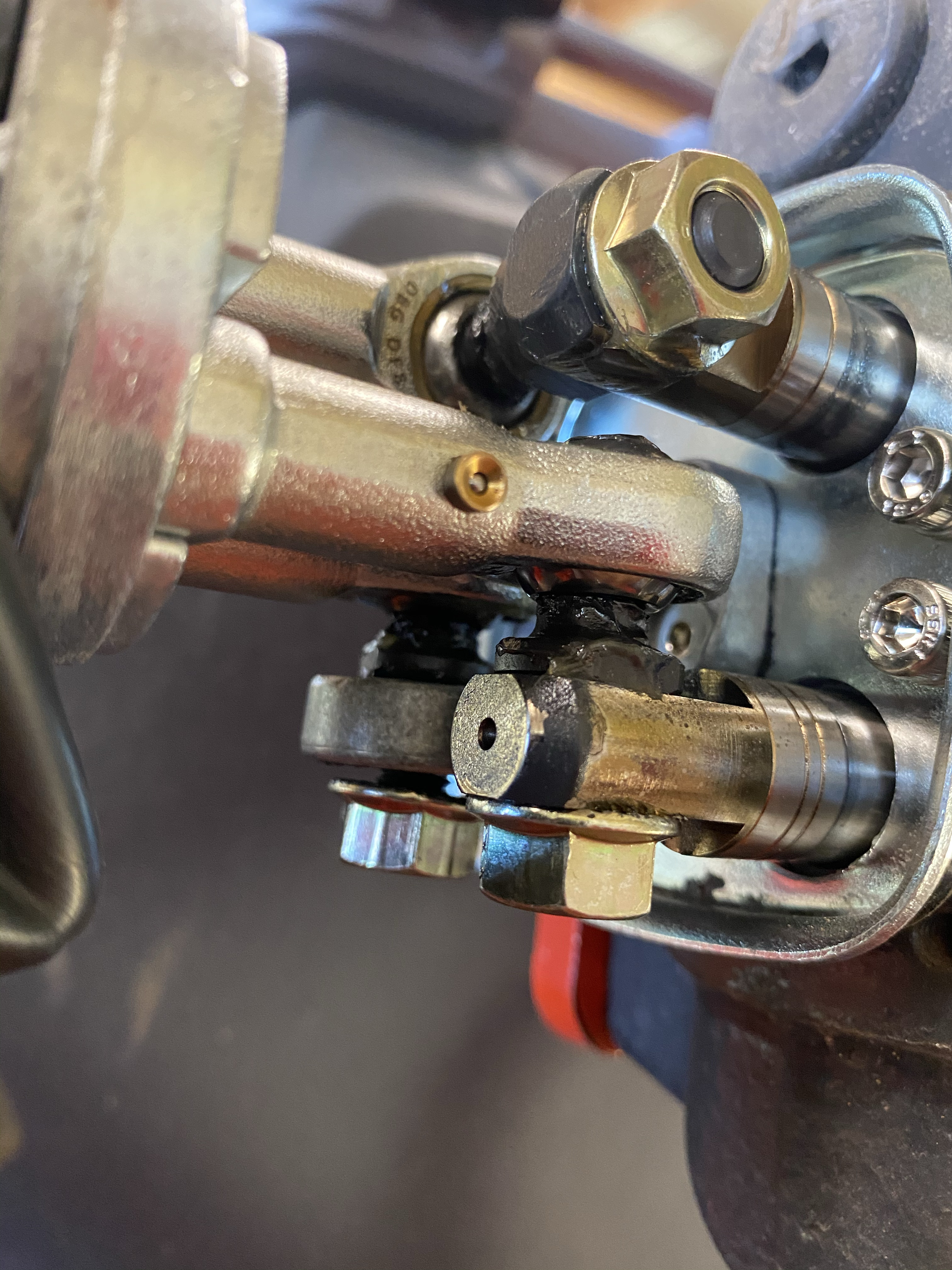

I have a KL5520 on a dk4510. The joystick has became loose. Still operable but wobbles. Like a spring is broke or something. My 2 year old son likes to “work” on it while we’re parked. Anyway back to the main story. Was curious as to where to find parts. I’ve looked at Michigan iron and equip. But cannot find a 5520 loader. They have the 5510 and only sell the complete joystick valve control assembly. Well at over 2 grand I can’t justify it. Anyone know where I can find a parts list for this specific loader?

Well After digging into it I’ve got it fixed. Prolly shoulda dug in it before asking a question. One of the nuts backed off some allowing the post to wobble. If that makes sense. I don’t know what the correct term for the post is. Ball post maybe? Here’s a picture if anyone is interested. I was thinking I had a complete different setup than I have. Glad I don’t have that Y looking plate like some of the others. IMG_0409.jpg
