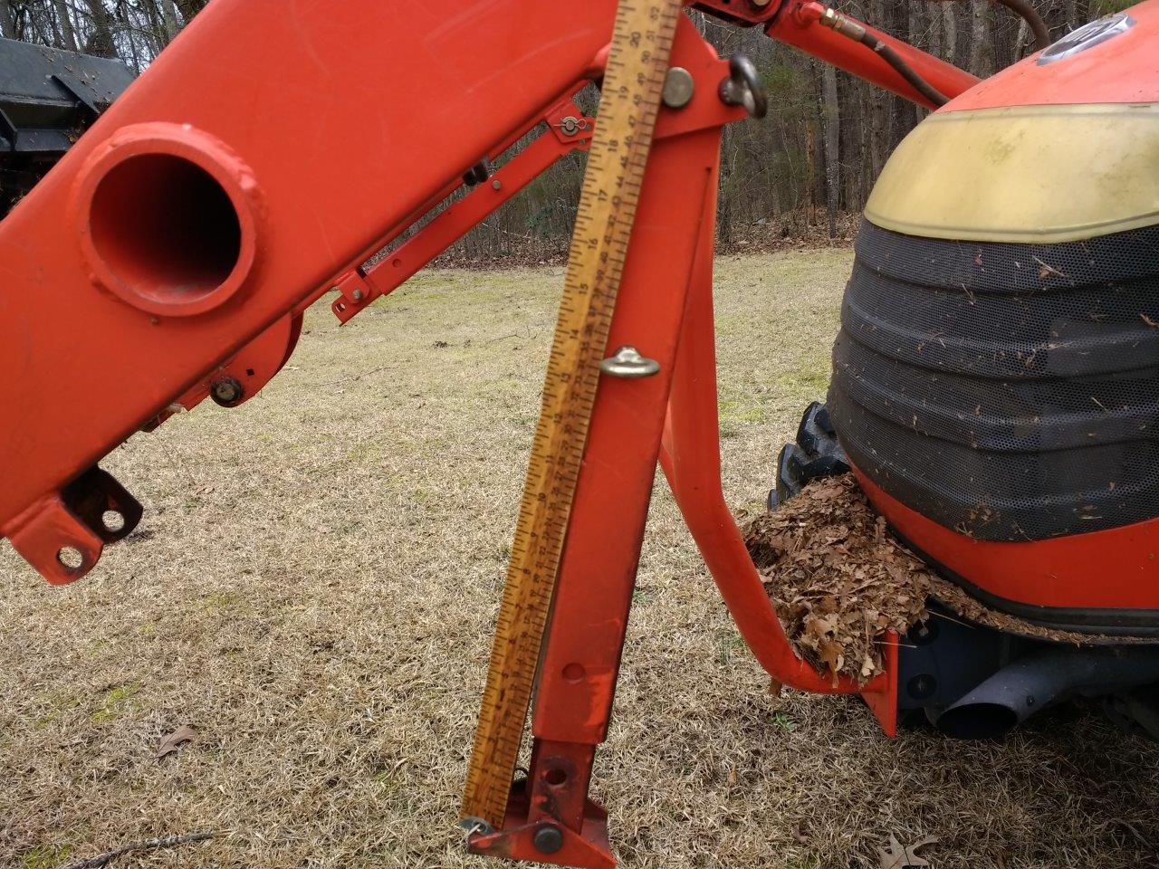

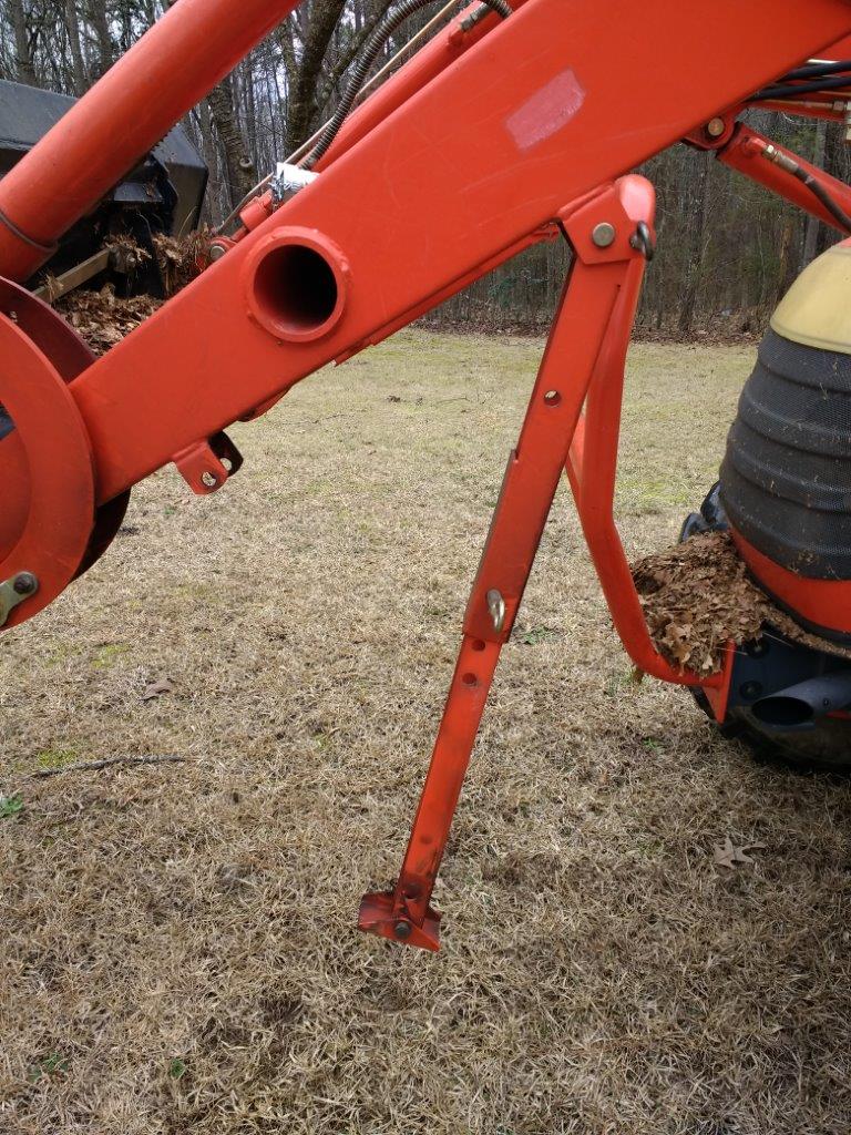

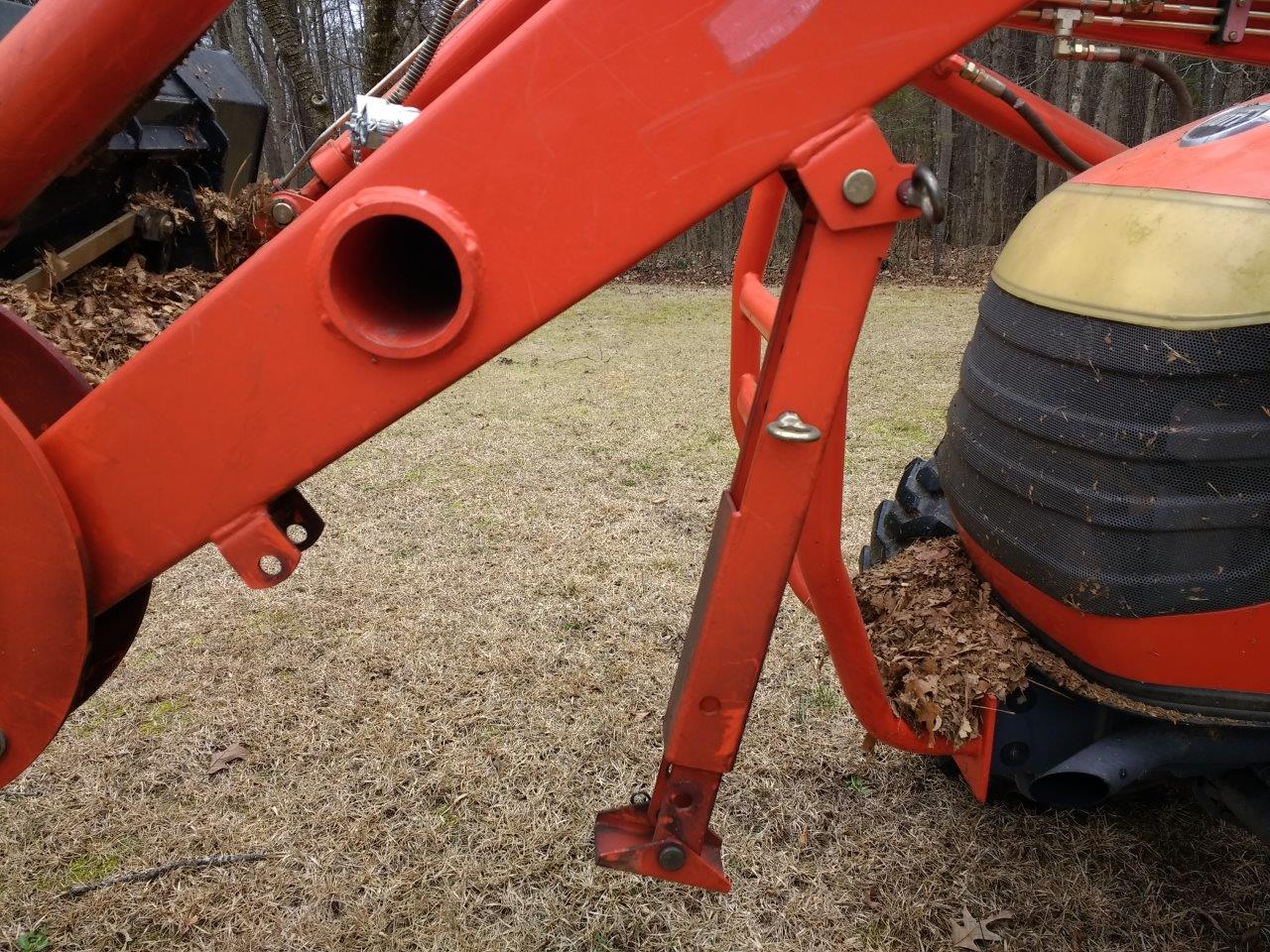

Hi all! I've got a DK45SC with a KL451 loader, but the "built-in" stands for the loader were removed at some point. I'd like to fabricate new stands, but I don't know the size of the OEM stands. It would be much appreciated if someone would take a tape measure to theirs and let me know the measurements. Bonus karma for pictures. Thanks!

This first photo shows the strut stored. The topmost and bottom-most (foot) pivots are not removed; the pins are secured by cotter pins over washers on the backside. The other two pins are removable, secured only by a captive, spring-loaded ball bearing. The actual strut telescopes.
The next two shots show the strut in the down position at minimum extension. Note how one of the bottom removable pin is relocated to the top to hold the strut at the proper angle. Sorry about the bad focus (focused on background?) but the yardstick should be readable

Thes last two shots show the strut at full extension. Note that there are additional holes to reduce the extension by a few inches.
And again in full resolution with a yardstick:

Many thanks!
