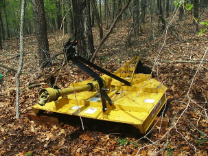

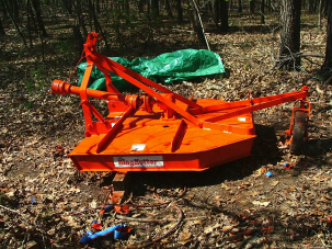

Apr 30, 2007 / KK to KIOTI #1 M mrutkaus Platinum Member Joined Feb 1, 2004 Messages 990 Location 15 mi. N. of Winchester VA Tractor Kioti CK30HST, Kubota BX-1500, Here's is how I changed KK to KIOTI! TS Gloss Orange with Hardener. Mike Attachments bush hog yellow.jpg 107.8 KB · Views: 363 bush hog orange.jpg 108.6 KB · Views: 365

May 1, 2007 / KK to KIOTI Thread Starter #5 OP M mrutkaus Platinum Member Joined Feb 1, 2004 Messages 990 Location 15 mi. N. of Winchester VA Tractor Kioti CK30HST, Kubota BX-1500, It needed the paint job, only a couple years old but stored outside under the green tarp, and rust was starting. I think I'll do the underneath next! Mike

May 1, 2007 / KK to KIOTI #6 R rvaitor Platinum Member Joined Sep 6, 2004 Messages 502 Location Nashville, TN / Hickory, NC Tractor Kioti DK55C mrutkaus said: Here's is how I changed KK to KIOTI! TS Gloss Orange with Hardener. Mike Click to expand... What kind of paint and hardner? Tractor Supply? Also how did you prep it? I'm getting ready to paint a mower deck as well. Thanks

May 4, 2007 / KK to KIOTI Thread Starter #7 OP M mrutkaus Platinum Member Joined Feb 1, 2004 Messages 990 Location 15 mi. N. of Winchester VA Tractor Kioti CK30HST, Kubota BX-1500, Yep, Tractor Supply Gloss Orange with the cyanide hardener they sell. I power washed it, wire brushed rust spots, pre primed with spray gray primer, let that dry, they sprayed the orange... Mike
