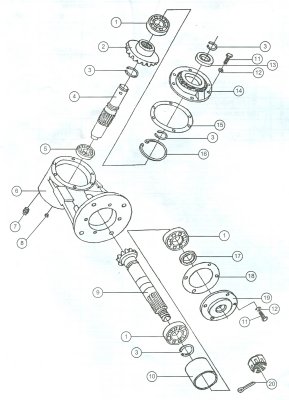

Is it possible to modify the gearbox such that I can reverse the direction of the output pulley? I had the gearbox apart yesterday eve but dont recall if the gear on the input shaft could be flipped around such that the smaller gear / main drive pulley could be reversed in direction. If that is possible then my problem is solved.

Trey if your gearbox looks like mine it's pretty straightforward. Not sure how or if you could reverse the output rotation. (see diagram)
