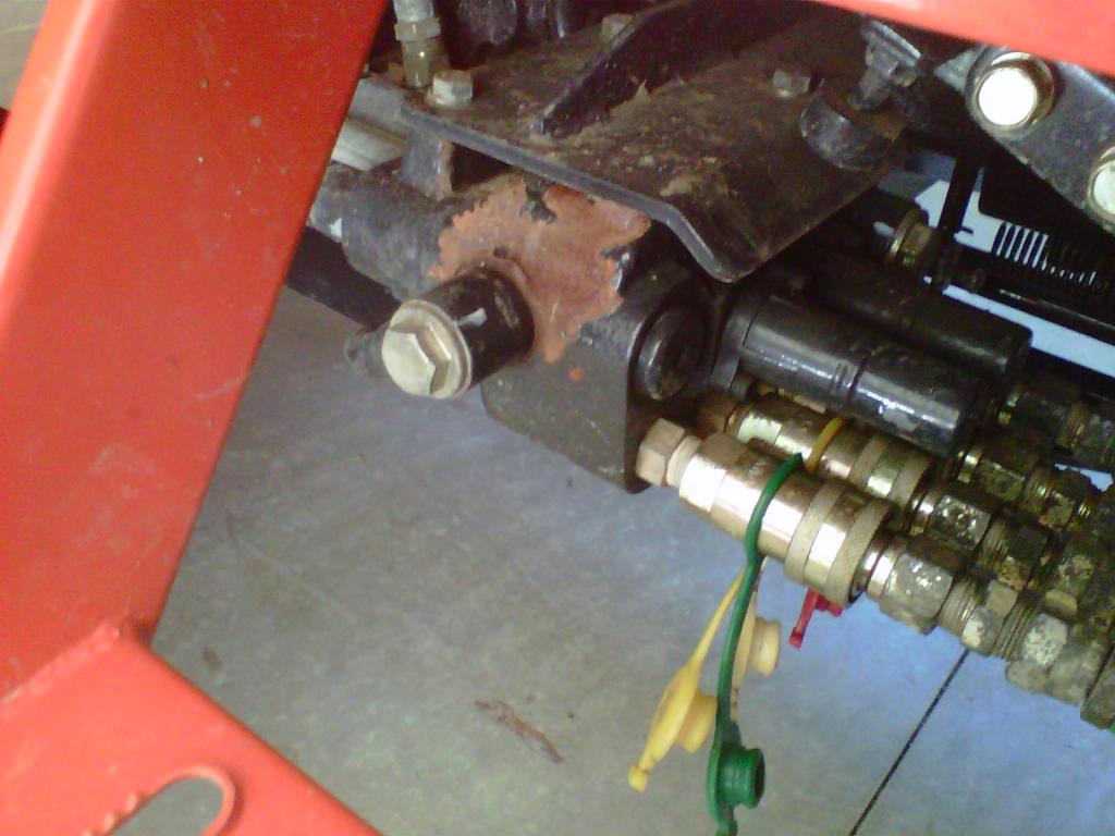

Here's my biggest need for "black paint". It started out the size of a nickel and it has grown to what you see now. Probably will take a wire brush...also have one for a drill I can use, clean it up and get it primed and then painted. While this doesn't affect its performance, it is annoying to watch the paint keep coming off.:mad:

Yep, I hear you on the need to get to it before it gets worse. If you could sandblast the area that might be a good start to get it primed while we figure out what color the black is.:cool:

The Kioti dealers don't have the correct black paint available in spray cans???
BTW: look like New Holland/Case black to me, srs.
Before priming use a good wax/grease/silicone remover. Those cast parts especially really soak up oils. I buy it in a spray can-spray on wipe off with a clean rag. It dries in 2-3 minutes. Autozone has it in spray can form or your local Napa store has it as well.
I would never sandblast. A stiff wire brush at the end of a drill will take off that minor rust without any problem.

I just bought some NH black for 7.99 a can from my dealer. The NH paint has way thicker pigments and quality than off the shelf Krylon/Rustoleum and I expect the Kioti paint will be the same way.
I would never sandblast that tractor because that sand goes everywhere and will cause contamination problems with other parts on the tractor. I would not want to risk it getting into the engine/transmission or other moving parts such as the pto seals let alone the fuel tank. Sand will be coming out of every orifice on that tractor for years to come.
A needle scaple on a drill will take that rust/old paint off quicker than you masking/blanketing off the tractor getting ready to sandblast.
