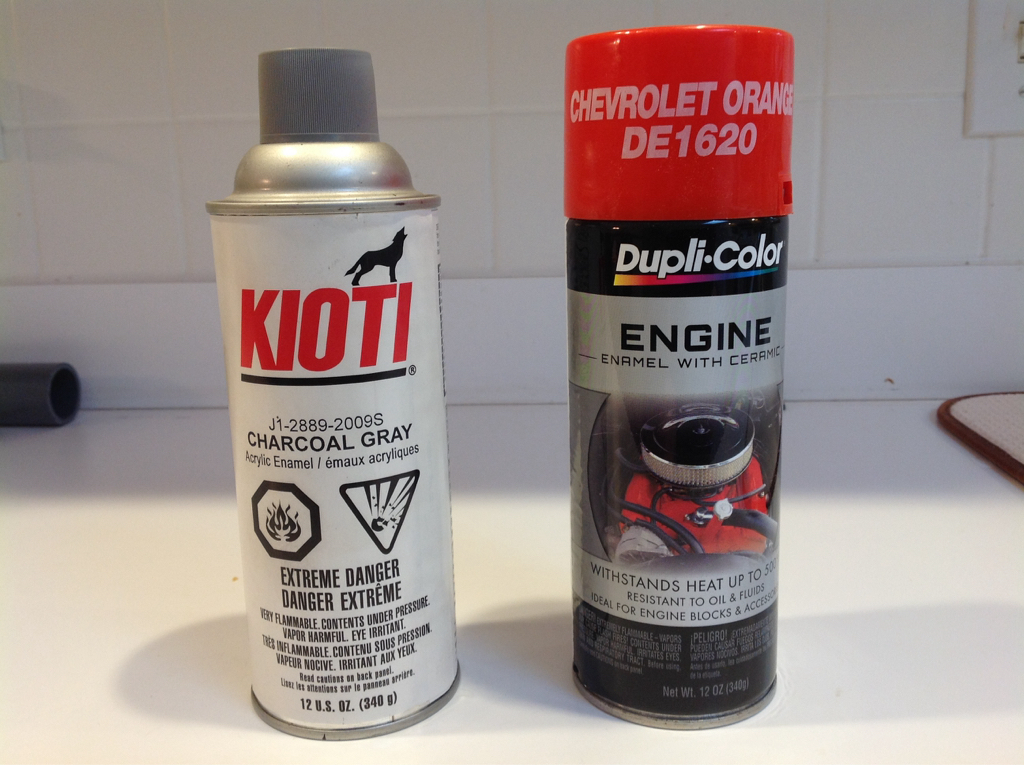

my DK45 se hst is getting older now, anyone here try to repaint their tractors? What do you do with the sun bleached plastic? I'd like to keep this thing around for awhile longer, but it is starting to rust all over, seat is cracking, seatbelt broke, plastic compartment covers are broke, etc. ONly big issues are that the front gears have gone out twice.
I've been grinding down an attachment every year and repainting, just have the tractor and bucket left to do. I can wait another year for the PHD, not much there to repaint.
although some might see this as sacrilege, I don't care what color I paint the tractor, so long as it isn't piss yellow. I won't pay additional money for "kioti" paint.

Chevy engine red/orange is a good match to Kioti orange on my 2006 DH45s. It sounds like you need to park your machine in the shade. Sunlight is what eats plastic parts and dulls the paint. Polysulfide paints (like POR-15) are very tough and seal rust but won't survive UV so a top coat is required. If you use polysulfide, wear gloves and only use disposable brushes and drop cloths. I can't comment on the gears.
   / kioti upkeep #3
Rustoleum Lobster Red is very very close. Man you need to get that thing out of the sun. Mine is several years old and looks brand new. But kept indoors all but about 5 months.

For fading plastic it's hard to beat 303 aerospace protectant.

Mine is a 2013 model and I use a large car cover. This has worked pretty well and some folks comment it looks like new- which it does not to me. The point is the car cover does a good job of keeping the sun off of it. All of the plastic is in excellent condition and paint fade is minimal if any.

Would aggre on the Philadelphia Pittsburgh thing.I live in north central pa Sullivan county. Only one traffic light in the whole county. My CK30 HST is a 2005 that I bought new. Always kept in the barn and it still looks like new. It has 1200 hours on it. I always waxed it two times a year. I used chevy orange engine paint to touch up and it was pretty close. Hope this helps.

I noticed last night on my ROPS a very small spot (1/8" or less) that had no paint, appears to be the start of rust. Guessing it was dinged in assembly / transport / whatever. What color / type of paint is good for the ROPS?
Thanks!!
