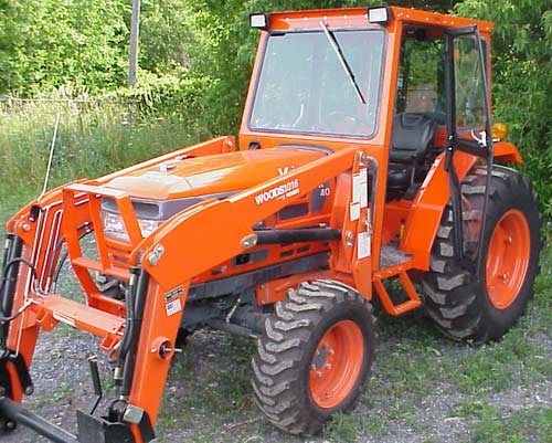

I don't think there is a factory cab option for the DK35 or DK40 but Sims Cab Depot - Manufacturers of cabs, enclosures, sunshades and accessories makes a cab for each of those tractors. I have one of their cabs on my CK20 HST and have had no problems or complaints so far (180 hrs and over 1 yr later). I have glass windows with windshield wipers front and back, vinyl side that velcros on and another with a metal frame that latches and opens and closes like a real door. It heats up fast with a little heater and it gives me an added sense of security while using the tractor.
See my link below for pictures of mine...

I just received an e-mail from Lauren Cab in Canada. They have developed a great looking cab for the CK25/30 line. It very much looks like our factory cab on the DK45 & 55 models. I'm not sure of pricing( a lot of french spoken there)but I have e-mailed the sales dept for some info.
This is a pretty impressive looking cab with the glass doors and openning windows and nice headliner and options.
